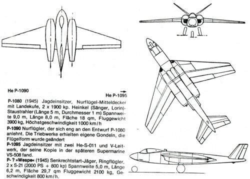

The last Heinkel project was the P 1080, and it was unfinished. There are no wartime Heinkel project numbers higher than P 1080. The primary source information from Penzing makes that clear.
Arjen
It's turtles all the way down
Nov 6, 2010
2,374
105
We have discussed this once, there are no such Heinkel projects

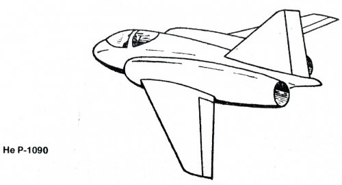

What ?,who said that,in the book- Ernst Heinkel: Pionier der Schnellflugzeuge, eine Biographie (Die deutsche Luftfahrt),
you will find this.
Hasan, I have that book. I can not find any mention of P.1090 or P.1095 in it. On which page did you find your description of P.1090 and P.1095? The highest P.-number mentioned in the book is P.1080.

The Heinkel project list prepared atHeinkel projects Penzing.jpg Penzing. Plenty of room for additional projects beyond P 1080... but there aren't any.
you will find this.
Hasan'ssource is the "Heinkel-Flugzeuge" at "Luftfahrtverlag Axel Zuerl" :

That 'P 1095' looks remarkably like the P 1079.

Oh sorry,
I have just a pages from both books,that made me confuse,and if we don't have a drawings to those Projects,
it doesn't mean they were not existed,for example,the UK Royal Air Force Museum mentioned that there was
a Project to Heinkel called P.1130,that indicated the series of Heinkel reached after the WWII to this number ?.

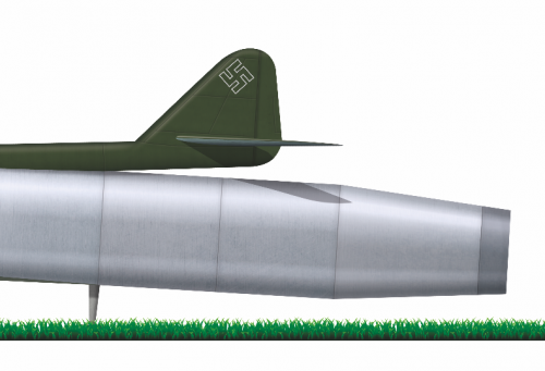

One more sample.
Anyone's tip, what's that?
D.F.S Jabo mit Lorinantrieb , fighter OR bomber (1000 kg bomb)
The bomber was put to altitude as a Mistel .
2 versions , straight or sweepback wings .
Hats off to Le Fana, it's a quality publication. It would be interesting to see when they did it and what they did with it.

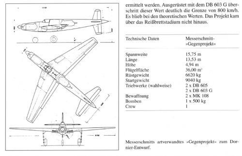

Thank you my dear Dan,
- for Arado SO-Geret,it was mentioned by Wikipedia
- for Messerschmitt Me.335,it was mentioned in the book,Vom Original zum Modell : Dornier Do 335
- something new for Zeppelin
Die Abteilung Flugzeugbau der Luftschiffbau Zeppelin GMBH 1942 bis 1945
- also from the book; X-planes - German Luftwaffe Prototypes 1930-1945,any thing from those ?.

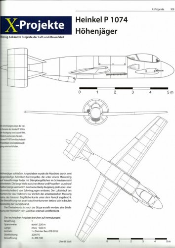

I have not yet seen any description or document of the Heinkel P 1074. Does anyone have more information?
newsdeskdan
CLEARANCE: Top Secret
Jun 11, 2014
807
139
No. And the 'X-Projekte' design looks speculative to me.

- for Messerschmitt Me.335: I don't have that book. What context is it mentioned in?

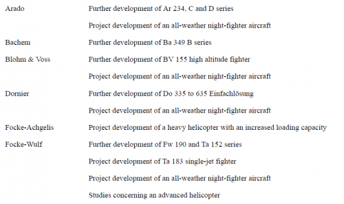

- Griehl list. I know you regularly produce this list as evidence of projects that are 'beyond secret' but really Griehl's list is just a list of projects we already know, written in an annoyingly oblique way. For example, the various 'all-weather night-fighter aircraft' are what we know as the 2-TL-Jaeger designs such as the P 215 and P 256. The Focke-Wulf 'helicopter' is the Triebfluegeljaeger, the BV 155 development is probably either the P 205 or the BV 155 C. In other cases, he just states work that was ongoing. Yes, there were design studies showing the EF 130 (although we don't have them) and the Messerschmitt 'design studies of a long-range bomber aircraft' would be the P 1108.
I'm not going to go through the whole list one by one but you can hopefully see what I mean.

- for Messeschmitt,please see the text

- for Griehl list,I think the FW helicopter was not Triebfluegel,and if we agree with your opinion,what about
Heinkel experimental helicopter ?

Focke-Wulf wasn't working on any other rotor-wing aircraft. I suspect that the translation may be at fault here - Griehl probably didn't actually mean 'helicopter'. The Heinkel rotor-wing aircraft are the Lerche and Wespe. I don't have the Zeppelin rammers or that push-pull design - whatever it is.
