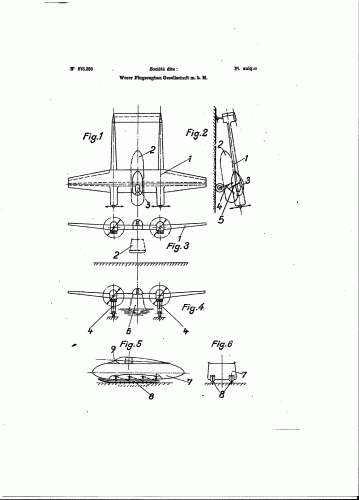

Hello gentlemen,
not the right place to post a patent, but compare this layout with the WFG 2137. French patent from 1941 filed by Weserflug. Interesting, at least.
Shades of XC-120...
Nice picture...but what's with the skids on the pod? do you know what was the mode of operations?
Apparently, the skid version was to have rubber buffers in order to absorb the landing shock. Fieseler had the same pod concept too in the Fi333, as well as Focke-Achgelis with the Fa284.
More than interesting: wonderful... ;D A kind of Packplane forefather with an amphibian version featuring an incredible boat removable pod, incredible! Thanks! ::)

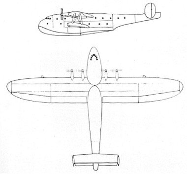

We P2120, long range flying boat, 1936;

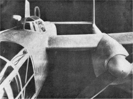

Histaviation showed only a small portion of the mockup of the WFG 2127. Are there any other pictures or line drawings of the 2127? I tried Google but no luck.
That photo comes undoubtedly from Luftfahrt International #25 (Jan/Feb 1978), which has an article on the WFG 2137. It however calls it the '2137 mockup (with Argus 410 engines). The drawings found under the WFG 2137 entry on Histaviation are the only drawings contained within the article. So no drawings of the version with asymmetric cockpit, being it the '2127 or the '2137...

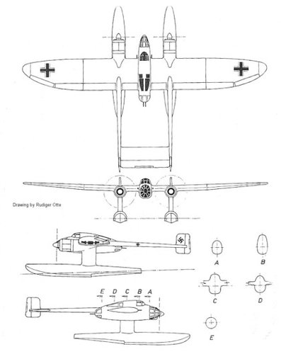

It gets better! Rereading the Popphanken book I just found that one of the floatplane versions of the WFG 2137 was to be equipped with retractable floats, retracting innersides to the fuselage. Great!!!

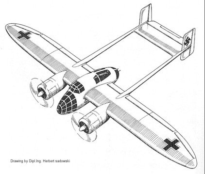

Some additions to this thread: the WFG 2127 had at least two configurations ( 2003/IIf, a close reconnaissance twin boomer, and the 2003/Id, with a conventional fuselage ) stemming from a common ancestor, project 2003 (hence the primeval 2003 designation). This one dates from early 1935 with a RLM preliminary contract worth 62000 RM, and had twin booms. We know that a wind tunnel model of the WFG 2127 (Wwhich one?) was tested in Spring 1936, and a mockup was built in April 1937 ( a photo is published in this thread of this assymetrical "attrappe"). I`ve crossed data from Pophanken`s book and the "Luftfahrt International" 1978 article.
From an article about Adolf Rohrbach, published in "Der Flieger", Heft 5/1972, kindly supplied by our fellow member Richard ( thanks Richard :) ), we can read a statement by Hubrich, Rohrbach`s chief test pilot, on the WFG 2003 double fuselage project. Starting from 1934, it was made into a mockup in 1935. He said "the machine had excellent opportunities for placing defensive weapons", with engines and landing gear "enclosed". Two engines would propel the aircraft at a speed of 400km/h. I guess this isn`t the WFG 2127 "attrappe".

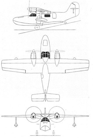

The Float plane version of P.2137 is new for me,and some Projects;
