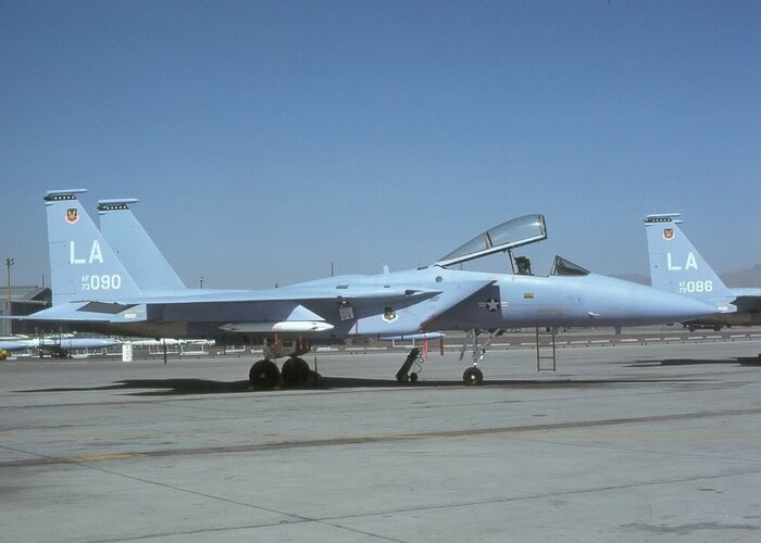

The A/G capability was not completely ignored, even by TAC. At least some units practised for A/G once in a while, I think it was the 1st FW before they got MSIP Eagles iirc.
Here's a very early F-15A. Note the SUU-20 practice bomb/rocket dispenser.

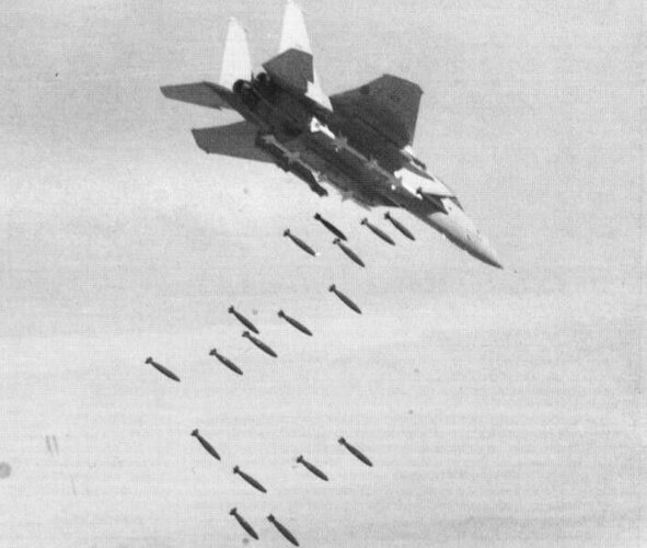

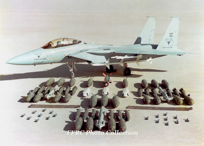

TF-15 promo shot displaying load-out options
TF-15 dropping some Mk 82s
Fast packs aka CFTs were on the table very early. Massive range increase for A/G missions. Would have been part of Canada's CF-15 too.

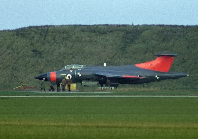

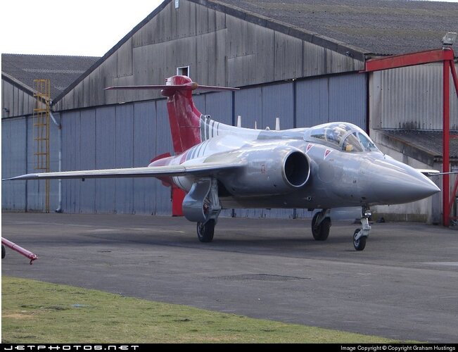

Some Buccs were used to develop the Tornado radar and going by the mod the radome and I assume associated kit was quite a bit bigger than what the Bucc had space for. It might have a good endurance and be well suited to low level, but does it have the avionic space for the size of radar needed? Upgraded Bucc instead of Tornado would make good alternative history regarding the RAF frontline fighter fleet...
The Tornado IDS had two radar antennae in its nose, to perform attack, terrain following, and one ground mapping.
Hence the wide, blunt radome.

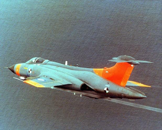

Buccaneer XX897 was a testbed used to test the ADV Tornado Foxhunter radar.
The Tornado IDS radar Buccaneer testbed. It would likely need a forward fuselage rework should it be chosen to upgrade Bucc over new Tornado production which quickly turns into a new expensive design process anyway.
