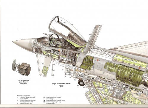

Hi! I got this drawing in 2008 AEROSPACE JAPAN. Enjoy.

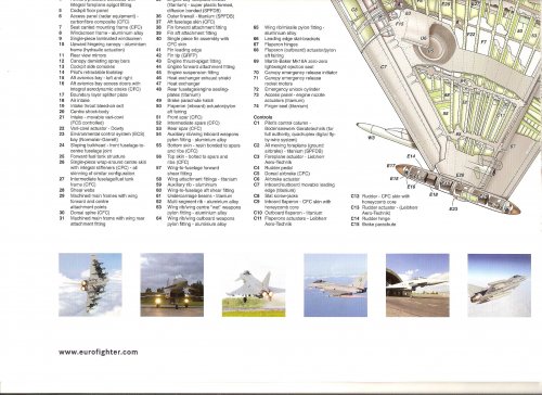

Second data.

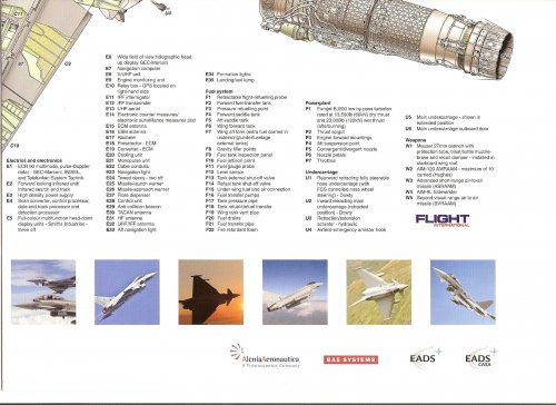

Third data.

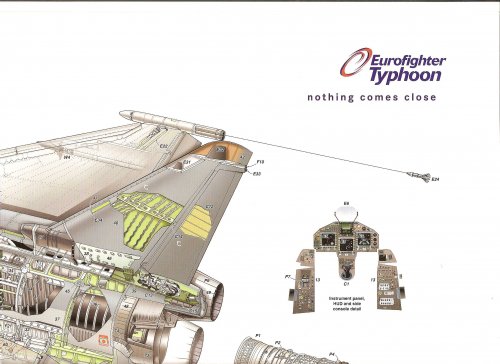

And final data. I surprised very much to know that Typhoon is Mach 1.3 - 1.5 super cruiser. And has good kill ratio to Su-35.
"I surprised very much to know that Typhoon is Mach 1.3 - 1.5 super cruiser. And has good kill
ratio to Su-35."
The Typhoon CAN supercruise, although I don't know in which configuration ( clean, with some
AA missiles or even with tanks on ? Surely not in an attack configuration, as the F 22 can) and
it probably CAN shoot down a Su-35, that's what it was built for.
