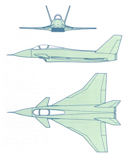

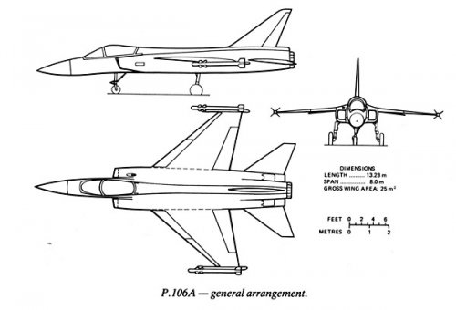

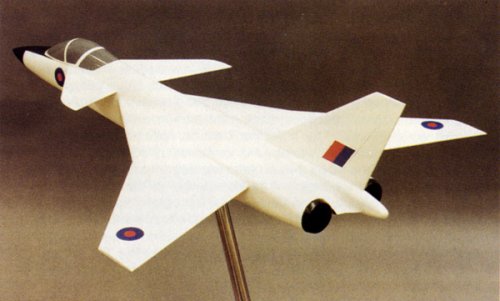

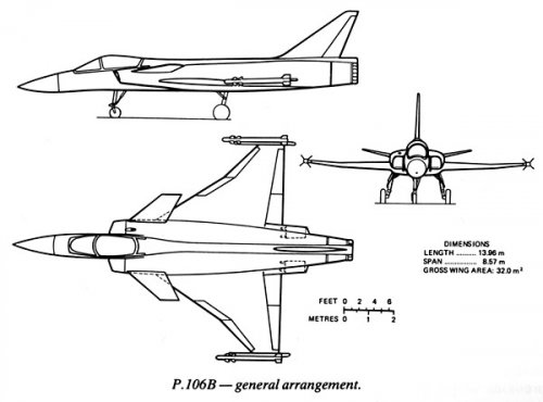

1980 projects, part 1: BAe's submission to the tri-nation ECA program, plus the P106 light fighter design in conventional (P106A) and canard delta (P106B) form

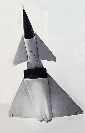

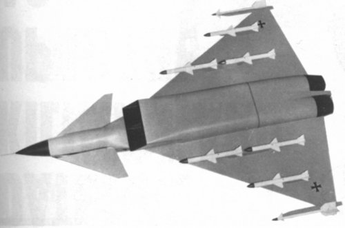

2 early TKF-90 studies

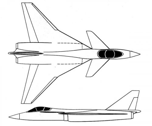

MBB TKF-90
1979
1980
  • Flug Revue 04/79, Flug Revue 02/80

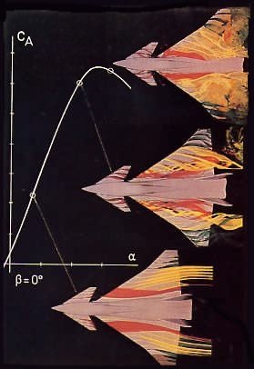

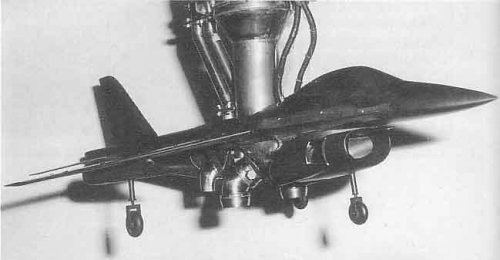

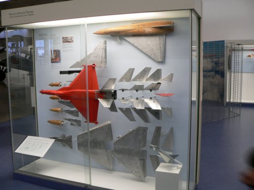

Windtunnel models used to test a multitude of nose-cone shapes (strakes, chines etc.), LERX variants, wing planforms and tail configurations in connection with the EFA project. Photographed at the Deutsches Museum in Munich.

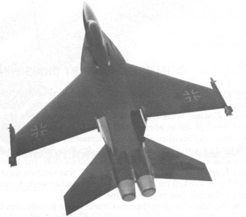

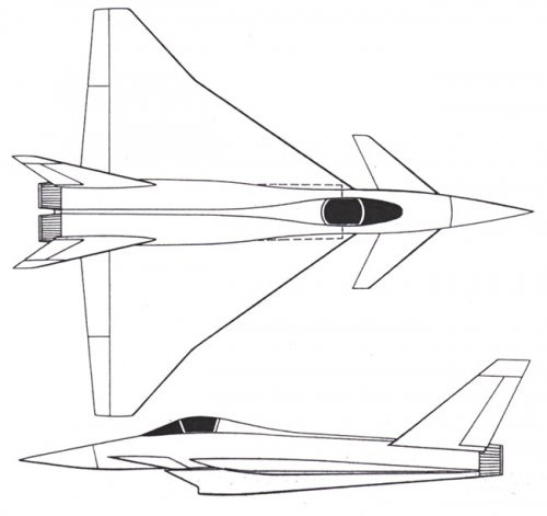

MBB TKF-90, 1980
  • 'A New Fighter for Europe' Air International, September 1980

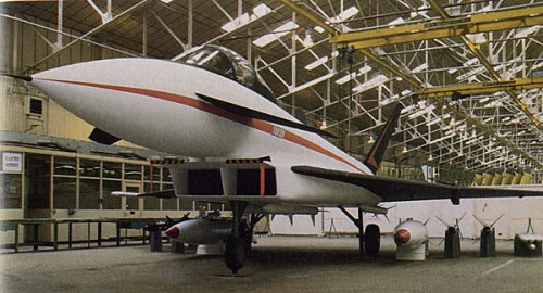

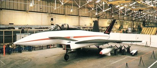

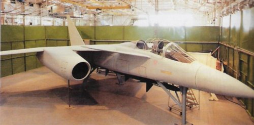

Where's the F16 look-a-like (with twin tails)?

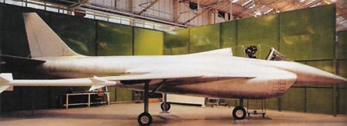

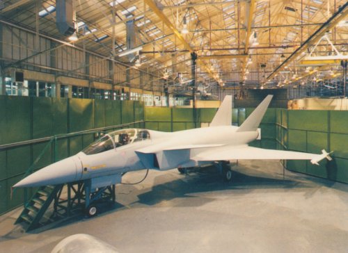

Overscan, these pictures are fantastics! I have red in BSP that some full-size mockups had been built between 1977 and 1984, but its the first time I saw photos of it... :D
Hey, a mockup of the Hawker P.1216 was built in 1985. Have you photos of it??!!! (sorry to hijack the thread)

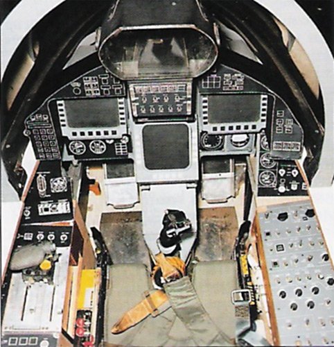

Just like full size mockups!!!

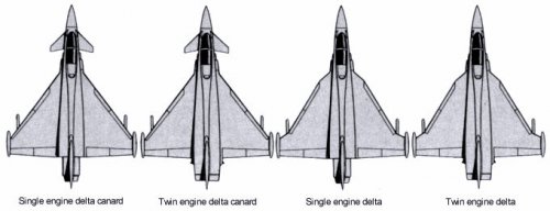

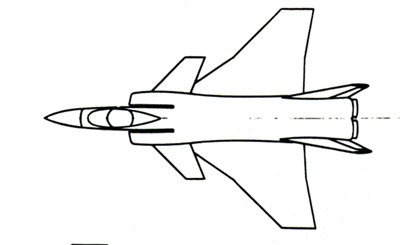

Are these the "Eurofighter Lite" design studies that were promoted by Germany in the early 90s?
This image was posted by Matej in another forum. Perhaps Matej could shed some light on the original source.
This picture was published in Flight International, 28 October 1992, page 16. Article is generally about NEFA - studies to cut the costs of the planned EFA to meet different national requirements using the same airframe.

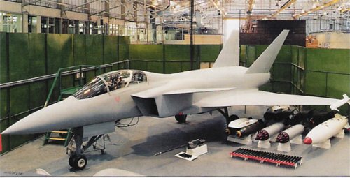

And specially for Archibald - german ECA mockup :)

It’s a real shame that Britain didn’t go it alone and produce aircraft like the P110 and P106. Both of those fighters could have been great successes. Just asking, is the Gripen derived from the P106B. I know that BAE is a partner with SAAB in export but the similarities between the two are uncanny.

From what I've read, Thatcher government support of the P106B in the early 1980s might have resulted in collaboration with Sweden and perhaps even India. BAe attempted to build a consortium outside of the current Eurofighter partners, but without official support, any lightweight fighter project was doomed.
Personally I think P.106B would have made an excellent aircraft for the RAF. It could have used Blue Vixen radar, a developed RB199 engine and been in service in the mid 1990s. With AMRAAM & Blue Vixen it would have been more than a match for any likely adversary, and been progressively upgraded avionicswise. Hmm... does this sound familiar? ;D
It would have had good sales potential abroad too.
All I’m saying is that the similarities between the Gripen and P.106B seem more than that BAE and Saab were heading in the same development direction or the wing, it’s the entire aircraft. Other than slight dimensional difference, and air intake design; the Gripen and P.106 are almost the same plane. If the J-10 is said to be a Chinese Lavi than it not far fetched to say that the Gripen is a Swedish P.106B.
I would go far as to say that P.106B was very similar to Saab's 2105 configuration, and virtually indentical to the NAL windtunnel model of an early LCA concept.
However, the definitive Saab Gripen was based on the slightly different configuration 2110 and we all know that the Indian LCA lost both its canards and any visible similarity to the P.106B.

Was the P.106B equipped with a thrust reverser? Drawings I've seen seem to suggest some sort of Tornado-like installation rotated 90 degrees to open up horizontally instead of vertically like on the Tornado.
