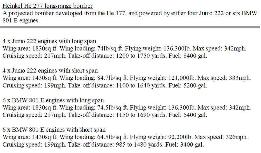

I haven't found any info about 6 x DB603 https://en.wikipedia.org/wiki/Heinkel_He_277
there was two versions of Heinkel He.277 with six engined,and not one ?.
I believe that Heinkel 277 six engined was simply a typo : i have seen this configuration just on alternate-history anime called " Deep Blue Fleet ". Ta-400 was a six engined bomber of Focke Wulf .
See reply #62. It's not a typo. There were two engine options for the 277 in December 1943 - 4 x Jumo 222 or 6 x DB 603. So few of Heinkel's project documents survive that we know very little about the planning and development of the 277. But we do know that much.
ok , and 6 BMW 801E for competition Amerika Bomber . Surely options for 6 engines were only proposals without a defined designs .

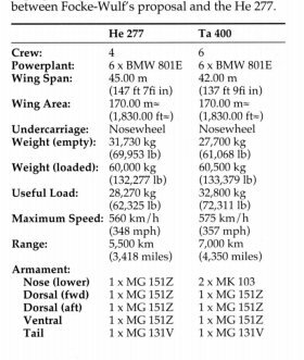

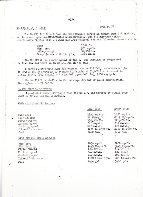

The source; Secret Luftwaffe Projects of the Nazi Era From Arado to Zeppelin with Contemporary Drawings
nformations about Six Engines was on Book of Manfred Greihl . So i don't why you despise wikipedia english .
Wikipedia is not a primary source - it is composed of material from a variety of secondary sources, most of which fail to cite their primary sources. I don't 'despise' it - I simply regard it as wholly unreliable.
Unfortunately, the study of German wartime projects has become clouded, particularly over the last few decades, by writers who have wanted to publish on the subject of 'German secret projects' but who have had no access to primary sources.
They have tended to pick and choose bits and pieces from older secondary sources in order to cobble together their project descriptions. Some writers in the field seem, regretably, to have used 'guesswork' rather than primary source research to fill in the gaps in their histories. In other words, making things up as they go along.
Hesham's reference to 'Secret Luftwaffe Projects of the Nazi Era From Arado to Zeppelin with Contemporary Drawings' is very helpful, because it clearly identifies the source of the information on the BMW 801 x 6 for the He 277. This information comes from British intelligence report A.I.2(G) Report No. 2383 German Aircraft New and Projected Types of January 1946, compiled by Horace Frederick 'Rex' King (Secret Luftwaffe Projects of the Nazi Era From Arado to Zeppelin with Contemporary Drawings by Walter Meyer, an Amazon ebook, is basically a reprint of that report).
For years, King's report has been one of the key pieces of near-primary source evidence on the He 277, since he compiled it from a mixture of captured German documents and Allied documents written about and sometimes containing sections of captured German documents.
Griehl would have got his information on the He 277 from that report too.
Having spent years searching through the hundreds of thousands of pages of captured German documents still held at archives around the world, I can tell you that information on the He 277 from actual primary sources - German documents produced during WW2 - is extremely rare. We don't know exactly what happened to Heinkel's projects documents. They may have been destroyed in an air raid or a fire or captured by the Soviets. Whatever the case, they were not available in any form to the Allies immediately after the war in the way that many documents by Focke-Wulf, Messerschmitt, Gotha, Blohm & Voss and Arado (and to a lesser extent Dornier) were. The project work of Heinkel, Henschel, Siebel and Fieseler was lost. The work of Junkers appears to have been captured by an American team led by Charles Lindburgh but then never seen again (except for a number of photo albums showing wind tunnel models).
So, A.I.2(G) Report No. 2383 German Aircraft: New and Projected Types by H. F. King does indeed feature that table showing the He 277 with four Jumo 222 engines in either long or short span form, and with six BMW 801 E engines in long or short span forms (see attachment of p73 of that report).
But it doesn't tell us what document that information comes from, or when it was created. We don't know if this information is the absolute last word on the He 277 or the very earliest data table on it.
Some of the documents used by King to compile his report can be found in archives relatively easily. For example, most of the data he includes on Arado types he mentions are easily found elsewhere. But there are a handful of snippets which are thoroughly elusive (such as the sources of his He 277 data and the source of the Henschel P 122 project data).
We simply cannot verify King's He 277 data using a known primary source. But we do have the primary source I've shown in reply #62, which shows 4 x Jumo 222 or 6 x DB 603 - because the BMW 801 won't fit. It could be inferred from this that the 801 was indeed projected for the 277 at one stage but subsequent work has shown that, in fact, the 801 is unsuitable for the 277. The only verifiable information we have concerns the 4 x Jumo 222 and 6 x DB 603.

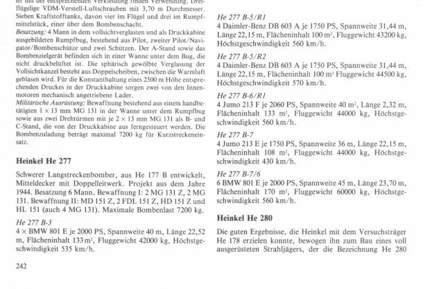

Die Deutsche Luftrüstung, 1933-1945
there were six variants with six configurations:
B3 - 4 Bmw 801E
B-5 /R1 and B5/R2 4 DB603A
B-6/R1 and B7 4 Jumo 213
B7/6 - 6 BMW 801

The engine options may be real but those designations are almost certainly bogus. Generally speaking, German aircraft types that had not even reached prototype stage were not given series production sub-designations, i.e. A-1, A-2, B-1, B-2 etc.
When we speak about projects the designations are almost speculatives. :D

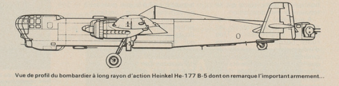

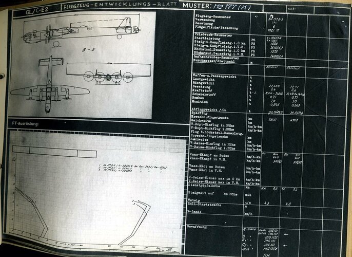

I want to check from this Info about Heinkel He.177's competition ;
The aircraft was supposed to reach a maximum speed of up to 500 km/h and have a maximum range of 5000 km. For this it was proposed to use the following types of engines:
• Argus-421 (24-cylinder air-cooled)
• BMW-139 (14-cylinder air-cooled)
• DB-601 (liquid-cooled 12-cylinder)
• Jumo-206 (6-cylinder liquid-cooled)
• Jumo-211 (liquid-cooled 12-cylinder)
• SAM-329 (14-cylinder air-cooled)

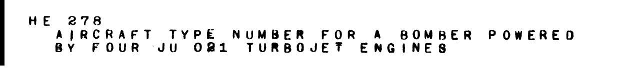

Also from this report,here is a hint for Heinkel He.278 ?!.
