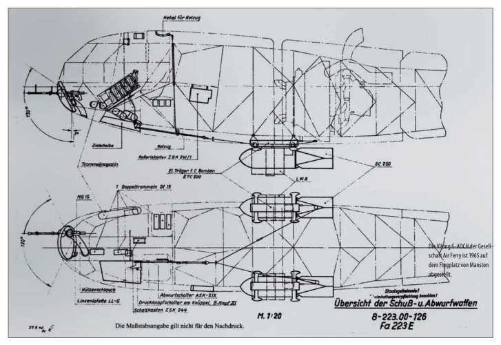

I know the Focke-Achgelis Fa 223 could be (was) fitted with a MG but this was strictly for defense and the design was not intended as a gunship. It could, however, be fitted with two bombs and I suspect this was an afterthought.
As for a dedicated attack helicopter, I've never run across such a project. But, perhaps someone here may show otherwise! ;D

According to "luftarchiv.de" the Focke Achgelis FA 223
v16 DM+ST has a MG 15 in the nose
i read for the FA 269 and armement of 2 MK 103 OR MK 108
inserted laterally, behind the pilot in the fuselage and
a canon of 20 m/m under the pilot's seat ???

When it comes to german helicopters, Steve Coates is the man. His excellent book "Helicopters of the Third Reich" does mention a Fa 223 with a single rotor driven by a BMW 801 with twin tail rotors. It was first seen at a 1943 Berlin presentation on helicopter progresses, organized by the Deutsche Akademie der Luftfahrtforschung . No more data, but a photo of the model is available. It was designated as a "high-speed helicopter".
maybe there is an element of truth then? .. i will have to look into getting this book. ive think ive heard of it before.

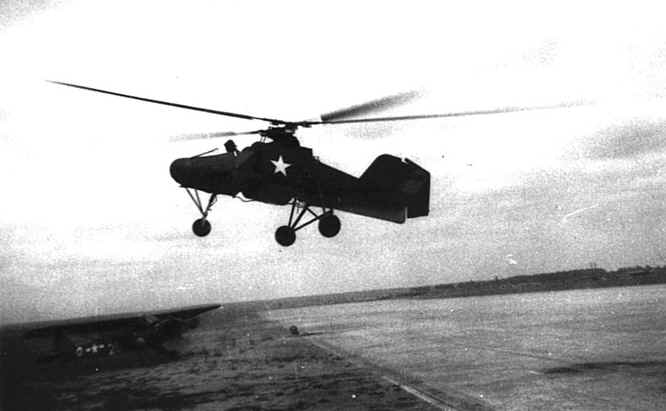

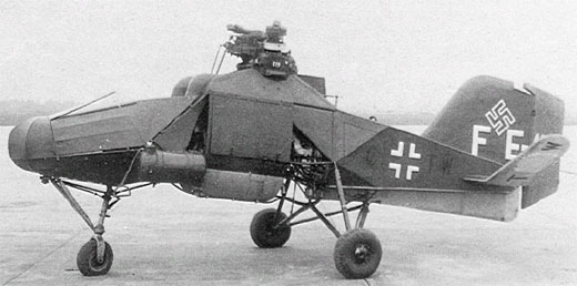

The general appearance of the Fl 282 V23 could lead the uninformed to believe it to be an 'attack' helicopter.
Jon
"The general appearance of the Fl 282 V23 could lead the uninformed to believe it to be an 'attack' helicopter"
The Fl 282 was tested as an ASW helicopter with depth charges and the general idea of an
armed helicopter wasn't new at this time (although flight performances of early helicopters
may not have been very inspiring for converting them into "fighting machines"), see
http://modelarchives.free.fr/Bestiaire/G20_P/index.html.
Nevertheless, I think, if fitting of machine guns was envisaged, as in the case of the Fa 223, this was
just seen as a matter of self defense.

Apologies for digging up an old thread, but re: the use of the FI 282 as an attack helicopter, a certain crowdsourced database is quoting a generic 2005 book on 'Military, Civilian, And Rescue Rotorcraft' as the basis for a claim that, "During the Battle of the Bulge a formation of five of these aircraft conducted the world's first helicopter strike against armour. Operating low over the Ardennes Forest they destroyed two American tanks at a loss of two of their own, one to a British Spitfire, the other to groundfire."
This is the first time that I've seen this claimed combat action involving the Kolibri reported, and the lack of any prior mention of fixed weapons being operationally mounted on the type leads to visions of bombs being dropped by hand from the cockpit, WW1-style.
Has anyone ever come across any other reference to this five-ship 'attack,' or is it more likely to have been a case of artillery spotting (and/or confused reporting)?
An interesting statement, I've never heard of before. Principally it seems not to be unthinkable,
especially if we remember the use of Bücker 181 Bestmann as "tank hunters" fitted with 4 Panzerfaust
anti-tank rocket launchers. Regarding the well known results of the mock-combat of a Fl 282 against
a Fw 190 (which is said to have scoured no hits !), it wouldn't seem to be more insane to me.
About armament it could just have been the observer using a handheld Panzerfaust, or maybe anti-tank
cluster bombs like the SD 4 HL. If not dropped from bomb racks as used for the ASW bombs, the observer
could have dropped those 4 kg bomblets by hand. If true, it certainly was a desperate action !
Fantastic account, if confirmed. I will ask Steve right away. Stay tuned.

CarlosThanks for you e-mail. This is a complete fabrication. There is no documentary evidence for this statement. If they'd been that successful surely they would have continued to be used in that role. In January 1945, all Fl 282s were at Schweidnitz bar the Fl 282 V20 which was probably at Travemuende and probably not in an airworthy condition. The Fl 282s were probably used in artllery spotting trials but I'm yet to find any definitive contemporary documentary confirmation.RegardsSteve
Wurger - Thanks for the confirmation. I suspect we're going to be correcting this fabrication online for years to come.
Jemiba - Thanks for the background discussion.
Carlos brought this thread to my attention and I'd like to make a posting to try and bring a decent degree of clarity to things. Unfortunately, for reasons that I won't profess to understand, people do on occasions post on the Internet or publish in books information which I'm not sure they can properly substantiate and I believe that is what we're dealing with here although the extent of deviation does seem excessive. When writing 'Helicopters of the Third Reich' I worked very hard to research this topic and be able to prove what I had written so that I was presenting a credible retelling of the history of the development and use of these machines. Dealing with Luftwaffe / German aircraft development history is hampered by the wartime destruction of in excess of 90% of records so holes definitely exist.
I'd be more than happy for someone to produce documentary evidence of this alleged encounter but there's no evidence of such an encounter in 2nd Tactical Air Force claims. At this stage of the War, no Luftwaffe units, operational or evaluative had any helicopters on strength. As best as can be determined all Fl 282s were back with Anton Flettner Flugzeugbau GmbH in Schweidnitz bar the V20 which was unserviceable and was almost certainly at E-Stelle Travemünde. A small number were flown westwards in mid February as a consequence of the advance of the Red Army. A couple eventally made their way with the decamped Flettner team to Bad Tölz and a couple were assigned to Transportstaffel 40 which was established in February / March 1945 in Southern Germany.
Fl 282 were involved in artillery observation trials. This much is known from a very comprehensive report written immediately after the war at the behest of the Allies by Gerhard Sissingh and Oskar Nagel: 'Monographien über Fortschritte der deutschen Luftfahrtforschung (seit 1939) Band N – Überblick über die deutsche Entwicklung und Forschung auf dem Gebiete der Drehflügelflugzeuge'. My belief would be that these trials were undertaken at the Heer's Artillerieschule II at Gross-Born as it is known from some contemporary correspondence in my possession that an Fa 223 was also trialled there for this purpose. Unfortunately, I have never come across any records for Artillerieschule II in my researches. Equally, I have never come across any reference to a helicopter being even tested for its anti-tank capabilities let alone used operationally. Indeed, an OKH document dated 10/1/1945 which I have very recently discovered concerning the proposed operational use of helicopters in support of the Heer envisages the use of two types, the Fa 223 as a load carrying helicopter and the Fl 339 as an artillery spotter. The Fl 339 was then in development and there was little realistic hope of it coming into serial production but that's another issue. The document also makes reference to the establishment of an Erprobungsstaffel, which of course was subsequently formed as Transportstaffel 40. I think it is quite telling that this document does not reference the alleged engagement.
I hope this helps to clear up this issue for now although I strongly suspect this fanciful claim will be reproduced elsewhere on the Internet. Finally, of course if you haven't read the book and you are genuinely interested in this topic, then please go out and buy the book. It will help supplement my pathetic royalties !

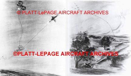

In the USA, Platt-LePage put together an engineering proposal for an armed attack helicopter, based in the PL-3/XR-1 lateral tandem layout in 1940, with their PL-4 helicopter design.
Along with the engineering proposal, PL-LP produced a series of renderings , showing how an armed attack helicopter could be used operationally, many years before attack helicopters existed.
Unfortunately, The Air Corps was not ready to pursue this idea in 1940, and Platt-LePage was tied up just getting the XR-1 prototype built, and into the air, which was a long story in its self...
A small excerpt of the tactics package:
