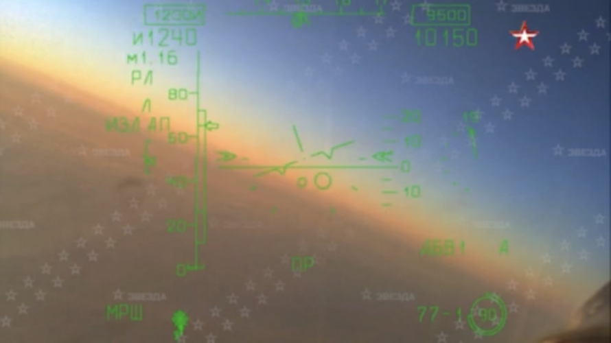

When pilot e.g. during exercise,simulations or during the real combat situation ,choose to use R-77/R-77E, he will get designation '77' on his HUD. The same thing is for the newer Russian R-77-1 where many sources mention that export version is known as RVV-SD but the real military designation is simply R-77-1E ( EL) or with the laser proximity fuse only. RVV-SD is in fact only commercial designation for the Izdeliye 170-1/R-77-1 and its export variant. As we can see on many videos through Su-35S's type IKSh-1M HUD, there is '77-1' designation.
Sequencies from 18:30 and we can see '77' as designation for the R-77/E.
View: https://www.youtube.com/watch?v=WiMHBxSp6f0&t=1108s

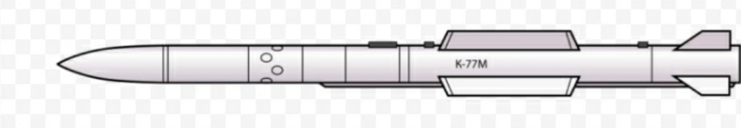

Now in the middle ,we can see some new AAM ( model of course) .For me, this can be K-77M or R-77M for the T-75/Su-75. As we can see ,it has wings from the R-77/R-77-1 and the new folding almost
rectangular stabilisers.Also the body of the missile is from the old R-77/E. AAM type R-77 has length of 3.600mm ,body diameter 200mm and wingspan 450mm.
Source ( of course it is not Izd 180 ) : View: https://x.com/MuxelAero/status/1417540055418159110/photo/1

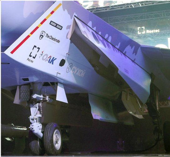

That AAM inside of the side FWC.
From paralay.ru ....
This is original R-77 mockup with rudder fins swapped.
Yes, tnx and it seems they are not foldable?

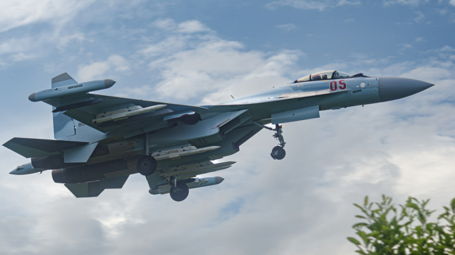

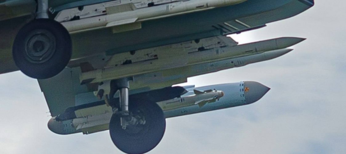

We know now that Izdeliye/Item180 is not some K-77M (some sources mentioned R-87 as military designation).Than that Izdeliye 270 ( or R-47 ?) as short not medium-range AAM , Izd 760 as we know is R-74M2 with LWIR band homing head and Izd 810 or R-97 (definitely) as heavy very long range hypersonic AAM.​
Two 180 under intakes. Look closely at fins.
Hm, tnx. Yes, I can see now that shorter wings in the comparison with R-77-1 and of course that triangled stabilisers. That new AAM is K-77M/R-77M. If we look better and compare the lenght of that new version ,it is almost the same ( if not the same ) like as R-77-1 ( 3.7m) . Maybe it is the Product 180 and the Product 180-BD is with that air intakes which we can see on the photo where two of them are attached under the wings of the prototype T-50.
Interesting implication here is that once again none of top line Russian service MRAAMs were recovered ... at least for now.
Any idea of the range of the R-87, is this roughly equivalent to AIM-120D or perhaps even AIM-260?
It's reasonable to assume it's a modern weapon with state of the art performance. We just don't know anymore.
And apparently those are already being used.
Ukrainian source gives 190 km range, and dual mode(pulse?) engine.

Hm, I don't think so. If we look better,lenght of the R-77M is almost the same as of R-77-1.
It seems rear end extends way further behind the pylon. I.e. ~4.1m estimation seems good.

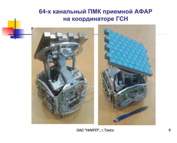

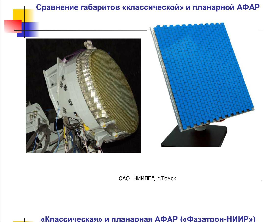

I wonder what seeker it does have. Initially, 180 was supposed to have AESA seeker.
It's appears to use a mechanically phase-agile hybrid scanning seeker with 64 T/R modules.As a comparison, debris from the PL-15E missile in the India-Pakistan conflicts reveals it has 192 T/R modules.
We don't know if this AESA based seeker is inside of the Izd 180 / R-77M .
https://topwar.ru/101149-planarnye-...a-na-osnove-ltcc-keramiki-made-in-russia.html
For me it would be logical that all new inertial-radar guided AAM's for the Su-57 have AESA based active radar seekers ( from Izd 171-1, via 180/PD, 270 and 810 ).
One of many Russian (civilian)sources that wrote about this new AAM....
Новейшие ракеты Р-77М дальностью 190 км встали на вооружение истребителей Су-35С​
The latest R-77M missiles with a range of 190 km have entered service with Su-35S fighters.
''Ракета Р-77М полностью ликвидирует отставание ударной мощи ВКС России от американских ракет аналогичного класса AIM-120D, дальность которых при пуске на эшелоне 13500 м может доходить до 180 - 190 км.''
''The R-77M missile completely eliminates the gap in the striking power of the Russian Aerospace Forces compared to American missiles of the same class, the AIM-120D, whose range, when launched at an altitude of 13,500 m, can reach 180-190 km.''
https://www1.ru/news/2025/07/25/nov...vstali-na-vooruzenie-istrebitelei-su-35s.html

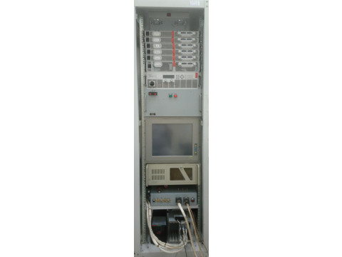

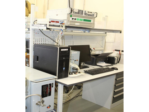

Системы измерительные СИ РМ-180 контроля параметров изделий 180​
''Системы измерительные СИ РМ-180 контроля параметров изделий 180 (далее - система или СИ РМ-180) предназначены для воспроизведения и измерений напряжения постоянного тока, измерений силы постоянного тока и временных интервалов, а также для регистрации и отображения результатов измерений и расчетных величин.''
''Measuring systems SI RM-180 for monitoring product parameters 180 (hereinafter referred to as the system or SI RM-180) are designed to reproduce and measure direct current voltage, measure direct current strength and time intervals, as well as to record and display measurement results and calculated values.''
Some photos on :
https://all-pribors.ru/opisanie/79695-20
Системы измерительные контроля параметров блоков "5" и рулевых приводов БРП-180.9500-0​
''Система измерительная контроля параметров блоков «5» и рулевых приводов БРП-180.9500-0 (далее - БРП-180.9500-0) предназначена для измерений и воспроизведения электрических и радиотехнических величин при проверке технических характеристик блоков рулевых приводов при производстве и эксплуатации.''
''The measuring system for monitoring the parameters of units "5" and steering drives BRP-180.9500-0 (hereinafter referred to as BRP-180.9500-0) is designed for measuring and reproducing electrical and radio engineering quantities when checking the technical characteristics of steering drive units during production and operation.''
https://all-pribors.ru/opisanie/76383-19-brp-1809500-0
The main link for some technical/control equipment for the AAM's like Izd 170-1, 180,760 and 610M.
Оборудование в госреестре ОАО "ГосМКБ "Вымпел" им.И.И.Торопова", г.Москва​
https://all-pribors.ru/companies/oao-gosmkb-vympel-im-i-i-toropova-g-moskva-1394/grsi-devices

About new R-77M ...
If this new AAM really has dual-pulse engine ,question is. When exactly starts the second pulse? First one of course starts after ignition and is used for the acceleration until AAM reaches max speed.( max Mach number). Now we come to the second one and some sources give info that second pulse starts after active radar seeker lock-on the given target .Is this possible and real?
