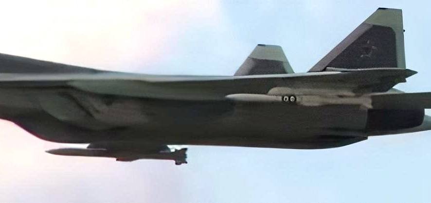

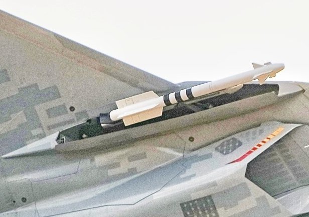

Even if we assume for a moment that is true, there is the elephant in the room: why would Vympel show a half finished missile alongside the then prototype stage R-74M2 and that notched wing R-77 variant (R-77-2?)? They could not have shown it at all or they could have shown something else of their vast portfolio. We need a satisfactory answer to this question between dismissing that missile as just a half-finished/section of an R-77.
This 'new missile' was seen in a video of the Vympel assembly line, not the sales booth at MAKS airshow. Vympel didn't show anything.
The alternative hypothesis is that Vympel created a new and secret small air-to-air missile of uncertain purpose as a "cut-and-shut" made from reused R-77 parts, then accidentally displayed this topic secret missile in a video of their assembly line.
They have then kept silent about it, never displaying it at airshows nor discussing it.
I suggest users bury this discussion until some kind of actual evidence emerges, and stop endlessly rehashing the same speculation, or receive a topic ban.

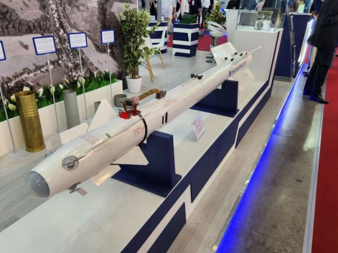

''MAKET 171-1 IMM'' ( 171-1 ).
Тake a look on the sequences from 17:20 ( red model of the Izdeliye 171-1).
Your photo only shows that it is an inert model related to Izdeliye 171 testing, which doesn't tell anything helpful, while the red model undergoing a drop test in the video is likewise a test item. Neither prove this "hole" is present in the actual missile. We need to see a photo of an actual missile with a hole in its wing actually being carried or fired from an aircraft, or even a representative model displayed at an airshow.
IMM is literally Intertial Mass Model. Not the "new notched wing" missile. It's seen in video that notches being used for cables in drop tests.
You continue to live in your fantasy world where security cleared Vympel anniversary video show dozens of a new "classified Izd 270 missiles" (surprisingly based on old 170, not 180) that just don't have place for fcuking rocket motor section on assembly line. Where all these shorties go after that? To classified storages in Neverland?

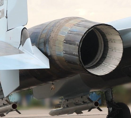

And I hardly advise you to find 170/171 nozzle photos on web to understand that it looks totally different even from that 10*10 pixels nozzle area end you trying to use as 'proof'
Yes, those '171-1' inert model photos and tests are now 6 years old. What happened in these 6 years,we don't know 'cause there is no reliable photo or video in the meantime which could tell us what is going on with that and the other new AAM's developed in the near past.

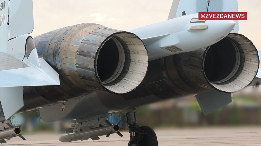

IMM or in Serbian 'GTM' (Gabaritno-težinski model) ,it is the same and I know what does it mean . Your answers are always the same. Now check that detail about black connecting block again beacuse it is obvious that there is a big difference between AAM's on that 'double-photo' ( blue and yellow lines).
Izd. 270 has the same wider nozzle as the Izd. 170 and exported Izd 190 ,yes . Newer Izd. 170-1 ( 171-1) have narower nozzles.

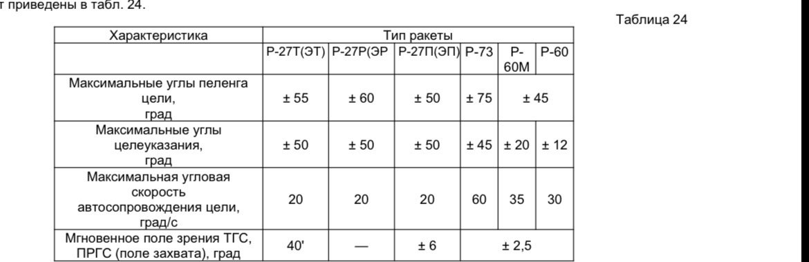

R-77 =50G lateral G load ,yes but R-73 can whitstend 40G ( lateral). AIM-120 has turn rate about 100°/sec.
For R-77/E and newer R-77-1 , crucial are those lattice stabilisers.
Isn’t it 60 g? For 73
Hm, I have info for 40G but that is from 'Duks' company as I can see.Today, Duks besides Vympel and Kurganpribor produces R-74 ( L/ML ). 60G of lateral G load for the 100+ heavy AAM is excellent.
surely you mean rvv ae
RVV-AYe in fact was designation for the K-77/R-77. 'RVV-AYe' is not the designation for the export version.Yes ,many sources mentioned that but it si wrong. V.Bogatskiy from ther Vympel company explained that once.
R-74m/rvv-md is also 60 g

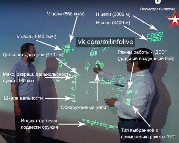

In the ILS, information can be divided into 2 blocks: information about the flight parameters of your aircraft and information about the targets of the tracked radars, as well as the weapons selected for use.
The flight parameters of your aircraft include: speed (1040 km/h), altitude (4400 m), flight course, director index of your aircraft showing the spatial position of the aircraft, the value of the number M — speed of sound (0.89), the values of the current overload and angle of attack.
Information and targets include the following indication elements: symbols of detected targets, speed of the tracked target (865 km/h), altitude of the tracked target (3000 m), range scale on which the range to the captured target (170 km) is displayed, maximum permitted launch range (160 km), operating mode (DVB), weapon hardpoint indicator and the most interesting for us - type of selected missile (97).
And so we have: we are flying at a speed of 1040 km/h at an altitude of 4400 m, the radar (radar station) of our plane accompanies a target that flies slightly lower and slower than us. The sighting system allows you to launch a missile at a distance of 160 km from the target.
The most interesting thing in this frame is the type of missile chosen — «97» Most likely the R-97 — new long-range missile «air-to-air», which was mentioned by the general director of the Tactical Missile Weapons Corporation Boris Obnosov.
Let's compare the R-97 a little with the latest modification of the American AIM-120 AMRAAM (AIM-120D) air-to-air missile. According to open data, its maximum launch range is — 180 km. The maximum missile launch range is indicated if it is fired at air targets flying at high altitude and at high speed. When attacking medium-altitude, medium-speed targets, the range of missiles drops significantly. Those. The launch range against a target with flight parameters H=3000 m and V=865 km/h (as in this frame) will not exceed 70-80 km.
Based on this, the new Russian missile «air-to-air» has a launch range 2 times greater than that of the AIM-120D. When attacking a high-altitude high-speed target, the range can reach 300 km.

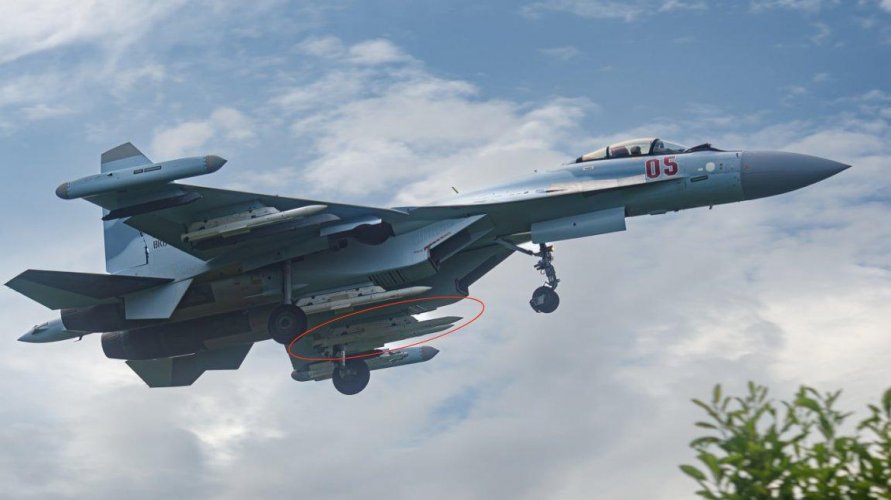

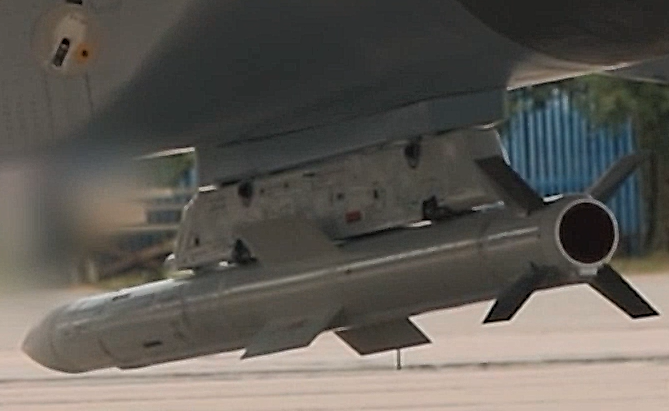

Photo where we can see that R-77M really has shorter and wider wings than R-77-1 .It seems that wings and stabilizers of the R-77M have the same span .

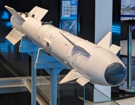

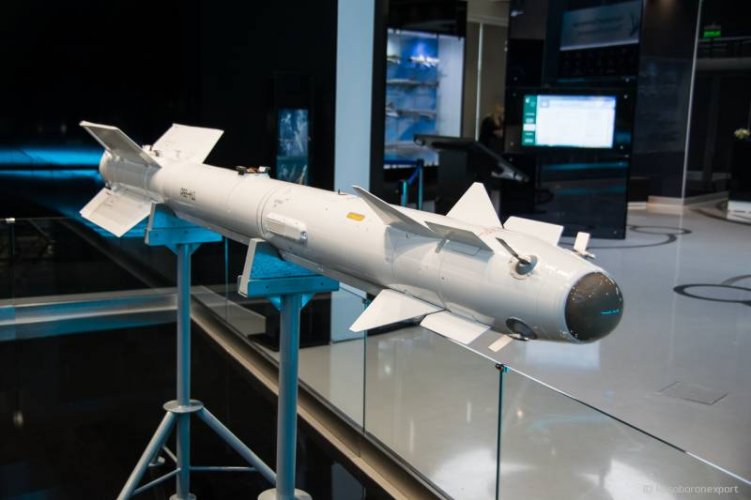

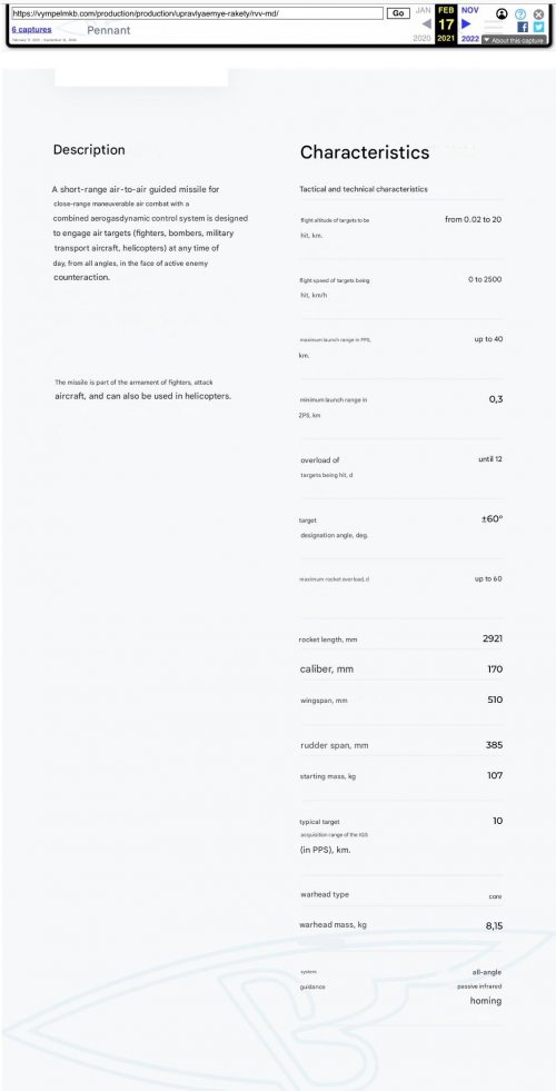

Some details about Izdeliye 750 or R-74M ( ML) /RVV-MD and Izdeliye 760 or R-74M2/ RVV-MD2
R-74M and ML with the radio proximity fuse Yantar and laser proximity fuse Krechet.Does it look that R-74M possess Germanium made dome for the LWIR band seeker?
R-74M2
More pics: https://ruslet.webnode.cz/technika/ruska-technika/letecka-vyzbroj/protiletadlove-rs/k-74m2/
As we can see ,R-74M2 has no AoA sensors : https://en.wikipedia.org/wiki/R-73_(missile)#/media/File:AA-11_Archer_missile.PNG

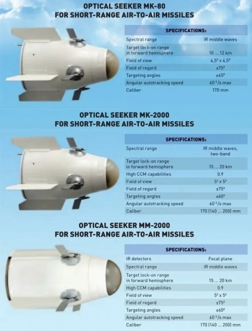

Authors Douglas Barrie and Piotr Butowski wrote some details,about R-74M and M2 and its Impuls-90/Karfagen-760 IR/ IIR seeker in the article called ''View to a kill'' part two from May 2018 "
''The K-74M (izdeliye 750) design replaced the previous Mayak (lighthouse) seeker with the two-band infrared Impuls-90 seeker. The Impuls-90 (impulse; IS-90) seeker is more sensitive (maximum range is 9.3- 12.4 miles, 15-20km) and it has an increased offbore- sight angle of +/-60°. The K-74M also introduced digital signal processing. Apart from minor changes in the dimensions of the seeker, the external appearance of the missile is unchanged. The new Impuls seeker, like the previous Mayak, was developed by the Ukrainian Arsenal Company of Kiev.
The programme, however, then disappeared from public view for more than a decade, only for the missile to be displayed again in 2009 with the export designation RVVMD (Raketa Vozdukh-Vozdukh Maloy Dalnosti, short-range air-to-air missile).
The K-74M missile completed state evaluation in October 2012 and was officially commissioned into service with the Russian Air Force with the military designation R-74M (the letter K denotes a missile in the development phase; after entering service it receives the R designation). It is fielded in two sub-variants: the R-74MK (izdeliye 750K) with radar proximity fuse and R-74ML (izdeliye 750L) with laser fuse; the latter is offered for export as the RVV-MDL.
On June 7, 2013, the Duks Company of Moscow secured an order from the Russian defence ministry to produce the first batch of 153 R-74MK and ML missiles by November 2015. Accordingly, in August 2013, Duks signed a follow-on contract with Ukraine’s Arsenal to deliver Impuls-90 seekers. Yuri Klishin, the general manager of Duks, told Russian reporters in June 2016 that since the previous year his company had been delivering a new missile developed from the R-73; undoubtedly, he meant the R-74. However, other Russian media reports suggest production of the R-74M is at a standstill because of the lack of components produced in Ukraine.
The current conflict between Russia and Ukraine has severed military co-operation between the countries, including deliveries of Mayak and Impuls infrared seekers from the Arsenal Company. Despite their efforts, the Russians have not managed to replace the Ukrainian seekers with an indigenous development; the Karfagen seeker from the AOMZ company (see below) is not yet ready for production. In April 2014, the Russian Radiozavod factory in Kyshtym was charged with mastering production of the Impuls-90 seeker for the R-74M (the Ukrainians had handed over the missile documentation to Russia in the early 2000s). The first 12 test seekers were to be completed by October 2014.
However, reports suggest that Duks did not deliver a single R-74M missile by at least October 2016, because of the dearth of Impuls seeker deliveries from Radiozavod. Reportedly, in 2015 the Radiozavod factory mastered production of the older Mayak seekers only.
The Karfagen seeker also doesn’t appear to be a full IIR seeker, which would leave the air force at a disadvantage against any opponent with an IIR-based AAM and would be a drawback for Russian industry in an increasingly competitive export arena. It seems possible the K-74M2 remains a ‘gap filler’ until a yet-to-be-identified next-generation IIR AAM project is completed.''
https://www.key.aero/article/view-kill
There is so many mistakes in this article. Even old Mayak-80/E was two-band IR seeker.To repeat, old Soviet R-73 (L) from 1983 had lock-on limitation of angle aspect of 120°,+/-60°. IR seeker coordinator had angle limitation +/-75°. From 1987 there was export version R-73E ( only with radio proximity fuse). Lock-on limitation of the R-73E for the MiG-29A/B was reduced to the angle aspect of 90° so +/-45° but with two optical blocks called SCAB-A/B besides the ILS-31/HUD.Than in 1991 was tested and from 1992 was in operational use R-73M where IR seeker had lock-on limitation of 150° ,+/-75° and where seeker coordinator had angle limits +/-90°.This new short range AAM had almost the same destiny as then famous RVV-AE or R-77.Only several hundreds of serial produced missiles were transferred to Akhtubinsk air base during 1991 and on 23 April 1994 both AAM's type R-74M(ML) and R-77 were officially entered VVS on the fighter MiG-29S/9.13S.

On the many photos we can see that R-74M/ML and R-74M2 have that black colored dome.Old R-73/R-74 have yellowish colored dome.There must be some difference than?
This is limitation of R-73/73L/73E on all models not just MiG-29. The max the seeker can be slewed is 45 degrees despite having a maximum 75 degree angle to target after launch. Only later variants increased this to 60 degrees. There are already pictures on this page that affirm this.
Read Su-27SK it will say same thing
https://www.secretprojects.co.uk/threads/current-russian-ukrainian-aam-projects.283/post-852545 IMG_0616.jpeg IMG_0617.png
That is not right, as I wrote, R-73/L with the original MWIR/ IR seeker 'Mayak 80' had angle limitation for lock-on in mode SHLEM or other of +/-60°. What you posted is only material for the export versions ,nothing else.
So +/-60° from 1983 for MiG-29 in VVS ( from 1985 for Su-27S/P ) and +/-45° for MiG-29A/B from 1987. From 1992 there was R-73M with +/-75° but that version like R-77 wasn't mass produced.
Su-27SK is the export version like MiG-29A/B, that is the point. Don't mix some material for export versions for the variants of VVS.

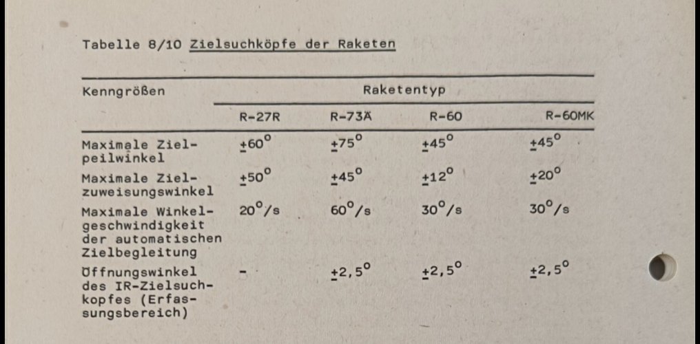

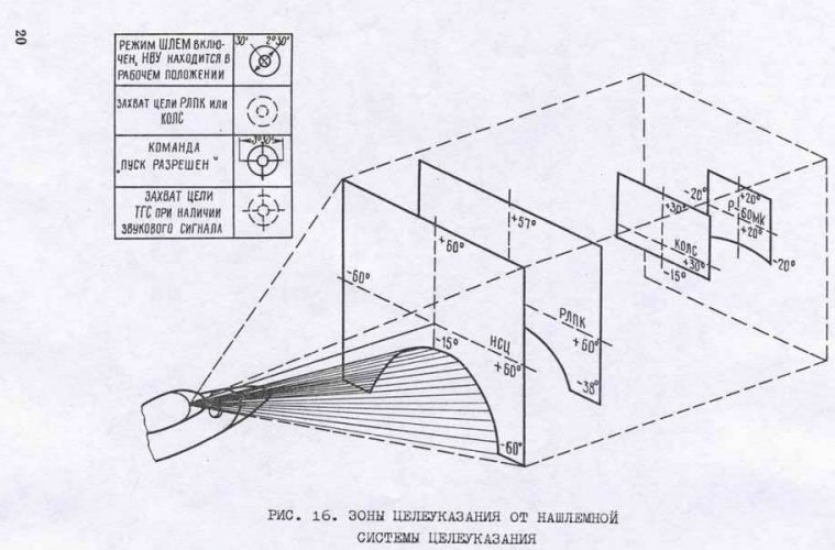

Then post some evidence. What I post are Ukrainian brochures both for Ukrainian and export service. Su-27SK manual also gives 45 degree limit. Domestic MiG-29 manual shows 45 degree limit. Idk what to say. Either you must’ve heard it from someone else falsely and believed it or made it up yourself.
Never did.
If you are confused why missiles would have lower boresight angles then HMS, the whole range of the HMS is used once the pilot activates COOP mode to activate radar locking with HMS.

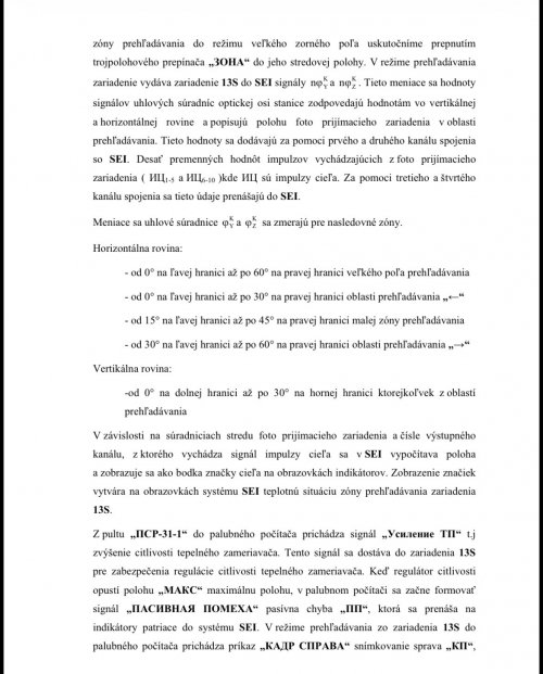

You already did it.Take a look on your own attachment where we can see lock-on zone with the HMS ( Schel-3UM with the optical colimator in front of the right eye type NVU-2M) . It is limited by the angles +/-60°.
Yes becuase it is only about what Schel-3UM can do and says 0.00% about what R-73 can do. Just because HMS looks 60 degrees in one direction doesn’t mean R-73 can lock that far.
