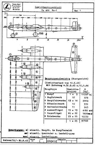

Looking for a dimensional drawings of the Jumo 211J. I need a similar plan as this:
Cheers

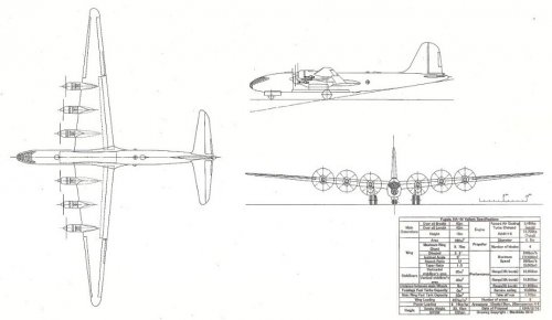

4,532

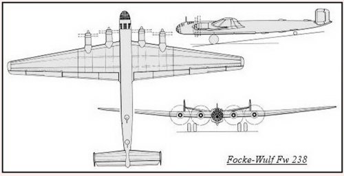

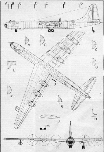

Hi! Fw238 and BMW803 liquid cooling engine. I like America and America bombers. ;D
Recently I feel that Fugaku final shape was very similar to the German America bombers.
Fw238 had almost same shape as my image for Fugaku HA54 variant.
Two upper aft turrets are very interesting. Of course they were remote controlled turrets.
The longitudinal middle point of the bomb bay was almost equal to the air center of the wing.
If not so, bombing was very dangerous because after dropping of all of the bombs, the center of the gravity of the aircraft was not equal to the air center of the wing, the aircraft lost longitudinal balance suddenly.
B-36's nose is very long to adjust the position of C.G. and A.C, because engines are located near trailing edge of the wing.
http://www.luft46.com/fw/fw238.html
Cheers
Michal Bradáč
Really nobody has a drawing of the Jumo 211J? :'(
Cheers
Michal Bradáč

Thanks, but I'm looking for drawings...
Cheers
Michal Bradáč

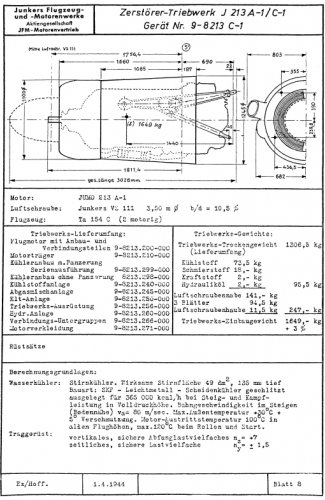

I'd guess that the 213J basic block would be externally the same as the earlier 213s. The external changes would be in the blower and accesories group. If you can find a mock up photo (AFAIK only a bench test unit or two was actually built?) and use that as a guide to adapt an existing drawing, might be the way to go.

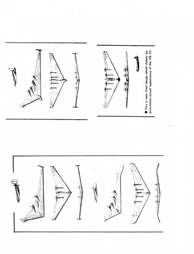

Greetings Chaps:
Not positive where to post this but someone will find it sooner or later. I'm on a new NB and everything is different from my 2005 gateway for writing-only NB.
Somebody please give heads-up that this attachment is done correctly and arrives for your download or perusal, ok? OK.
I plugged in someplace whereby another member was asking about AH-65 Variations? Jeez...I have a Cd loaded with old Lockheed projects some of which are simply wiieerrrdddd, and there are Cheyennes too. Take care and Hang Tuff.
Humor is a part of life and the cartoon is actually a mid-1930s cartoon from a very old aviation rag...a U.S. one. Now we know the truth behind the numerous mid-1930s so-called USAAC Pursuit Missions, hah!
Ah, the good old days. ;D
Looks like both attachments came through ok.

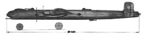

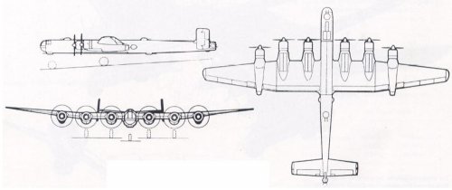

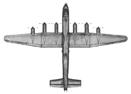

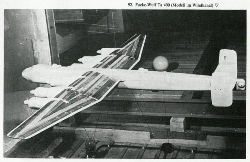

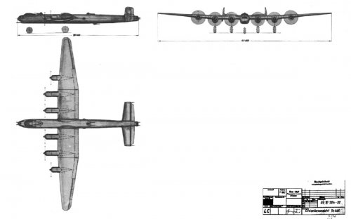

Hi Ta400 with stepped windshield cockpit.
http://www.deutscheluftwaffe.de/archiv/Dokumente/ABC/f/FockeWulf/Focke-Wulf%20Ta%20400/Focke%20Wulf%20Ta%20400%20Projekt.pdf
blackkite
May 31, 2007
8,078
4,532

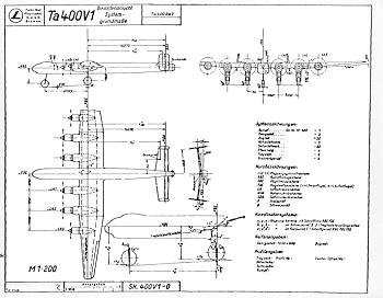

And original 3-side view.
Non step windshield cockpit was the final configulation?
https://www.youtube.com/watch?v=I1kzsxIRCME
https://www.youtube.com/watch?v=TO54tAL7RGo

Hi! Wiki says that
"In response to the RLM guidelines of 22 January 1942, Kurt Tank of the Focke-Wulf company designed the Ta 400 as a bomber and long-range reconnaissance aircraft to be powered by six BMW 801D radial engines, to which two Jumo 004 jet engines were later added.The Ta 400 with DB 603 engines was estimated to have a range of 12,000 km (7,500 mi) in the reconnaissance role, cruising at 325 km/h (202 mph).
General characteristics
Crew: 9
Length: 28.7 m (94 ft 2 in)
Wingspan: 45.8 m (150 ft 3 in)
Gross weight: 60,000 kg (132,277 lb)
Powerplant: 6 × BMW 801D 14-cyl. air-cooled twin-row radial piston engines, 1,300 kW (1,700 hp) each
Powerplant: 2 × Junkers Jumo 004 turbojet engines, 8.8 kN (2,000 lbf) thrust each
Performance
Maximum speed: 720 km/h (447 mph; 389 kn)
Range: 9,000 km (5,592 mi; 4,860 nmi)
Armament
Guns: 10 × MG 151/20 in three twin turrets, Four mounted in tail turret. 2 × MG 131/20 in two remote-controlled turrets under the nose.
Bombs: 10,000 kg (22,000 lb) at 5,589 miles. 24,040 kg (53,000 lb) max.

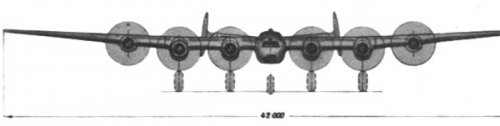

Top and middle pictures shows Ta400 with two Junkers Jumo004 turbojet engines.
Bottom picture is also Ta400? This aircraft had six Jumo222 engine(without Jomo004 jet engine).

blackkite said:
Hi! Wiki says that
Crew: 9
Performance
Armament
Ha, yes. Although almost everything in that Wiki entry is wrong. The Ta 400 started out in November 1942 as a revival of the Fw 300 project (which had been a proposed 4-engine transport) called the Fw 300A. And it was mostly designed by the French…

Focke-Wulf Fernkampfflugzeug of drawing 0310 224-31, dated March 6, 1943 (detail):
newsdeskdan
Jun 11, 2014
1,202
1,091
Re: Focke-Wulf Ta 400

The civil Fw 300 is well known . I believe , there was a military Fw 300 too , with a glased nose . Am I right ?
newsdeskdan
Jun 11, 2014
1,202
1,091
richard said:
Thank you !
Not that I've ever seen but contemporary accounts suggest that Focke-Wulf did intend to offer a bomber version of the Fw 300.

The Focke-Wulf Fernkampfflugzeug, drawing 0310 224-31 is similar to a 0310225-20, but with conventional fuselage and six engines?
newsdeskdan
Jun 11, 2014
1,202
1,091
There is a resemblance, certainly. But also many detail differences. And yes, from the other drawings in the set the Fernkampfflugzeug of 0310 224-31 is plainly what later received the official designation Fw 300A/Ta 400 (it seems at least plausible that the Fw 300A name was only used by the French designers working on the aircraft, whether they were actually in France or were among the group transferred to work in Germany. They seem to have often been given odd names and designations to work on German aircraft under, presumably for reasons of secrecy, although one contemporary account suggests that the Fw 300A was actually being worked on in France as a long-range civilian transport version of the Ta 400 away from the prying eyes of the RLM. "The work was kept secret from the RLM as far as possible," is the exact quote from report ADI.K 603/44) - with 6 x engines and a conventional fuselage. I'd love to know more about the twin boom aircraft depicted in the 0310 225-XX sequence but in the drawings I have the info panel is all but illegible.
