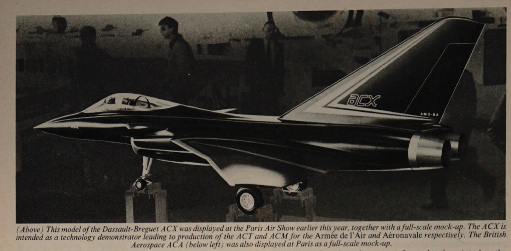

Srry mate, looks like a few pages are missing. Mind sending them again?Hi! Rafale mockup and early picture.
https://www.flightglobal.com/FlightPDFArchive/1985/1985 - 1542.PDF
https://www.flightglobal.com/FlightPDFArchive/1983/1983 - 0995.PDF
https://youtu.be/VdBuDX1BAT8?is=iFGePkEptMQGSa_V

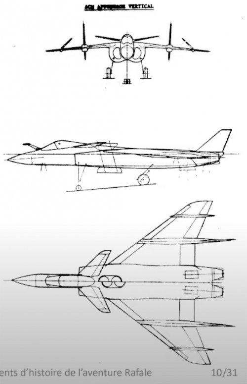

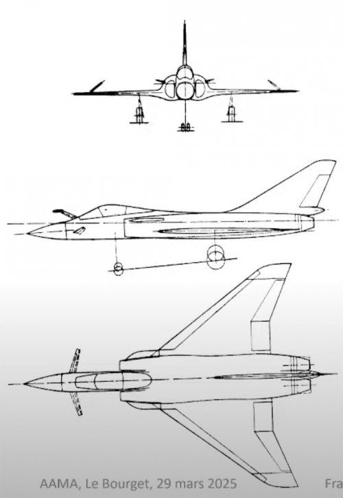

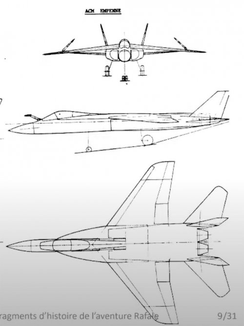

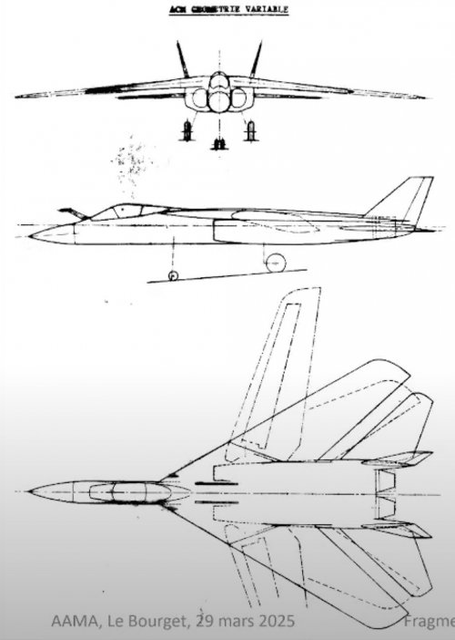

The first time I saw it was in a post on an Argentinian forum attributed to the later expelled forum member "Buitreaux"I Don't know the "Rafale D" of your drawing.
AFAIK, the real Rafale "D", for "discret", became the current Rafale C (for Chasseur/Fighter), a few more "stealth" than the demonstrator Rafale A.
Otherwise there was this old drawing, but I never found from where it came :
Thanks.The first time I saw it was in a post on an Argentinian forum attributed to the later expelled forum member "Buitreaux"
