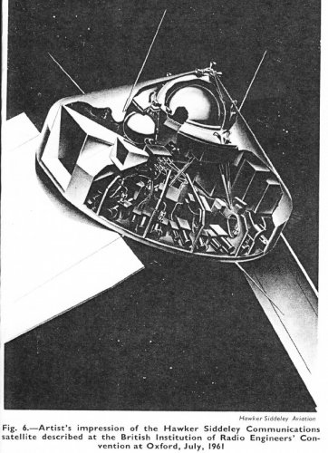

Aircraft Engineering September 1961 pages 262 - 265
Recent British Technical Progress in Aeronautics
Part Three – Space Activities
A commentary on Developments Which Have Ocurred Principally During The Past Twelve Months
By S.R. Dauncey, B.A., A.F.B.I.S., and A.G. Holmes-Seidle, B.A., Ph.D., F.B.I.S.
“Hawker-Siddeley Aviation’s satellite has evolved into a design having little in common with an earlier rather crude concept published in mid-1960. Its weight has been fixed at a level (about 500lb), such that Blue Streak, with appropriate upper stages, could launch it into a highly elliptic orbit. An advanced form of this satellite was described at the British Instituition of Radio Engineers’ meeting at Oxford in July.
The satellite proposed was a station-keeping attitude controlled, active repeater, obtaining its power from a semi-sun-seeking solar cell array and transmitting a total power of 12 watts at 2 K Mc/s, to give up to 1,000 telephone channels. Since the system is for commercial telephone traffic, reliability is important: thus, the performance figures quoted were those which should be achieved under the most unfavourable conditions. Also, very little use has been made of not yet in a practical working state, the five or so years required before the satellites would be launched being used for consolidation and life-testing rather than for the development of new components.”

Remember the TSR2 satellite com. Net cancelled with other items about July 1960.
It was originally intended that Number eleven from the production line was to be a dedicated SLV trials vehicle with dummy upper stages. To be followed by working upper stages.
They must have had an idea of size and mass these upper stages.
