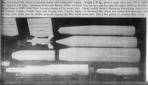

I posted the first picture some time ago but didn't know what mag or year it came from but I have found a similar picture in Interavia No 8 1959 of the 23rd Paris Airshow. The question is are the rockets to the front of the picture anything to do with Blue Streak? The display does look slightly different in the 2nd picture.

do you have any ideas about the 2 Brittannic cargo loads I posted as to what the rockets may be?
Which are they?

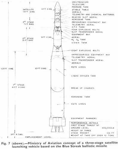

Charles Martin said that he could not find copies of drawings of the original Military Big Blue Streaks but gave me drawings of the proposed civil ELDO 4RZ2 and 5RZ2 launch vehicles and said they were just about the same and would they do?
He also gave me a drawing of a proposed Double combined Blue Streak with two engines each with at least twice the thrust of RZ2.
NOTE the launch pads 6A and 6B with the gantries were built to take these sixteen foot diameter vehicles with up to a million pounds thrust!
