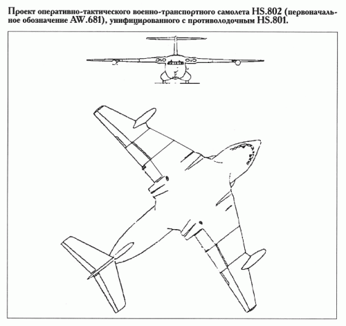

Jemiba said:
4 - The HS.802, the last attempt to safe at leat some of the development work, by mating the the 681 fuselage to the wing of the Comet 4 .
Here is a picture of it:

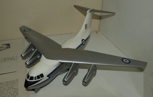

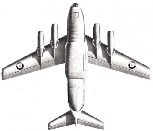

Armstrong Whitworth AW 681 STOL military transport project.
RAeS (NAL) photo from The Aerospace Professional, September 2011

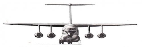

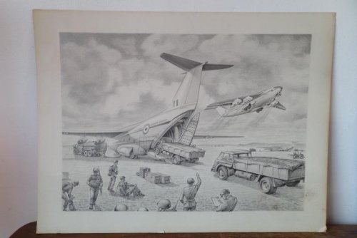

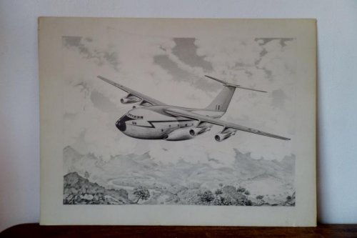

Hello,
I have recently acquired some drawings that appear to be of the Armstrong Whitworth AW681. I can only imagine that the drawings were undertaken at the Coventry factory where the aircraft was proposed to be built until the project was scrapped in 1965.
Pics can be viewed here: http://s56.photobucket.com/user/artd3co/library/Armstrong%20Whitworth%20AW%20681
I've done a little online research regarding the artist, A. G. Clench but have yet to find anything about him. I could not also find any similar drawings to compare these to.
Any additional information anyone out there may be able to provide me about the drawings/artist, etc would be greatly appreciated.
Cheers...
Lee

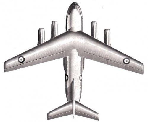

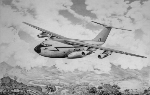

Here's an edited copy from the Photobucket original. Great quality for a digital camera photo, and beautiful artwork. Thanks for sharing!

Very nice! Thanks for sharing and welcome to this forum, casual observer.
And thanks to PaulMM for the great cleanup job!
Fantastic artwork my dear Paul.
JFC Fuller said:
Thats the Pegasus version as opposed to the finally selected Medway variant right?
Yes, Pegasus.

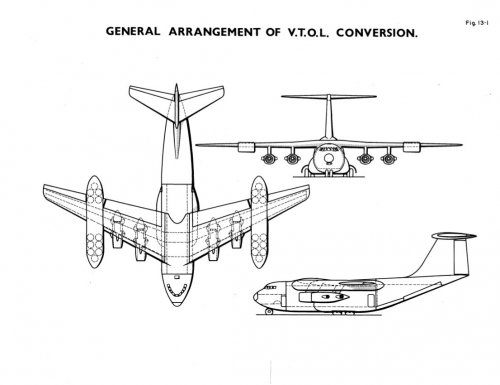

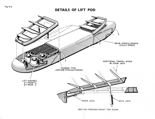

Here's the VTOL version with lift engine pods;

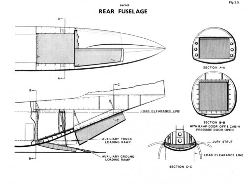

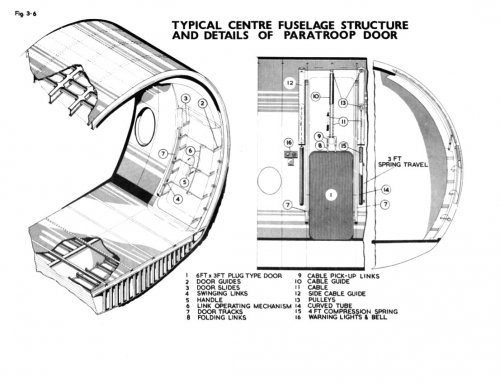

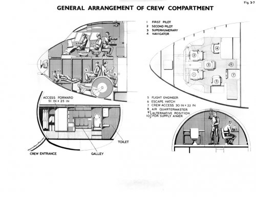

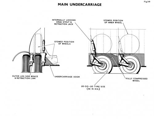

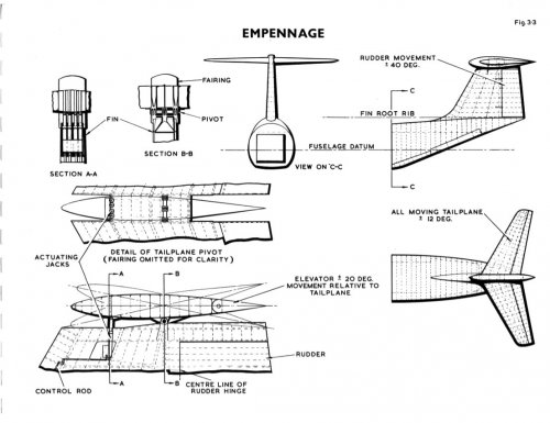

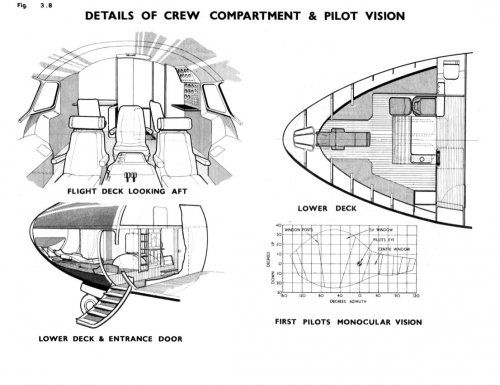

Some more detail drawings.

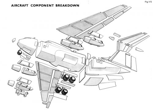

This is the same component drawing as in Mike's article but taken from the original brochure.
