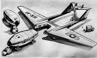

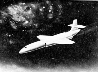

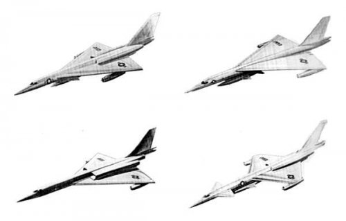

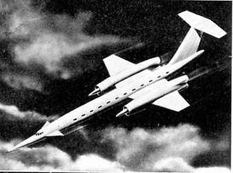

I found two Lockheed projects to start the topic
Source: Avion (magazine) January 1959
No more information given ???
I`m not sure Matej ???
In that magazine both pics are shown in the news section and the only text below it is "Lockheed Nuclear Projects". Any help to identify it will be welcome
Cheers
Antonio
The illustrations shown us by Pometabla' appeared also in
'Au dela du Ciel' of January 1960.
Illustrating two nuclear powered design conceived by Lockheed.
One civilian ,with the foreplanes, and one for military purposes.
The military aircraft was one of the preliminary
studies in 1949 for a nuclear powered bomber by Lockheed-California
under their TDD designations CL-225-263-284-286-293-313
and 319.
The research was then transferred to Lockheed-Georgia where
work was done to meet the requirements of the USAF Weapon
System 125 under a variety of TDD designations
beginning with GL-145.
Several sources but mainly:Lockheed Aircraft since 1913.
René Francillon - Putnam. 1987.

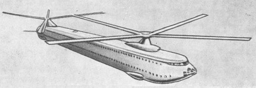

Two other examples for aircraft with nuclear propulsion:
1. A 1950s helicopter by Bell (the same problems to protect the passengers against the radiation in this two-deck configuration). (Source: „Hubschrauber und Vertikalstartflugzeuge“ by Just)

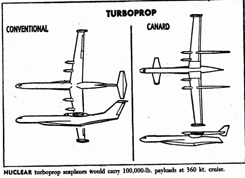

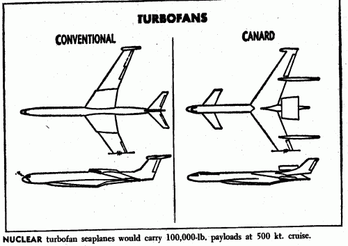

Just found, when I was searching something totally different :
Proposals for nuclear powered cargo seaplanes, either with turboprops,
or turbofans, made by J.F.Brady, engineer at Convair Division of General
Dynamics Corporation.
(from :AviationWeek, 4/1960

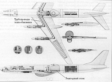

From the opposite side of the "iron wall" - some not very often seen installations of nuclear reactors on Myasischev M-30 and Tupolev Tu-114.
It was published in article The atomic aircraft: Future in the passed time by A. Y. Sovenko in Aviation and time magazine, 3 and 4/2004.

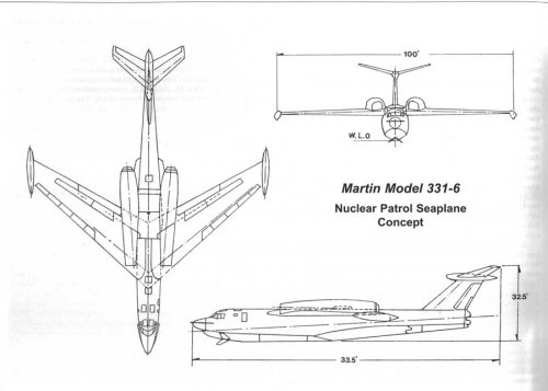

Just received the marvellous Stan Piet and al's "Seamaster" by Martineer Press.... Some VERY interesting nuclear powered seaplanes there... Just wait till this night, gentlemen.. (a Nuclear Princess model photo, too...)
This is Model 331-6, from first half of 1956. It was leghtned to house the new version of the GE AC-110 reactor with turbojet integrated in the reactor frame. From Stan Piet's "P6M".

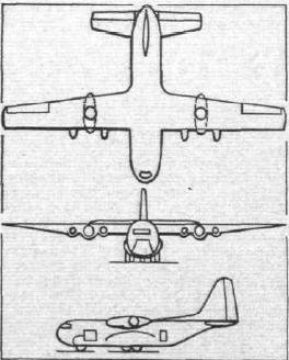

A project based on Lockheed C-130 as nuclear powered and jet engines
transport aircraft.

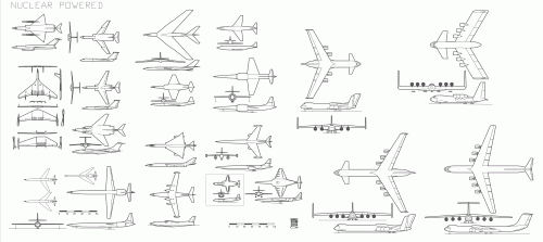

Please see the Prototypes site about nuclear powered aircraft.
http://jpcolliat.free.fr/x6/x6-4.htm

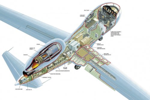

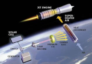

fightingirish said:
5 years ago, there was a discussion about a "quantum nucleonic reactor powered Global Hawk".
Source: New Scientist - 19th February 2003 - Nuclear-powered drone aircraft on drawing board
It's a pity that the hafnium isomer nuclear battery concept turned out to be bunk. It's a neat neat... zap a hafnium isomer with Xrays and the isomer will release up to 60 times the energy; shut the Xrays off and the reaction stops, and you're left with a *non*radioactive chunk of metal. Tur the Xrays back on and it starts up again. A wonderful concept. That nobody was able to replicate. Sigh... more "cold fusion."

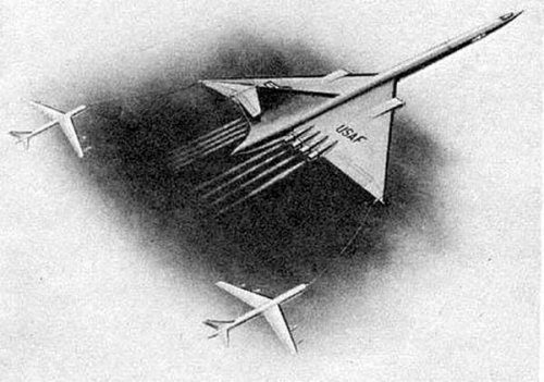

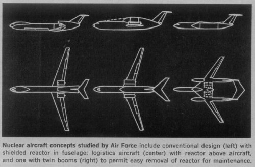

From Aviation Week october 1967, concepts studied by the USAF.As the article says,
mainly to analyze roles, nuclear powered aircraft could be used for.
Hi Orionblamblam,
can you name the other air craft in your picture? ???
Thanks and Servus
Maveric
