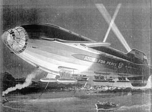

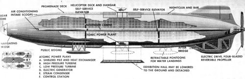

Today I had a look into "Luftshiffe die nie gebaut wurden" (Airships, which were never built),
published by the Zeppelinmuseum, Friedrichshafen. Most spectacular are the two designs from
Frank Tinsley, based on work done by Goodyear. A flying aircraft carrier from 1951 and the
better known "Atoms for peace" civil airship, which was intended as promoter for nuclear power.
For the "Atoms for peace" there's given an estimated length of about 330m, unfortunately no
data for the carrier airship. Would surely have been impressing view !

its Frank Tinsley who drew this image for the 1957 book "Airships in the Atomic Age"!
more found here http://www.darkroastedblend.com/2008/03/airship-dreams.html?showComment=1206047280000
source of picture same link

Superb finds, gentlemen! :)
Why Don’t We Build An Atoms-For-Peace Dirigible?
Here is a bold plan for displaying peacetime uses of the atom to the peoples of the world.
By Frank Tinsley (Mar, 1956)
EARLY last year, President Eisenhower asked the Congress for funds with which to build a fission-powered merchant ship for the global spread of peaceful atomic knowledge.
Source: MechanixIllustrated -Mar, 1956 - Why Don’t We Build An Atoms-For-Peace Dirigible (Mar, 1956)

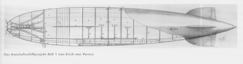

Some info about the German project "Atom Luftschiff Veress (ALV 1)".
Sources:
  • (German) http://www.zeit.de/1969/20/Das-Projekt-ALV-1-Fettes-Maedchen-fuer-fast-alles
  • (English) http://www.flightglobal.com/pdfarchive/view/1969/1969%20-%202525.html
  • (PDF, in English): http://www.agaeroplast.com/new/engl/Nigel_e.pdf

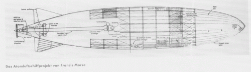

In the book "Luftschiffe, die nie gebaut wurden" (Airships, that were never built) I found three
other projects for nuclear powered airships. One from Francis Morse , drawn in 1962, and
the other from Erch von Veress, designed between 1955 and 1965. Both were designed as
passenger airships. During the sixties, Henry Irwin proposed a nuclear powered freight airship
and got into contact with the Luftschiffbau Zeppelin GmbH. Nevertheless, none of those projects
ever reached the stage of metal cutting, mainly due to problems with securing sufficient funds.

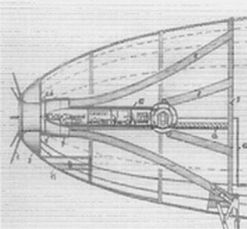

Gimme a break please. How does that infernal machinery works ? Does the nuke provide hot air to inflate the balloon ?
In the Morse design, the power plant was driving contrarotating pusher props at the extreme tail.
The ALV-1, the Veress design should use a kind of jet engine, with air fed by an intake in the bow,
and ejecting it via tubes, which ended at about one ffth of the ships length. Perhaps it should be
added, that the propulsion system and other innovations, too, that should be integrated into this
design, were seen as totally unrealistic by most experts of the time.
