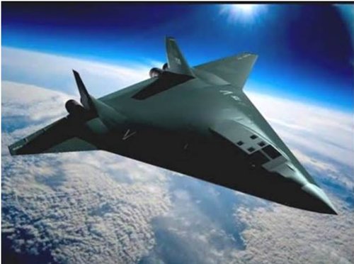

LM's proposed H-Bomber would be good start, it should be manned vs what LM proposed as Unmanned as it still needs to carry and fulfill Bone missions which include CAS. Some of the resource spent on too many Hyper projects could be spent on a manned multi-mission bomber/launcher.

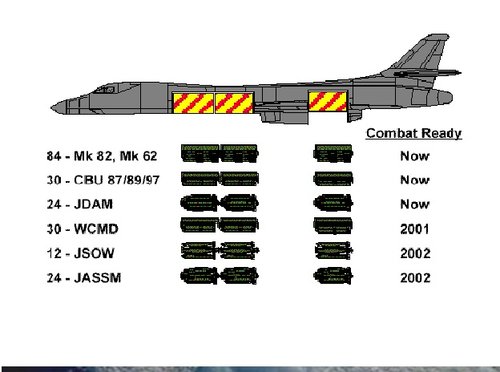

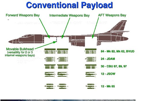

Ok, you really have to be deliberately trying to be this wrong.
1) That's not a Lockheed Martin proposal for anything. It's somebody's faked up concept art for the Russian PAK DA. I'm sure LM has some hypersonic bomber art but this isn't it.
2) Hypersonic strike and loitering CAS are two roles that cannot possibly be accommodated in one airframe. An airframe that can manage Mach 4+ cannot efficiently loiter for hours at subsonic speeds. It's not physically possible within shouting distance of the current state of the art.
3) USAF is developing a manned multi-mission bomber. It's called the B-21. That's all the money there is. Killing all of the hypersonic missile programs in total wouldn't fund another manned bomber program of any sort, much less your hypersonic loitering fiction.
1). not sure how one knows that this is not a LM version but ok.
2).Ok, but understand the beauty of combined cycle is in allows conventional jet operation.
3). Never said kill all HYpers but it has benn made clear by Congress these program are an unmanaged contractor money grab. Charge a lot and deliver cheap redundancy. The B-21 (smaller than the B-2) so hearlded as the replacement of exactly what (?) as it will not carry what a B-1 can carry and eventually the 52 will have to retire and there is no large bomber to take its place.

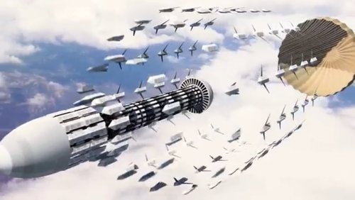

Minus the end of 'Sequestor' ie the Democrats out of office and a $900B NDAA, transports make the most sense.
