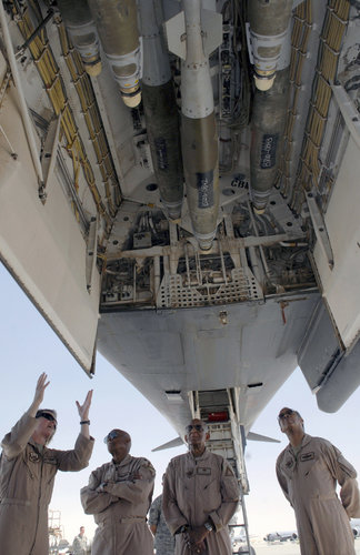

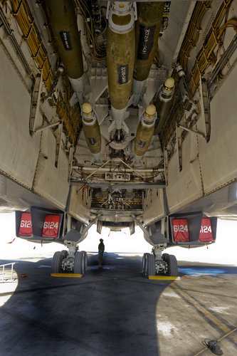

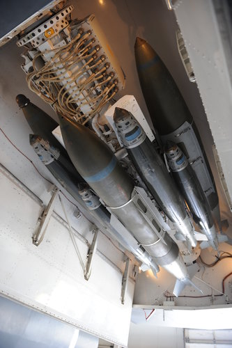

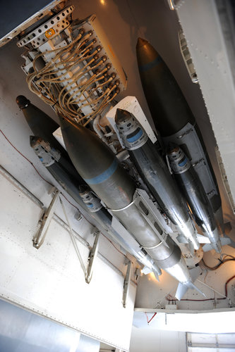

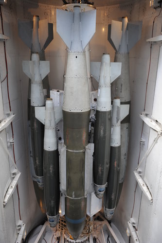

Josh_TN,
Here's a few pictures to give you an idea of GBU-38's on a 10 by and on the rotary adapter. The first are 10 bys and the later are on rotaries. All pictures from the AF, either AF website or the Eglin wing.

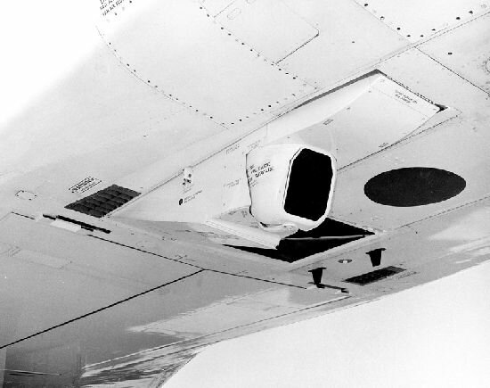

Never knew, that a prototype of the Rockwell B-1A Lancer had a retractable FLIR turret. o_O:cool:
View: https://twitter.com/clemente3000/status/1352084159536226306?
Dear members or mods,
if this post is in the false topic, please let me know, so I can delete or move this post to a more suitable topic like the topic AMSA Program & B-1 Bomber projects.
Here's an - albeit low resolution - photo from the San Diego Air & Space Museum (SDASM) Archives of the Electro-Optical Viewing System (EVS) turret posted at Flickr.
View: https://www.flickr.com/photos/sdasmarchives/4555988269/sizes/o/

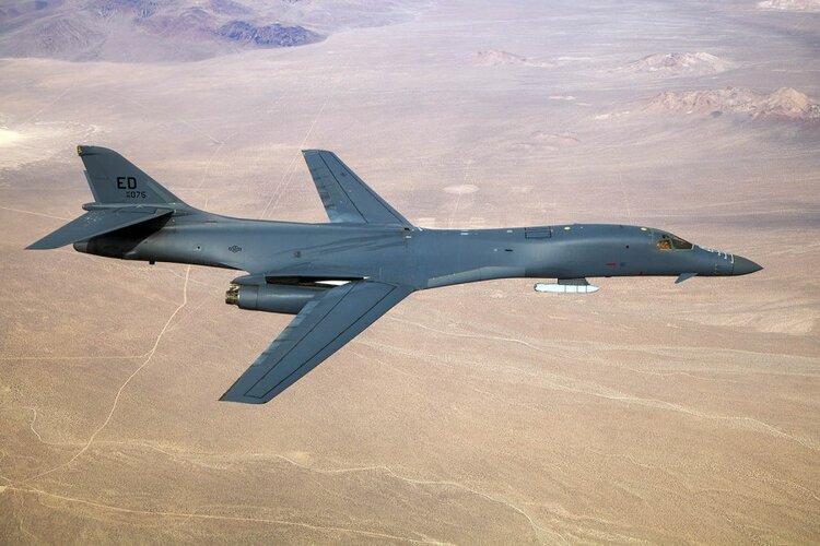

Quick question - why did they swap sides on the Sniper pylon mounting? (The Sniper & pylon were mounted on the left side of the fwd weapons bay on the test install on a/c 075 and on the right side on the production installation.)
You're guess is as good as mine. It was always on the right side when I was around, off course it's been over 13 years since I was around, so things change.
