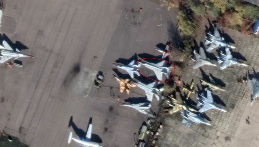

Wonder where the Mig 31M is now?
Photo of My favorite piggy or King Kong?
that can't be found really this days on the web ( cause the restrictions etc.) it's funny how little do we know about Izdelie 05 05m
and 05bm ( aka mig-41 ) as one kid with a mask once said there are genetics of an interceptor that can't be ignored so...
Everyone for the past 30 years seams to copy paste the same information over and over again but in the end of the day it's the lost first 5th gen fighter of the Soviet/Russian era not MFI nor PAKFA that's the answer to the whole stealth mania that started in the 80's a b737-200 flying at Mach 3
Ps. if you look closer at airport ispitatelni (its in the links of paralay post of Google maps ) you may find that something is missing

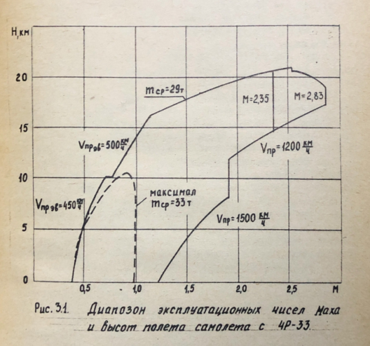

Interesting to see the speed time limits.
3 min at Mach 2.83, 15 min at Mach 2.65 - 2.83, 15 min at Mach >2.35.
These values are with R-33 missiles only.
When carrying R-40T/DT, max speed is Mach 2.35.
When carrying R-60M , 8 min max time at Mach 2.2, 60 minutes at Mach 1.75.
In addition, the flight management manual indicates that Flights at speeds of more than 1250 km/h, on the numbers Mach ›2.65, and
also at speeds of more than 1000 km/h at altitudes below 3000 m you can make only by special permission.
In 1985 one MiG-31 from the 530th Fighter Aviation Regiment of the Air Defence Army flew from Chuguyevka air base (Far East) to the Dolinsk-Sokol air base on the Sakhalin island ( 777th Fighter Aviation Regiment) with constant cruising speed of 2500km/h at alt of 21500m armed with four R-33 and two R-40TD. Distance? About 1000kms.

Given this is in actual manual and its not for a naked airframe but and armed one it seems M =2.83 was definetly flown on the regular. But M-2.35 seems to be the 'economical' daily driver speed.

the graphic shows the operating range minimum and maximum speed at certain altitudes as stated at the previous page, on the next page (50) you can read the operational limitations with other loads the maximum temperature shouldn't exceed 290C M=2.83 for more than 3 mins for the airframe but for the R-40 and R-60 is 1200km/h the limitation is imposed by the attachment points i will check about any info in another flight manual about izd.01 and report back

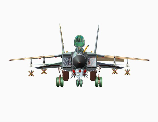

Landing gear looks off
