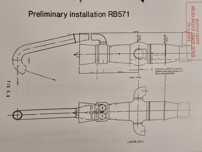

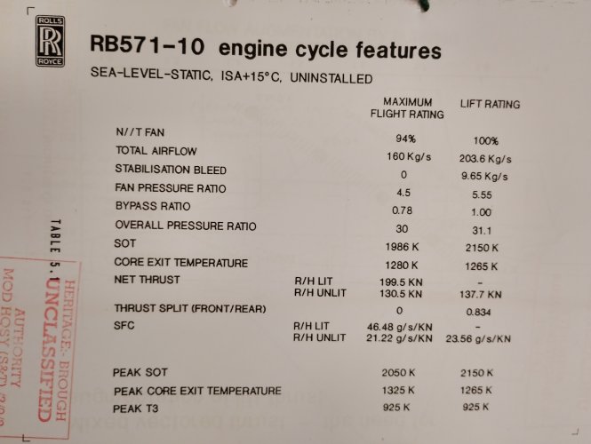

I've had some RB571-10 material declassified. See attached.
The UK drew various designs around this engine in 1989, some more like the designs
@stever_sl posted than others.
Peter Calder spent a few years pushing the idea of a five-nozzle Pegasus, with a ventral nozzle added that was used in vertical flight to kill the hot gas fountain. The RB571 is, sort of, an extension of this idea. The Harrier design team at Kingston saw some issues in designing a Harrier variant around the five nozzle idea though (basically, another big hole in the structure was not easy).

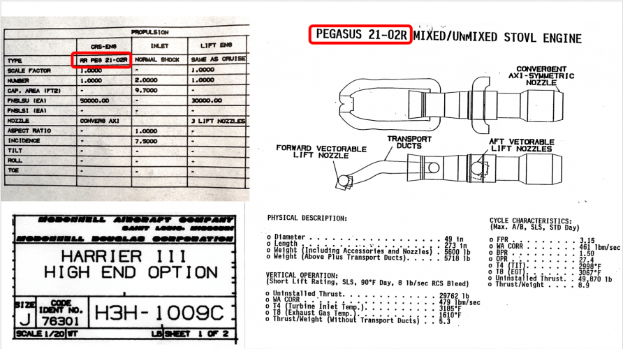

Some of this story is told in my book (
www.jumpjetpenguin.com). It all relates to the US/UK ASTOVL studies and the shock the UK suffered when they saw the McDonnell 'cactus' engine design from St Louis. See
https://www.secretprojects.co.uk/th...d-mcdonnell-bae-astovl-entry.2219/#post-18661
