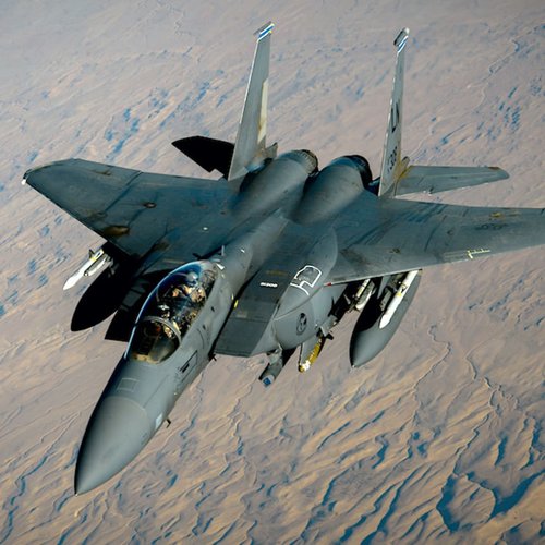

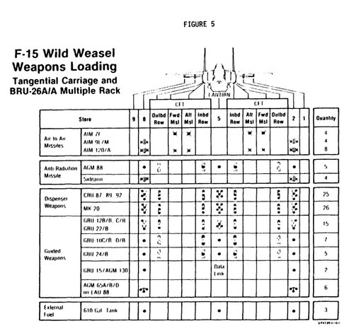

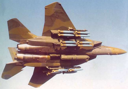

Possible F-15G could load lots of HARMs !
Just one in that picture (two assuming the other side is loaded symmetrically). The shoulder stations have Sparrow, not HARM. Being a foot longer and two inches wider than Sparrow, HARM is probably too big to mount on the shoulder stations.
  • Like
Reactions: PMI

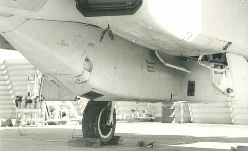

The chin pod played hell with the directional stability of the aircraft - a friend was heavily involved with the testing and commented on that. In the end, the F-4G carried on and the F-16C/D Block 30 and later CJ/DJ picked up where the F-4G left off.
Enjoy the Day! Mark

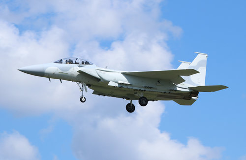

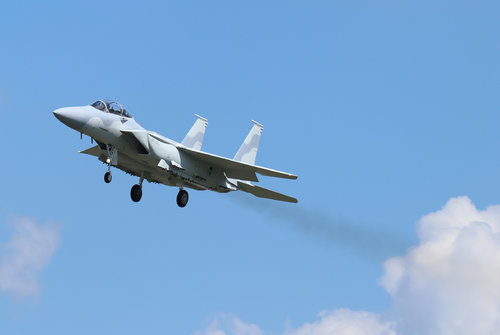

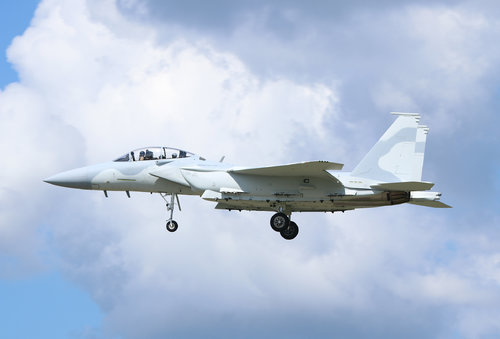

Footage from inside cockpit of Qatar Emiri Air Forces F-15QA during first flight.

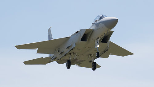

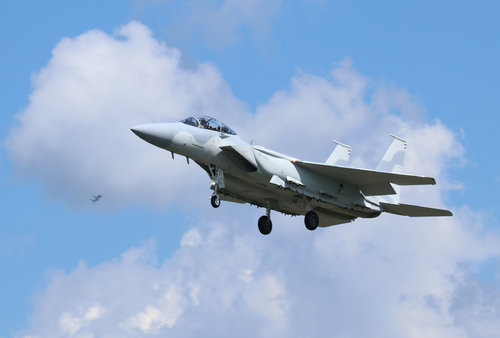

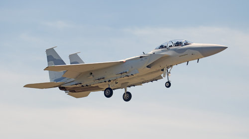

Here's a couple of pics of QA#2 (17-0002) I took last week as it was shooting approaches at Lambert Field.
Enjoy the Day! Mark
