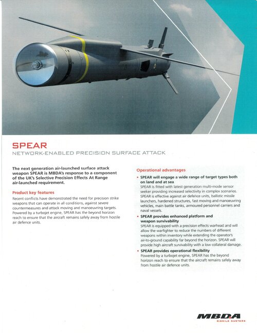

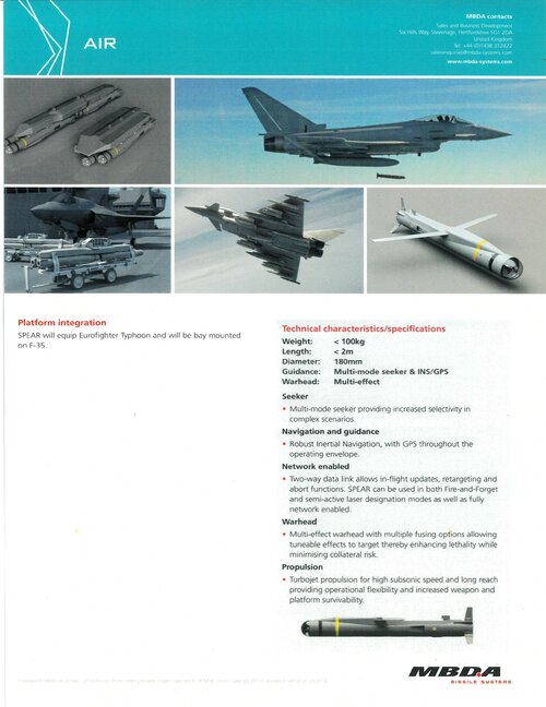

Good Day All -
We don't have a SPEAR dedicated thread save for a proposed EW variant. Moderators, if you think there is enough in this thread to start one, have at it.
A SPEAR cut sheet from the recent Tailhook Convention.
Enjoy the Day! Mark
Enjoy the Day! Mark
this is already on their website I think

But good to capture here for when it is inevitably taken off their website in a redesign.
