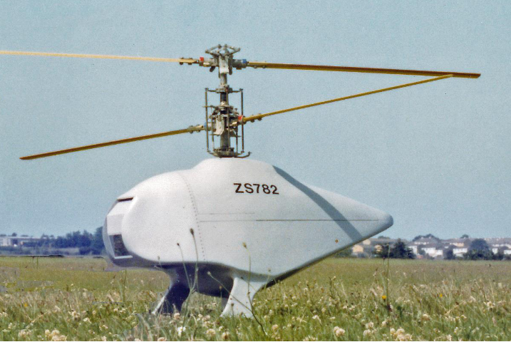

No reason they couldn't just put a sensor ball on a Lynx or if they really needed NOE attack capability.
One of the goofy Westland stealth helicopters would have been the better buy in terms of performance.
In terms of necessity, more Chinooks I guess?
That goofy PHOENIX robocopter is the best boy though he is absolutely precious.
