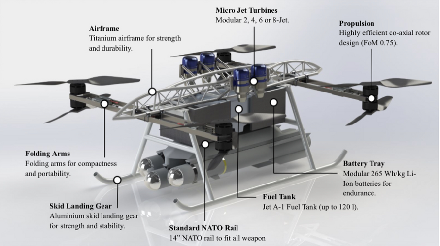

New Brimstone platform just dropped....
View: https://twitter.com/BritishArmy/status/1701650127708991616
View: https://imgur.com/vbunSwP
Using a British Hydra UAV...which uses a jet turbine unlike the previously seen Malloy T-650.

On display at the British Army’s stand at DSEI will be the Hydra 400 drone alongside an Aether mothership.
The Hydra 400 is a pioneering new generation of heavy lift drone using hybrid propulsion technology. Compact and portable, the drone can be transported in the back of a Hilux or similar and assembled ready for flight in six minutes.
The drone is powered by single spool jet turbines, producing 500N (50kg) thrust providing a maximum lift of 400kg.
Ministry of Defence (MoD) funding will be needed for Hydra Drones Ltd, the company that developed Hydra 400, to progress the concept.
It is proposed that the Hydra 400 carry a lethal payload, the Brimstone missile developed by Stevenage-based MBDA, which is the strategic partner to the MoD for complex weapons
The Brimstone missile weighs 50kg, is 1.8 metres in length and has a 180mm diameter. It is guided by millimetric wave radar and semi-active laser.
Brimstone offers ‘one missile, multi-platform’ versatility and is designed to be integrated onto helicopters, fixed wing aircraft, including fast jets, land vehicles, naval platforms and unmanned aerial vehicles (UAVs).

Hydra 400 is a big drone, Brimstones are ~100lbs/45kg each
HYDRA 400 has a payload of 400kg over 25 km, supposedly. It's interesting in having a hybrid propulsion, with Jet-A powered microturbines as well as electric rotors. I assume it needs the turbines with that heavy payload but can get home on the electric motors once the payload (and jet fuel) are expended.
