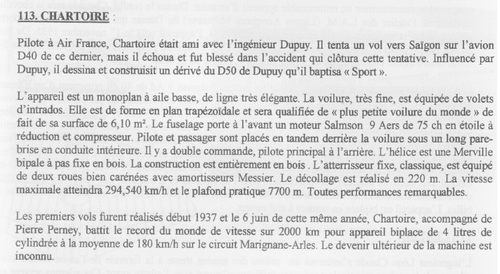

Is anything known about the second, low wing S.M.A.L. monoplane (mentioned in the 1946 advertisement), beyond it being a single seater and powered by a 35hp motor?
From TU 288,
need translate.
