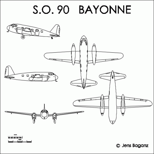

The SO.90 Bayonne, name is given as "Cassiopée" in other sources, wasn't just a project !
The prototype made its unannounced maiden flight on 16th August 1943, under
the surprised eyes of the italian guards, when Maurice Hurel, together with 8 others,
used this aircraft for the escape to algeria. Later development of the SO.90 were
the SO.93 and 94 Corse.

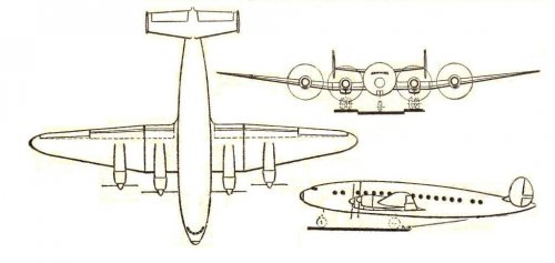

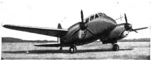

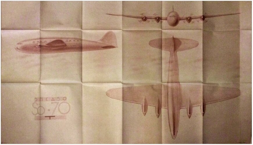

Dear Boys and Girls, here is an article in French about the SNCASO Sud-Ouest SO.70 transatlantic airliner from 1945 which remained a "project". It looks like a fat Lockheed Constellation or a scaled-up SNCASO Sud-Est SO.30 Bretagne but appears to have avoided the mistakes made with the latter's mid-wing layout. It was to be powered by four Gnôme Rhône GR18 18 cylinder radial engines and was a design contemporary of the SNCASE Sud-Est Se.2010 Armagnac......
The article comes from the 9th March 1957 issue of Les Ailes......
(Moderators, should this be in the post-war section? I cannot tell if the design was started before the liberation of France......)
Terry (Caravellarella)
  • SNCASO Sud-Ouest SO.70 airliner project 3-view - Les Ailes - No. 1,623 - 9 Mars 1957.......jpg
  • SNCASO Sud-Ouest SO.70 airliner project - Les Ailes - No. 1,623 - 9 Mars 1957.......jpg

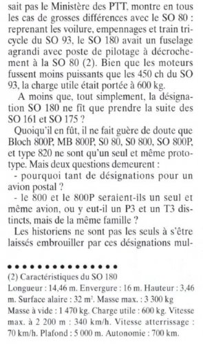

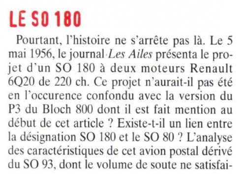

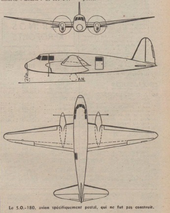

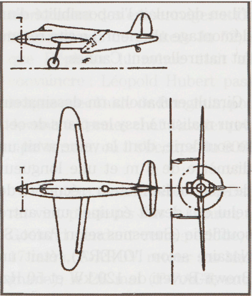

the SNCASO SO.180 was a project of 1956,a three-seat light transport aircraft,developed from SO.80,powered by two 220 hp Renault 6Q20 engines,and here is its data from Le FANA issue 333.

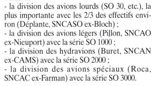

Also here is the SNCASO 1000,2000 & 3000 series origins;
1000 was SNACO ex-Nieuport
2000 was SNCAN ex-CAMS
3000 was SNCAC ex-Farman

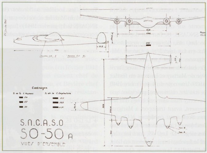

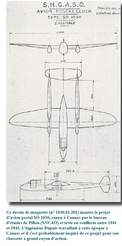

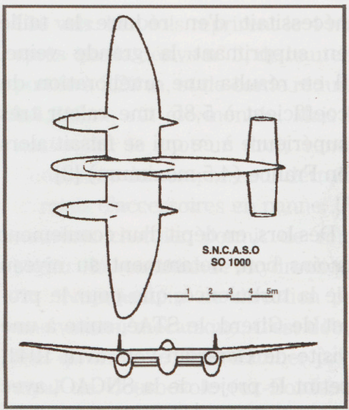

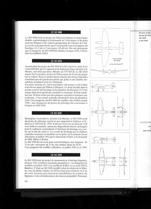

SNCASO projects SO-50A, SO-1000, SO-1020 & SO-1030
Scource: Pégase n°115, January 2005
Nice find my dear Retrofit,
and from the book; Nieuport 1909-1950.

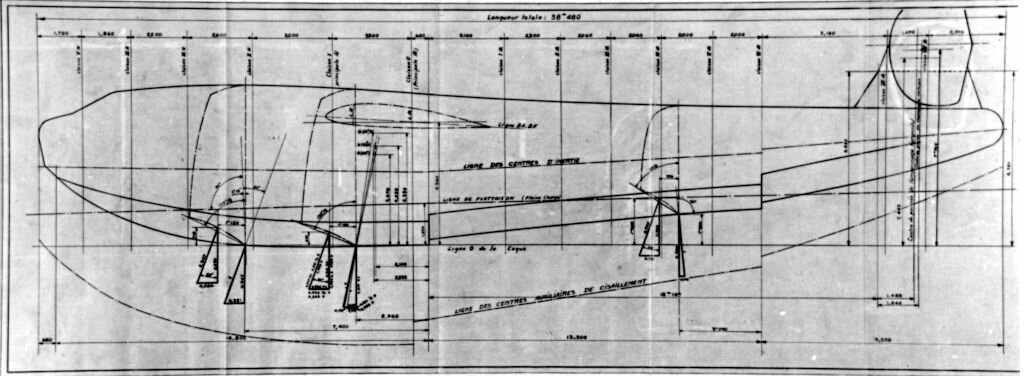

I have got a big series of plans from SNCASO about the war time studies for huge flying boats. The attached sample shows the SO-2010.
OH my God,many thanks,can you send more,we know about this stuff;
SO.2000 was a transport seaplane Project on floats,powered by four engines
SO.2010 was a military seaplane version of SO.2000,powered by four engines,Project
SO.2011 was also a military seaplane Project,based on SO.2010,powered by four engines
SO.2020 Barfleur was a high-wing large flying boat monoplane Project,powered by six engine,need confirm
SO.2030 was a flying boat Project of 1943,no more Info
SO.2040 was a flying boat Project of 1943,no more Info
You can also add the SO-2050 in your list: an after-war surveillance seaplane ordered in 1946, as shown attached.
