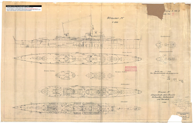

It's been a long while, but I combed through the archive for new plans. Today is for KM ship plans specifically. Quite a few were found, some already known and posted, but all are now in the share drive for convenient access.
Included are plans for:

- Kreuzer M (1 plan)

Not all of these plans are immediately of interest or groundbreaking in any way. A few of the sub-10 plan ones consist of nothing but crane drawings or living accommodation specifics, to give a couple of examples. Perhaps that is your thing, but I suspect most do not find it of particular interest.
The Fzt. Graf Zeppelin/B plans are of much use in the playing of "hangar tetris". There is a "plan" with a series of tables giving specific detail to the armor arrangement of the Admiral Hipper-class within the new Prinz Eugen plans. Kreuzer M's sole new plan is of its Vulcan gearbox used for the four M12Z 42/58 engines on the center shaft. Of interest to me is a 1939 Type 1936A plan that shows a "simplified" version of the Drh. L. C/38 turret that you see on other plans like that of the Type 1938B, Kolonialkanonenboot, and some Type 1937 drawings - and Schlachtschiff O, of course.
I will be making dives into other areas (e.g. RM3) later on.

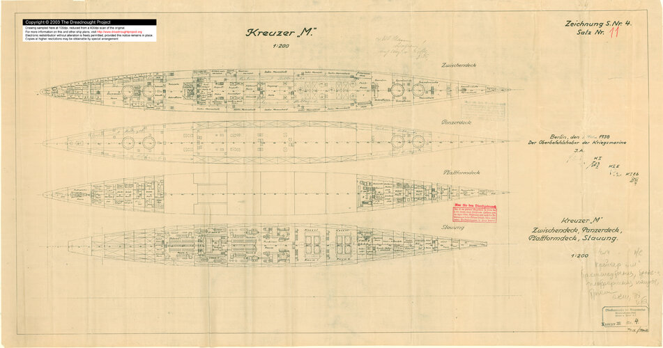

Kreuzer M.

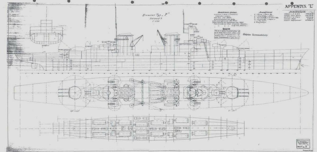

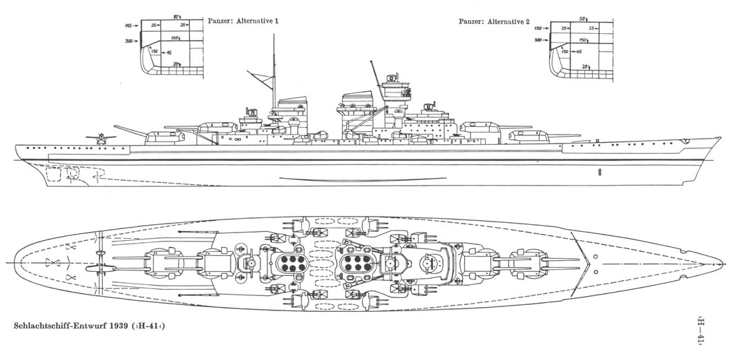

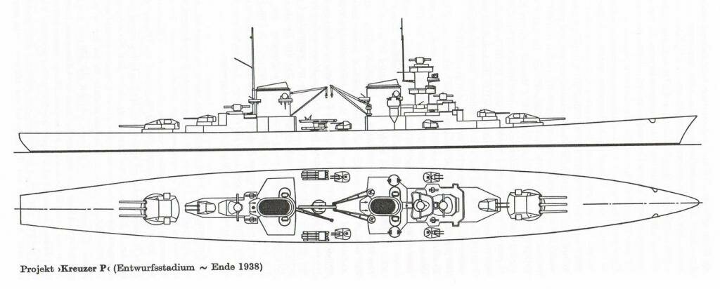

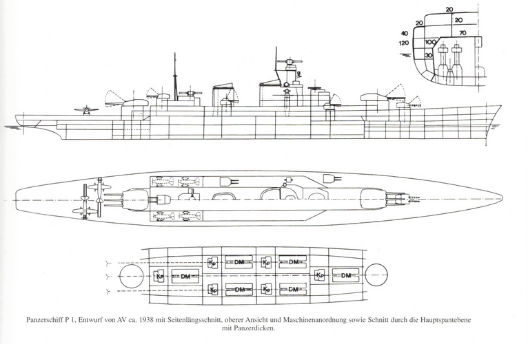

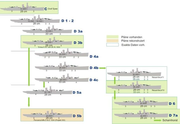

Is there a scharnhorst preliminary with 35 cm - 35.6 cm main guns? I remember reading somewhere that there was. If there is can I have more information on it? Danke
Thank you so much. Funny how the third draft depicts the P class with a dual deck mounted catapult instead of the single rotating one depicted one most designs.
There's one, presumably the "Neuentwurf I" (New Design I), instead a purposely built to armed with 6x35cm it was an up-gunned proposal from 9x28cm, the designers are refers the already available 28cm and new potential 33cm which will put "D" and "E" on par with French battlecruisers.
You should read this 2007 thread, it will give you some insights about Scharnhorst-class evolutions, i saved this Scharnhorst-class evolution pipeline (from @_Sarcasticat_ ) in case image link broken, those projects marked in green box meaning these have existed blueprints from bunderachiv, i only have D3b, D6 and D7a, no luck on Neuentwurf II
You should read this 2007 thread, it will give you some insights about Scharnhorst-class evolutions, i saved this Scharnhorst-class evolution pipeline (from @_Sarcasticat_ ) in case image link broken, those projects marked in green box meaning these have existed blueprints from bunderachiv, i only have D3b, D6 and D7a, no luck on Neuentwurf II View attachment 735645
These designs first became widely known from Wilhelm Hadeler's article "Projektskizzen von Flugzeugschiffen der
Kriegsmarine aus dem zweiten Weltkriege" in the Jan-Feb 1972 issue of the journal Marine-rundschau. In recent years, we've seen the actual KM drawings become available. If you poke around this thread a bit, you'll find them.

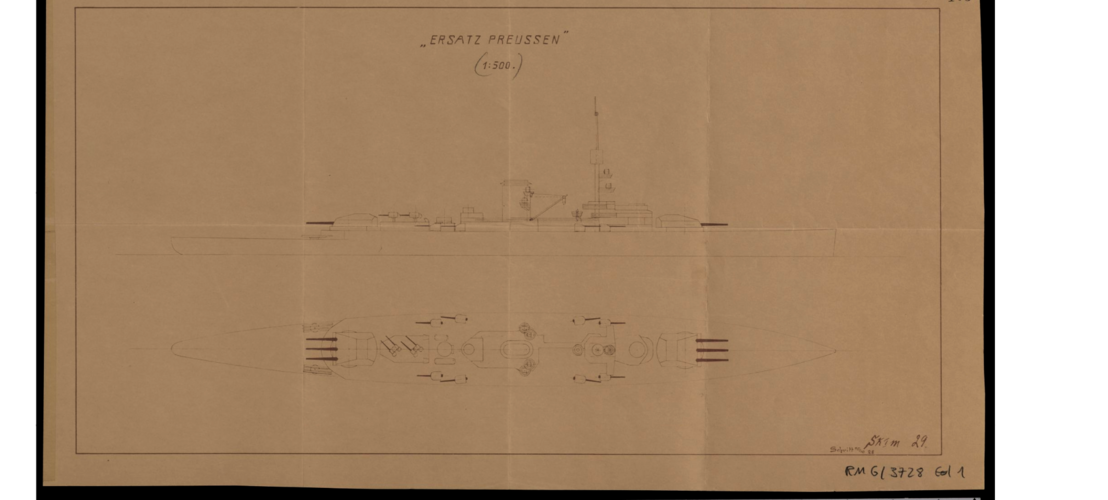

Also, here's the slightly better quality of panzerschiff "A" ("Ersatz Preussen"), the two twins mounted super-firing over her aft 28.3cm turret are the short-lived SK C/25 8.8 cm/L75 flaks.
You'll see "A, K, M Wa or Gkdos or A I or IV or Ob.d.M" often in German archives, those are shortened name of German Naval Departments, offices, committees and high command within OKM (Oberkommando der Kriegsmarine), these departments have their respective folder archives on Bunderarchiv.

I suppose the big thing I wanted to do here was a prospective poke at what one of the Deutschlands (I was thinking Admiral Scheer) might look like "unleashed", being given the full treatment of the various prospective rebuild ideas (including the special plans I made reference to in one of my earlier posts which detail a 1938 re-engine series of proposals), but at this moment I just don't have the time. I'll have to edit it just like I had to edit the Gneisenau Rebuild one - and that doesn't just apply for this section, there's stuff I know I'm missing from the diesel history section above (including some fact checking) and it almost certainly reads like crap so it will need to be restructured as well.
I won't leave you empty-handed and blueballed of course, so here's what I have in mind:
Umbau-Panzerschiff "Adm. Scheer" (Rebuild 1940 to 1942, stats will reflect ship in 1945)
Increased length and beam (750t)
Modified battle-mast to tubular-type.
Re-engine to two quad sets of V12Z 42/58 engines with improved motor foundations.
Raising bulges to weather deck level.
Various improved models of sensors
Giving shields to AA
Unifying secondary battery to 12.8cm SK C/34 in Drhl. C/38 twin turrets.
Other small items of interest noted in the rebuild plans.
Thank you for your time and I hope that you will come by and check the edited version at a later date. It'll be better, I promise. Maybe.

There's also 5 pages mentioning M-class cruiser with 17cm guns on RM/20 haven't translate it yet, but M.J.Whitley German Cruisers of WWII stated there was a proposal in 1938 to arm M-class with 17cm guns, but was dropped because the increasing weights.
Thank you for sharing about Whitley, he also mentioned the shipyard designs for Kreuzer M——Seeadler, Motorkreuzer, Wehr Dich and Totz Alledem. Can you provide the document number in RM20?
RM 20/1138 Titled "Kreuzer "M" 1938", document pages are 175 to 180.
You can also check RM 6/60 "Der verlauf der entwurfsbearbeitung des kreuzertyps “M“" pages 27 to 39, "Wehr Dich" are mentioned in here if i recall.

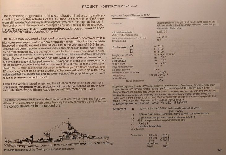

Does anyone have information on the Type 1936D/E destroyers (designed near the very end of the war, as a predecessor to the Type 1945)
All I know is this blurb from Lesta (possibly quoting Breyer, I'm not sure how to work through the mess of sources in that article):
"Projects 1936D / 1936E had a fourth 127 mm turret and a second stabilized command and control post with a FuMO-213 fire control radar on the bow superstructure. Having supplemented the armament with the latest 55 mm and 30 mm anti-aircraft guns and having redesigned the power plant, German engineers designed a universal destroyer, which received the Project 1945 index . However, the Third Reich no longer had the time or opportunity to build ships of Project 1945 , it was 1945..."
and that "the designers of the Kriegsmarine design bureau , on their own initiative, finalized the 1936D / 1936E project with enhanced armament and an improved steam turbine power plant."
Basically it seems the Type 1945 is just a modernization of the Type 1936D/E projects.
Edit: found the relevant section, albeit in German
