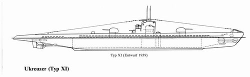

To my knowledge (and to that of Erich Gröner), the biggest submarine designed for the Kriegsmarine was the "U-Kreuzer" Typ XI, which
nevertheless wasn't much bigger, than about half size of the I-400. For the kind of missions and the areas, German Uboats were designed
for, very big probably wouldn't have been an advantage.

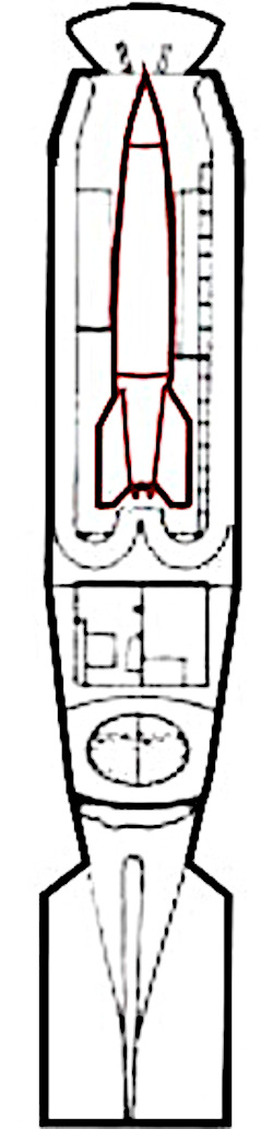

And the plans for attacking the USA with V2 rockets, were made around towed launch containers.
https://www.secretprojects.co.uk/threads/prüfstand-xii-submarine-launched-v-2-rockets.9651/
(drawing from Erich Gröner "Die deutschen Kriegsschiffe 1815-1945", volume 3)

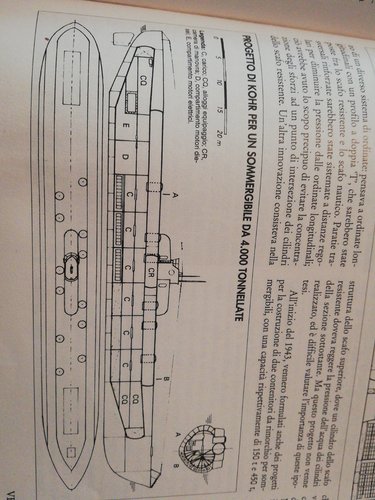

Largest sub designed by Germans in WW2 was a 4000 ton cargo submarine, a 1943 project by eng. Kohr with multiple pressure hull a length of 93 meters and a width of 11 meters. Still considerably smaller than I-400 class. Something larger was studied during WW1 in the context of cruiser-submarine experimentation. However Regia Marina had actually a mid '30 plan for a much larger submarine, a 10000 ton submarine oil tanker to evade naval blockade 15622260149613431595259235424215.jpg
