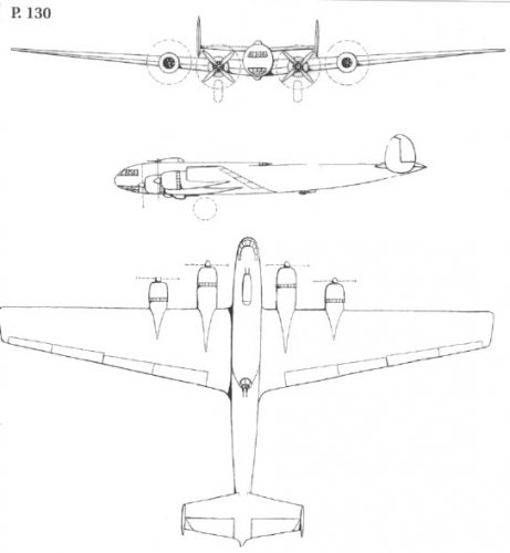

Circa late 1942 Ing. Casiraghi, chief designer of Piaggio, worked on a project fro an high-altitude pressurized long range bomber. P-130 was powered by 4 Piaggio P XII RC 100 A DB-605 located on top of the bomb bay drove the compressor. Defensive weapons were two revolving turrets Breda Z on the upper airframe and a Breda X1 in the belly. All were remote controlled. Offensive weapons were up to 10 middle weight bombs (250 KG each). Project was low priority P-133 was judged more important. Source Aerofan /65 second quarter 1998

Yes, two years gone.. ;). But I still have something, just have to find it. And BTW, do you like the P.130 AKA "The Italain Superfortress" ? ;) ::)
From one drawing the lenght was sligthly more than 34 meters. But I'm confident to take hold on an original drawing, with quotes.
Because it was ready for production. The P-133 was ordered (24 in total) and work was started on the first batch of 6. As I said, it was an evolution of the P-108, technologically. The P-130 was a different kind of effort (Piaggio spent little more the 500 man-hours on it). SPEAKING IN VERY RELATIVE TERMS (EMPHASYS !!!) for Italian industry it would have been the same step done by the US in going from the B-24 to the B-29 (now, if someone writes that the P-130 was the "Italian B-29" I'll simply kill him... ::) )

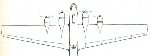

The Piaggio P.130.
https://forum.warthunder.com/index.php?/topic/197858-progetto-tech-tree-aerei-italiani/&

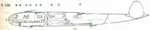

Apertura alare di 38 metri ( 7 piu del B-17 ) ...4 motori P.XII RC 100 ...piu' un DB605 solo per gli accendisigari e la pressurizzazione della cabina ..3 torrette binate per la difesa e carico da 5 tonnellate (10x500kg) ... Puntamento tedesco
Fed this to google translate ...
Wingspan of 38 meters (7 more than the B-17) ... 4 engines [Piaggio] P.XII RC 100 ... plus a DB605 only for the cigarette lighter and the pressurization of the cabin ..3 twin turrets for the defense and loading from 5 tons (10x500kg) ... German gunnery control

I suspect that the DB605-driven compressor supercharged the engines as well as pressurizing the cockpit. It looks like German HZ-Anlage equipment, as used on the Hs130E and Do317. In fact, with its Germanic remote armament, the project looks rather like an entrant in the German Bomber-B competition.
Sospetto che il compressore azionato dal DB605 sovralimentasse i motori oltre a pressurizzare l'abitacolo. Assomiglia all'attrezzatura tedesca HZ-Anlage, come quella usata sull'Hs130E e sul Do317. In effetti, con il suo armamento remoto germanico, il progetto sembra piuttosto un concorrente nella competizione tedesca Bomber-B.
i sistemi di puntamento remoto delle torrette non erano di tipo tedesco ma di progettazione Piaggio derivati dai sistemi di puntamento remoto del P-108B
English, please.
Via DEEPL. "the remote turret targeting systems were not of German type but of Piaggio design derived from the remote targeting systems of the P-108B".
The dorsal turret (the one pointing backward) seems to be the very same Breda Z2 exploited also on the P-108B.
I think that there is some mistake about the term "targeting system", that should be translated better into "pointing system".
The P-108B (and SM-82 Bombardiere) had a semi-automatic pointing system (similiar to the American Norden but less effective) developed by Jozza.
This one:
I totally agree, it would be insane to use a DB605 only for cabin pressurisation! Using a seperate charing engine avoids many complicate super charger drive trains and a smooth continously supply of charged air. It could also heplp to reduce drag by placing the charge air cooler in the fuselage.
Yes, I know. I was not suggesting that the Piaggio airplane actually was a Bomber-B competitor. I only pointed out the conceptual similarity.
