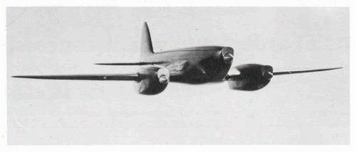

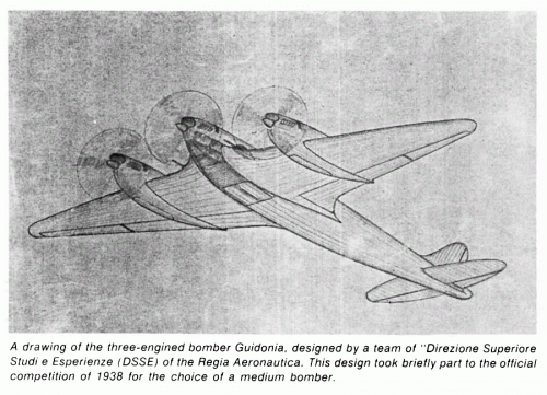

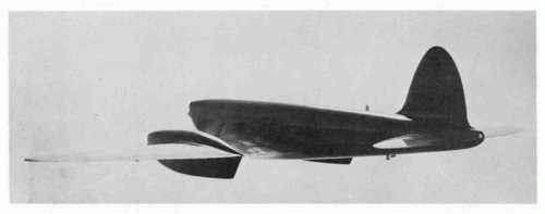

While browsing through magazines I came across an issue of the Italian AeroFan with this unknown project for a three-engined high-altitude bomber, the Guidonia I, studied in 1938 by the Regia Aeronautica's DSSE (Divizione Superiore Studi e Esperienze). According to the article, the design briefly took part in the official 1938 medium bomber competition against the projects of established companies such as Caproni's Ca.320 and 325/bis, Savoia-Marchetti's SM-89, FIAT-Aeritalia's BR.30, Breda's Ba 99 and Macchi's MC 300, although as part of a "second list" of "outsiders", along with the Cant Z. 1018.

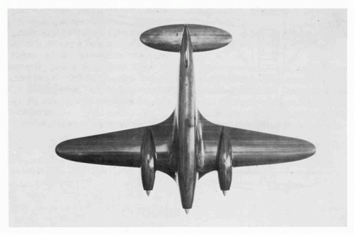

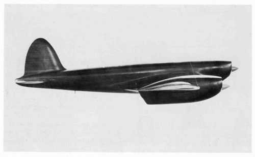

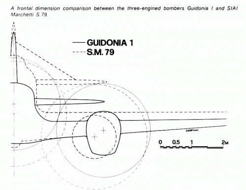

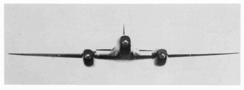

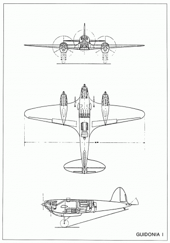

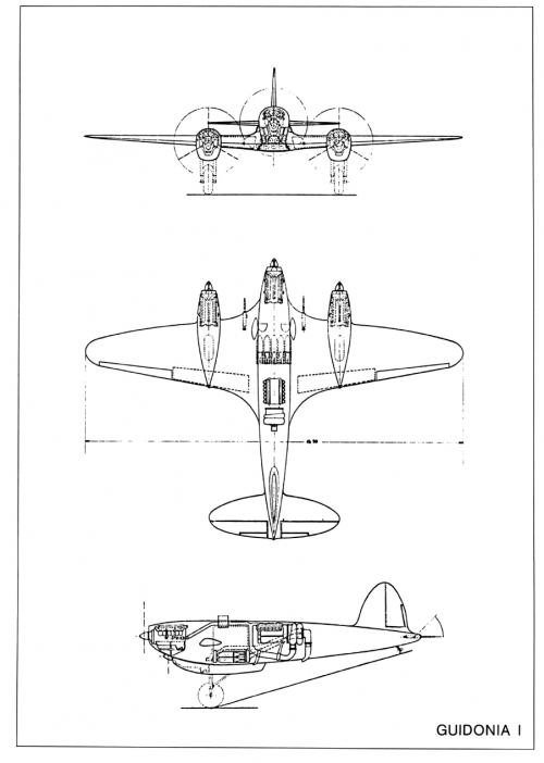

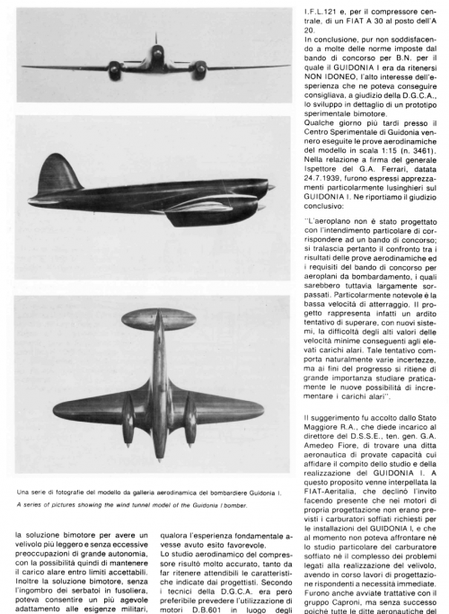

More pics of the wind tunnel model, a diagram showing comparative sizes with Savoia-Marchetti's SM.79 and a three-view arrangement:

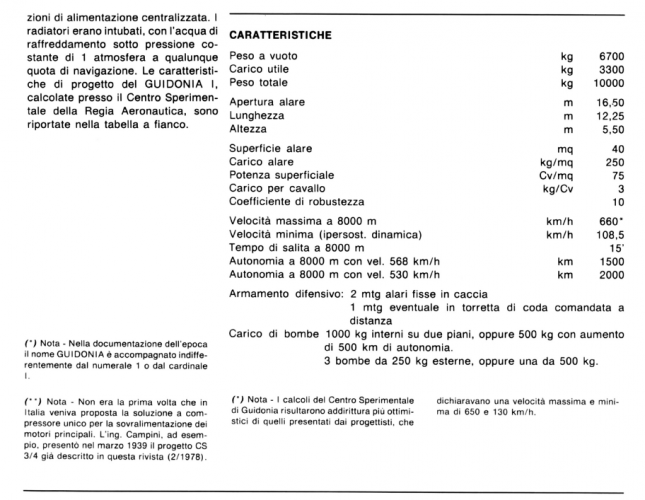

Technical characteristics
Weight:
  • Empty weight: 6700 kg
  • Payload: 3300 kg
  • Total weight: 10000 kg (10 tons)
Dimensions:
  • Wing span: 16,50 m
  • Length: 12,25 m
  • Height: 5,50 m
  • Wing area: 40 m²
Performance:
  • Wing loading: 250 kg/m²
  • Power: 75 hp/m²
  • Load factor: 3 kg/hp
  • Strength factor: 10
  • Maximum speed at 8000 m: 660 km/h
  • Minimum speed: 108,5 km
  • Time to reach 8000 m: 15 minutes
  • Range at 8000 m with 568 km/h speed: 1500 km
  • Range at 8000 m with 530 km/h speed: 2000 km
Defensive armament:
  • 2 machine-guns in the wings
  • 1 optional machine-gun in turret, controlled from cockpit
Bomb load:
  • 1000 kg in two layers, or only 500 kg for a 500 km increase in range
  • 3 external 250 kg bombs, or only one 500 kg bomb
