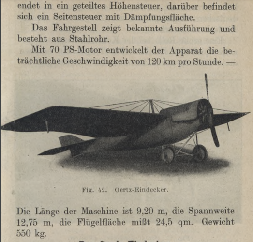

what was the Oertz Military Monoplane I & II ?!,that's all I found..

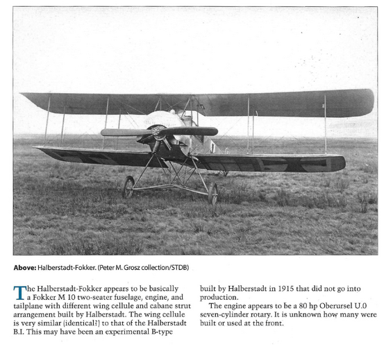

Interesting. This hybrid Halberstadt-Fokker has a rather more sensible looking cabane arrangement than that on the standard Fokker M 10Z.

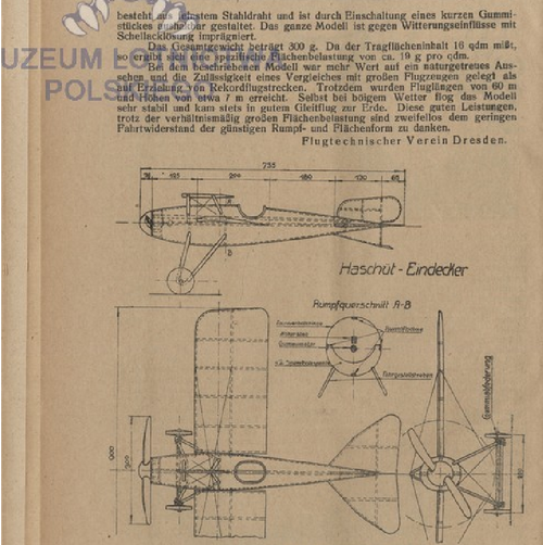

and a strange thing in my files,a project for Halberstadt D.VI fighter ?!.

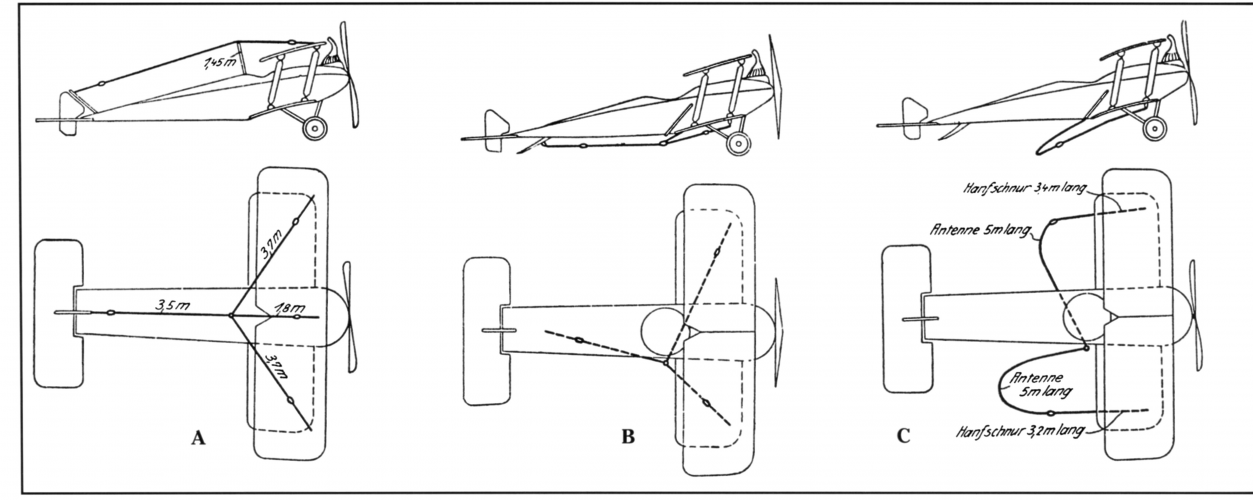

From Flugsport,
what was this Haschut fighter ?.
It's just a model airplane, nothing more.
Yes, the word "Gummimotor" in '21.png' should have been the tip-off.
Maveric: Any idea of the significance of that name - „Haschüt“-Eindecker? With this model having a Dresden connection, I wondered about the short-lived Haschüt motorcycle brand ... but that was Motorradbau Hans Schütze, not "Joh. Schütze".
Unfortunately, there are no references in the text that suggest a connection to a real aircraft or project.
The article was written by the Flugtechnische Verein Dresden, which is possible that there is a connection to real aircraft construction.
The source is NTM archive.
