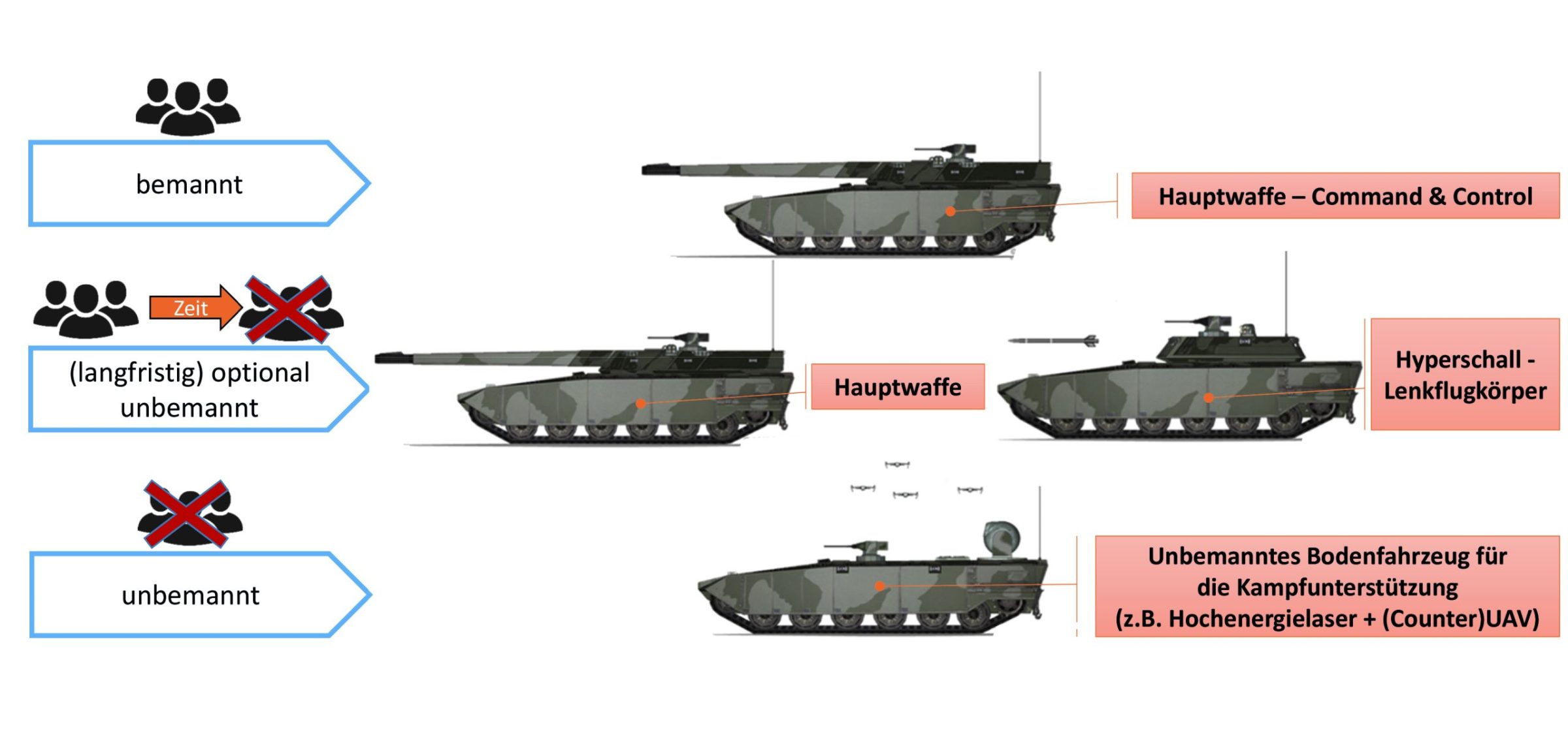

Notional MGCS family of combat and support vehicles. (Photo: Hensoldt=

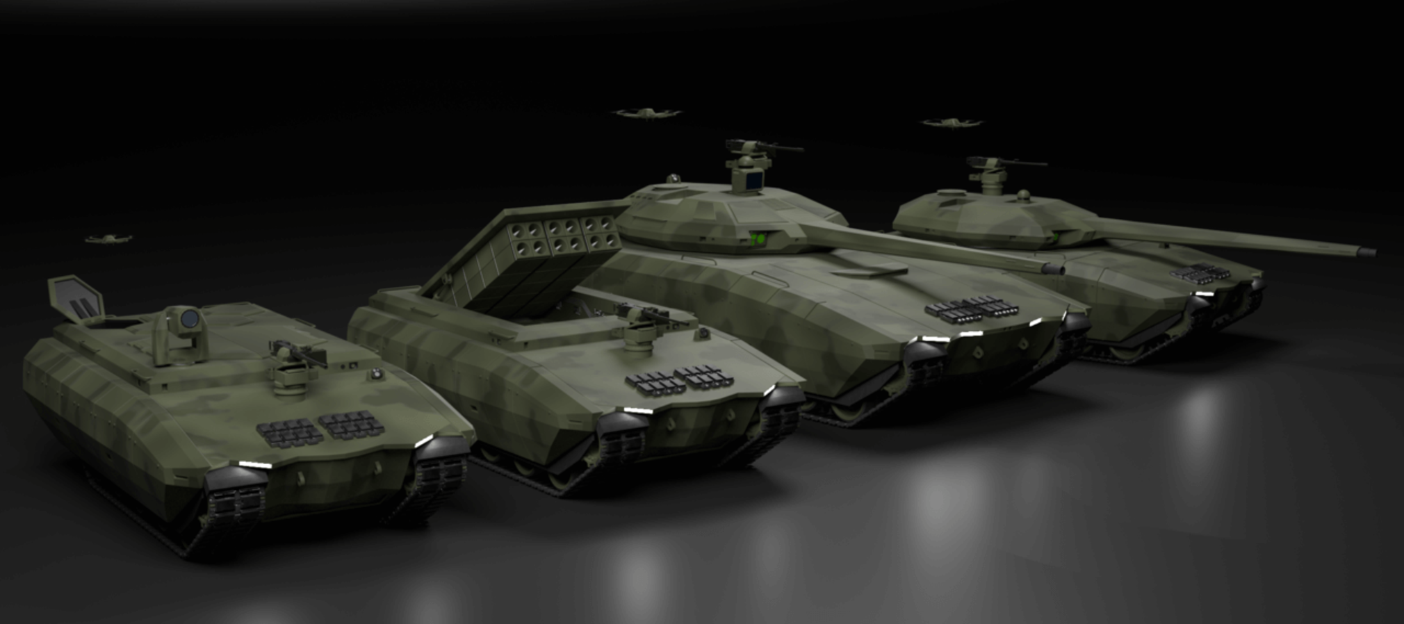

Notional composition of a multi-vehicle MGCS team. (Photo: BMVg)

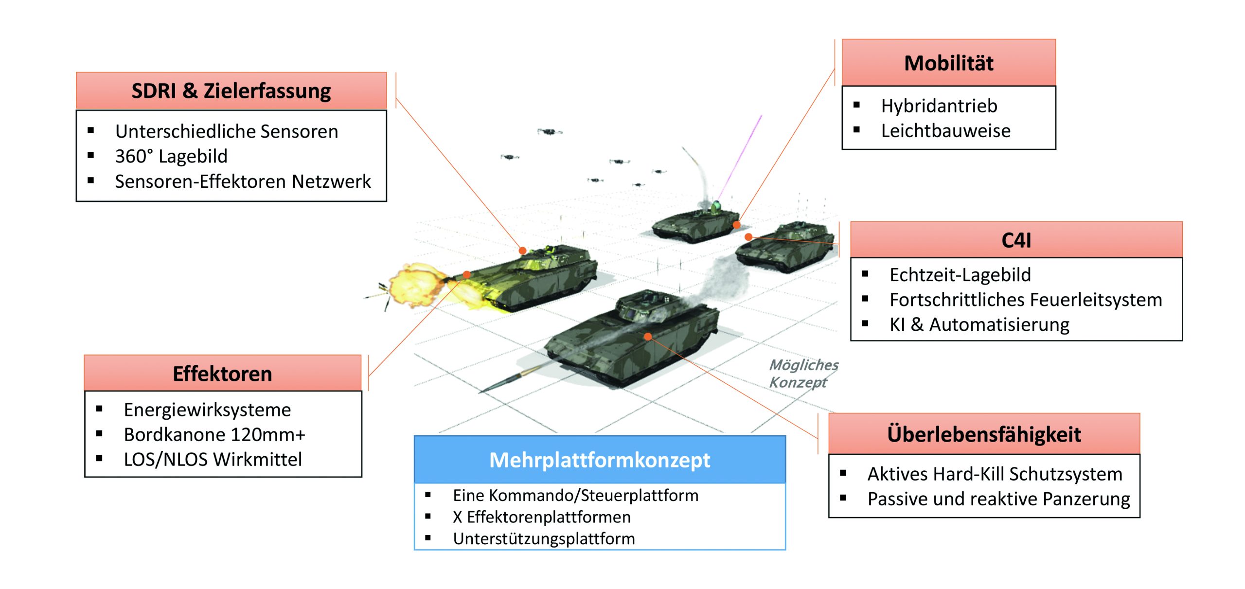

Notional composition of a multi-vehicle MGCS team. (Photo: BMVg/German MoD)
Am I understanding this correctly? One classic tank as HQ. 3 vehicles on smaller tracked chassis, with two of those vehicles optionally manned and one unmanned entirely? Or is it 3 vehicles on the same chassis as the tank with only the unmanned loitering munition launcher on a lighter chassis?
In terms of weapons, 2 tank guns, one hypervelocity ATGM launcher, and one loitering munition/artillery rocket platform?

IIRC from a Chieftain video, the idea with MGCS is that you can't make a reasonably sized tank with all the different bits you need to be competitive today. Hence a vehicle carrying HV-ATGMs, a vehicle carrying a whole hive of loitering munitions, and two vehicles carrying the big tank guns as a single battlefield unit.

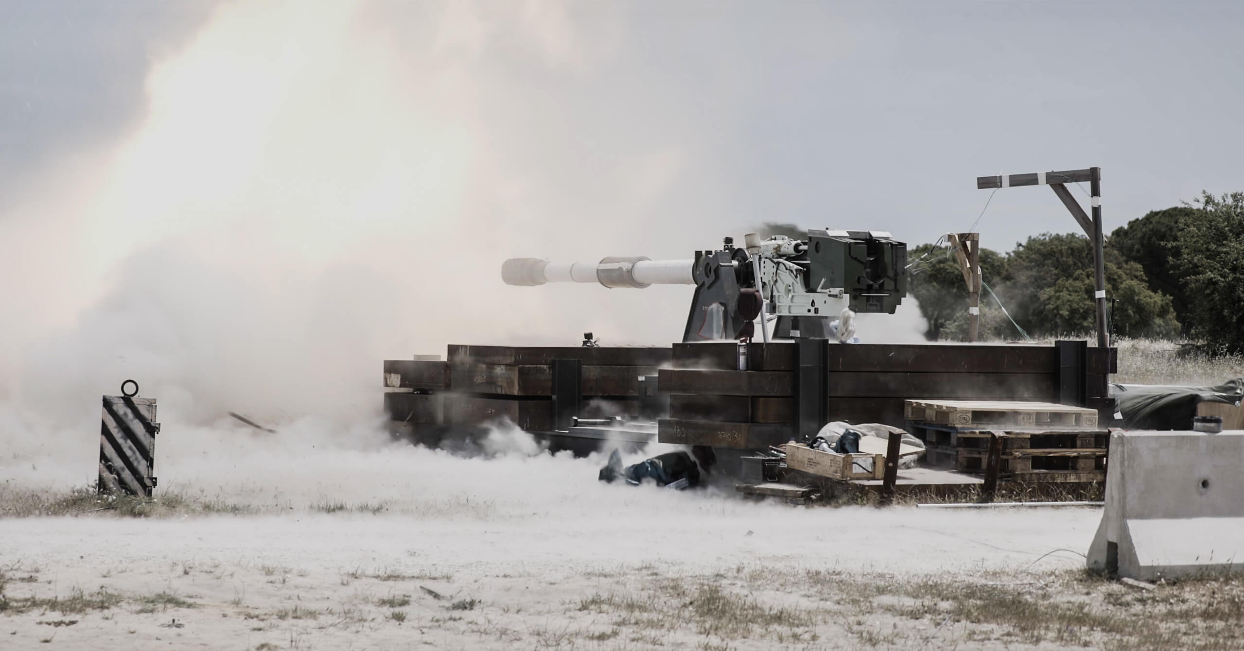

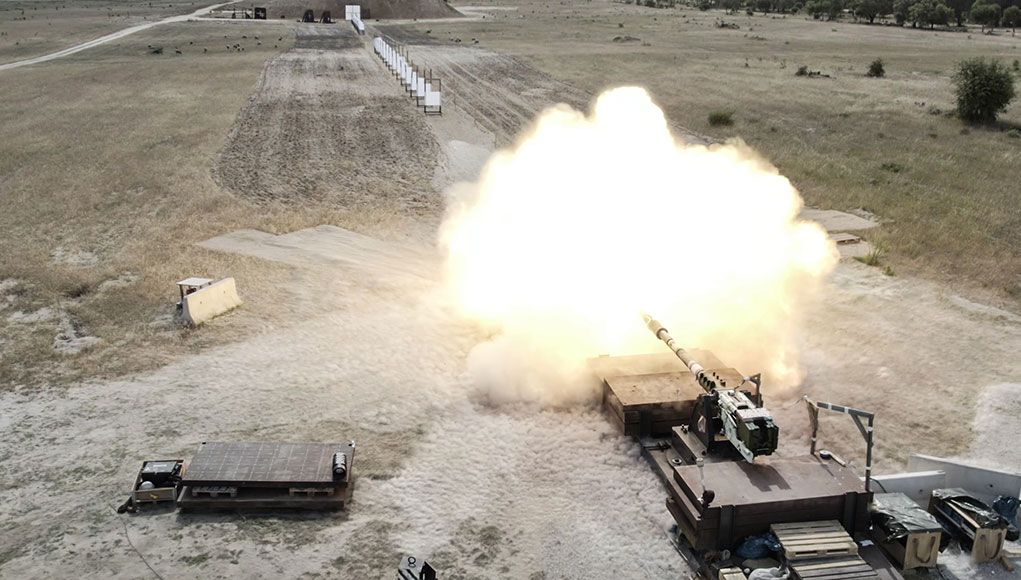

GTX posted news about a KNDS (Franco-German company) 140mm ASCALON© gun being tested as part of development of the armament of the MCGS.
