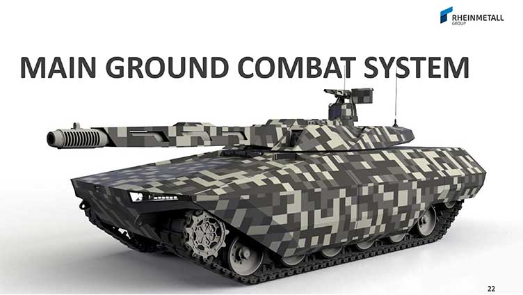

What would the MGCV look like? too early to tell, but most likely, MGCS will be a family of heavy combat vehicles, that will provide the core of heavy, most lethal, and highly protected element, built to dominate any one-on-one direct effect engagement against peer opponent in a future battlespace. Most charts depict MGCS as a group of vehicles delivering a balanced ‘triangle’ – firepower, maneuver, and survivability.
Sounds like: We have no idea if we need this widget and what it'd be, but we have committed a 20 year jobs program nonetheless!
It's just a number to indicate that they plan to continue working together after the vehicle enters production. In-service date is 15 years from today, which while slow isn't unreasonable. 5-ish years to study and narrow in on a concept, 5-ish years to turn that concept into a functional prototype, 5-ish years to transform that prototype into an in-service production tank. Sure, it would be great if they moved faster and it's not hard to point out all the reasons why. But that doesn't mean they're unserious.

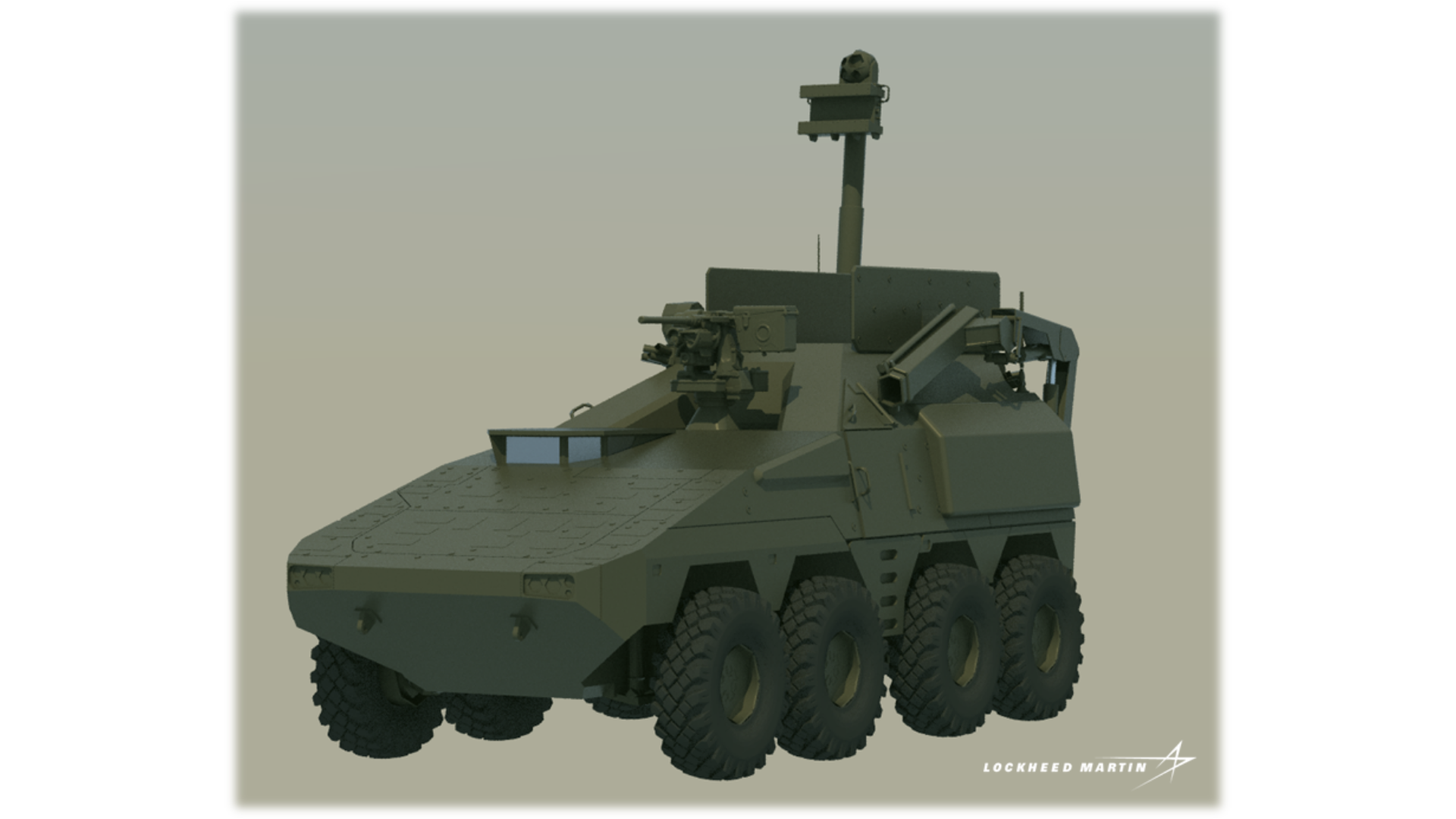

How often would 5km direct fire (anti-tank) engagements even happen and how efficient is it to do it with a gun (read: very high precision gun, powerful FCS and sensor system that doesn't use its full capacity 99% of the time). Germany doesn't exactly sit in a salt flat. It looks like development into less relevant niches while trading off capability against more common scenarios.
VL Brimstone would give a lot of potent firepower if...IF it can 'fired on the move'.
Rather as I've mused on a CAMM-SR (short range) for similar reasons.
While a Long Range Brimstone is another potent concept.

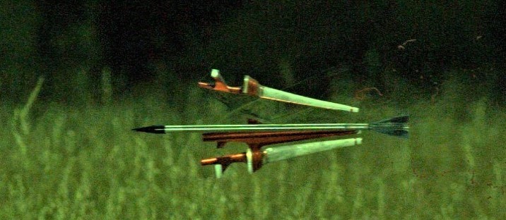

Something of a last ditch effort to have the MGS keep a 120mm gun?
EDIT: Sorry, MGCS.
The 120mm guns are going to be in service for decades to come....so why not see what you can do to let them keep pace with coming threats, Armata and whatever the Chinese come up with after the Type 99
Though they seem to be pitching it squarely at the MGCS program, whether in earnest or just to get some of the R&D funding is debatable of course.
I think it may be a case of using the 120mm round to mature the propellant and penetrator technology that could then be applied to 130mm or 140mm guns for MGCS.
