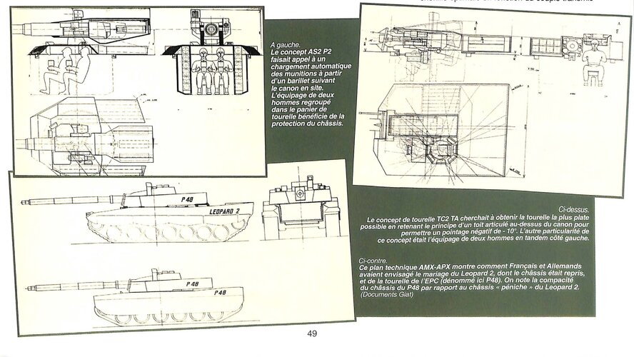

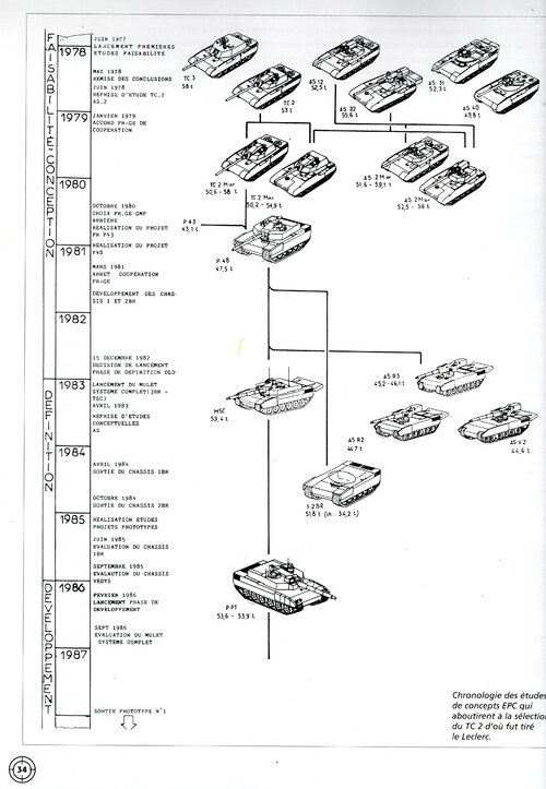

Some proposals (on second pic only at bottom-left, w/ P48 and Leo2 w/ P48 turret), and Leclerc development timeline w/ pic of P48 in ~1981

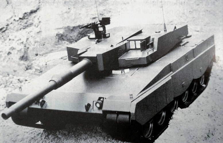

From this book - two pages on this program I've managed to compile from Google Books snippets, and photo of second of those two pages from Ebay

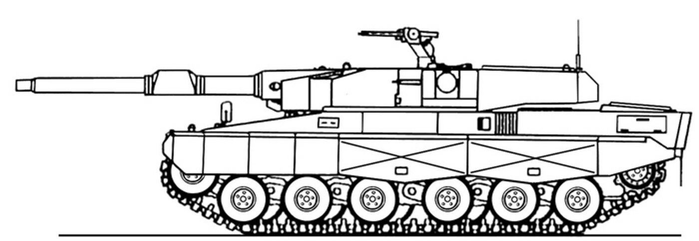

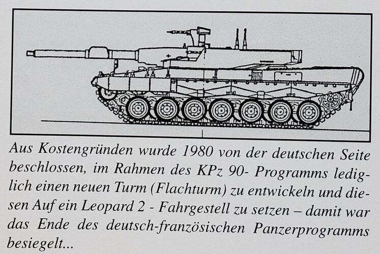

Description of pic at the bottom of p.146
UPD:
and high res version
