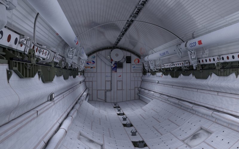

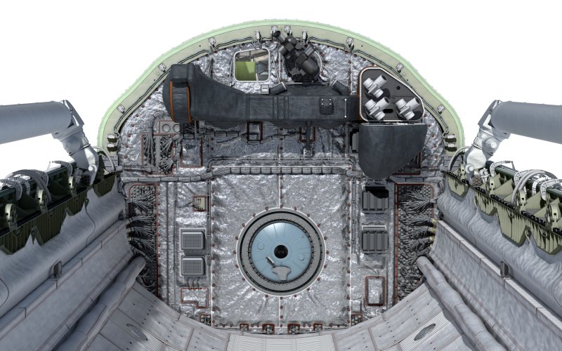

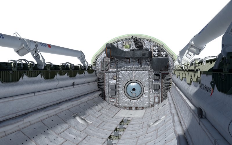

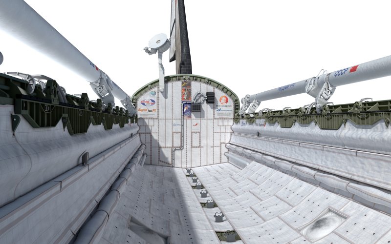

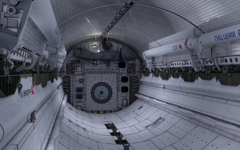

We have completed many years of work on creating the most detailed 3D model of the 11F35 spacecraft, and now I can show you what the second series of the spacecraft look:View attachment 791264
That is a thing of beauty. Was is MPC START that did the 1/288 models!We have completed many years of work on creating the most detailed 3D model of the 11F35 spacecraft, and now I can show you what the second series of the spacecraft look:View attachment 791264View attachment 791266View attachment 791267View attachment 791268View attachment 791269View attachment 791265
