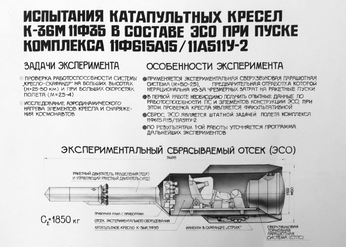

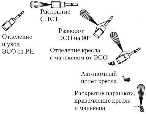

Do you have any photographs of these test seats installed in the Progress payload fairings? No doubt those payload-fairings would've been heavily modified to accommodate those ejection-seats.

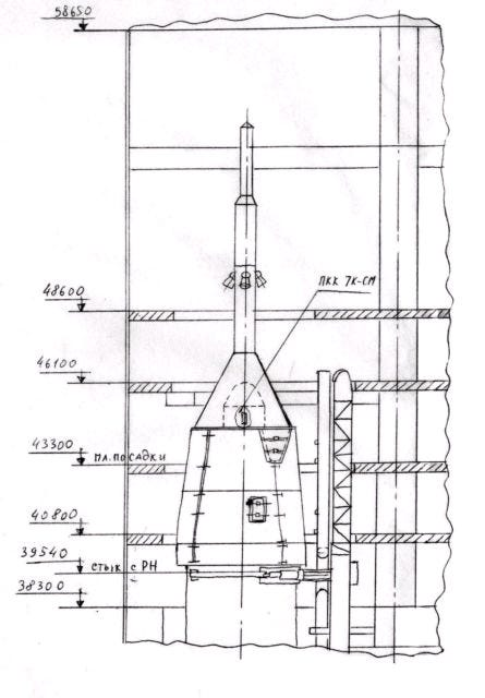

I cannot show the working drawings for reasons of confidentiality—only a fragment of the poster.
What remains behind the scenes:
- separation of the jettisonable compartment at an altitude of 43 km at a speed of M=5;
- activation of the first stage of the brake parachute system at an altitude of 59 km, M=4.9;
- detachment of the first stage at an altitude of 44 km, M=3.4;
- separation of the K-36M ejection seat with a dummy from the jettisonable compartment, altitude 36 km, speed M=2.9

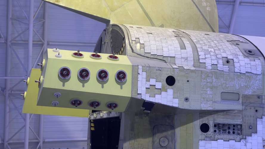

It carries individually targetable warheads in its cargo bay, which it releases in orbit, and does not return to the atmosphere itself, see http://www.buran.ru/htm/spirit.htm
Are there any plans to make a model of the laser system for Buran or the space-to-space missile launcher you mentioned? And a couple more questions: what was the actual Delta-V of an empty Buran with a full fuel load, and how much fuel did the additional tanks hold?
All the info in the Internet is very different of course, so you're the only reliable source)

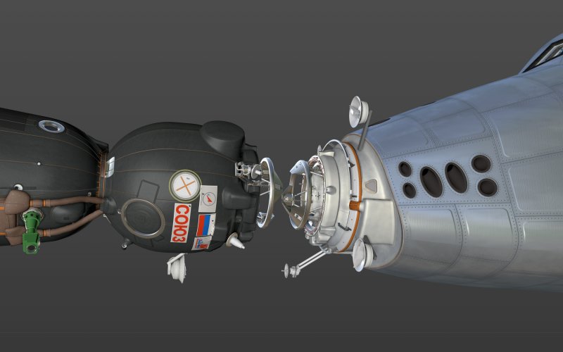

We plan to complete the Bolid model together with the impact blocks inside the cargo compartment. We do not have detailed data on the Buran's onboard defense system.

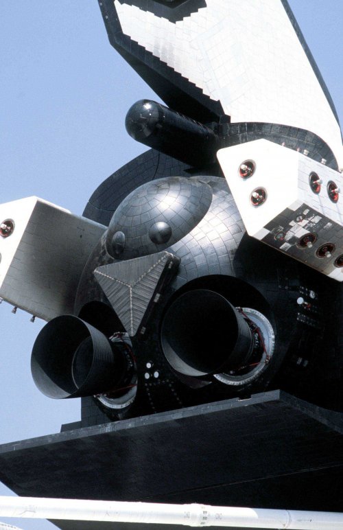

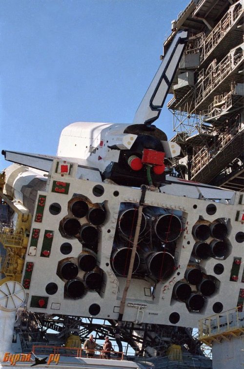

Regarding fuel: the Buran's combined dual-engine installation (ODU) could hold 14 tons of fuel.
A full tank (14 tons) was to be used only for an orbit with an inclination of 97 degrees; for other orbits with inclinations of 50.7, 65, 72.5, and 80 degrees, a tank of 7.5 tons was provided.
In addition, it was possible to place additional fuel tanks for another 14 tons of fuel in the cargo compartment. Thus, the maximum fuel supply for Buran could reach 28 tons.
Taking the mass of Buran as 85 tons, with a maximum fuel capacity of 28 tons and a specific impulse of the orbital maneuvering engines of 362 seconds, the total velocity increment (delta V) would be 1418 m/s.

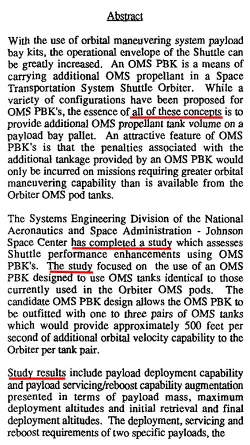

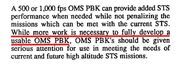

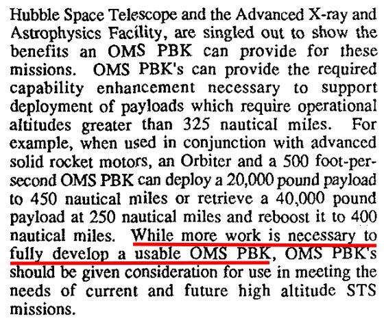

You must use speculative sources for other vehicles because you are wrong on the shuttle.
  • Payload Bay Kit (PBK) Extra OMS Propellant Storage shuttle_perf_with_omskit.pdf
After your statement that the Space Shuttle could perform a fully automatic landing without crew involvement (please refer to https://www.secretprojects.co.uk/th...s-flight-option-discussion.50316/#post-850270 ), it became clear to everyone that you are not familiar with the Space Shuttle developer's design documentation.
For example, you are trying to prove that the Shuttle could reach an altitude of 600 miles, but that is a lie.
The maximum altitude at which the Space Shuttle could fly was 400 miles. The maximum altitude reached by the shuttle in 133 successful flights was 386 miles, or 621 km (STS-31).
The material you have attached is an unrealized concept, just like your fully automatic landing.
Moreover, this is only a concept that arose in the tenth year of Shuttle flights, see attachments.
I am using documentation from the developer from 1984, i.e., four years before the first flight of the Buran. This is data that was originally incorporated into the design of the Buran and used in the creation of payloads for it.
After your fiasco with the Shuttle's automatic landing and now with its maximum flight altitude, your opinion is no longer of interest.

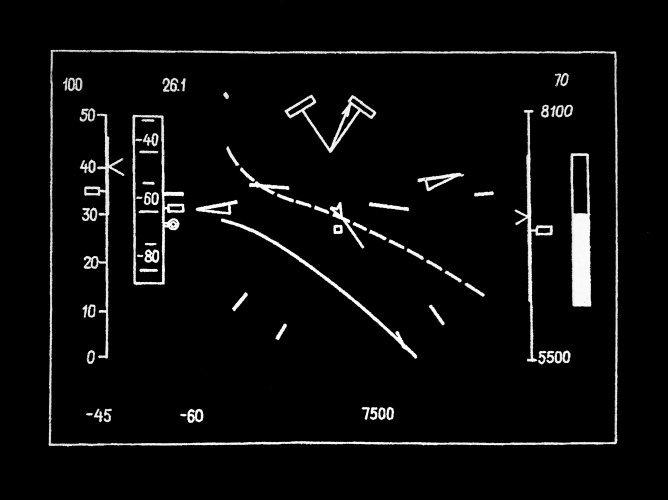

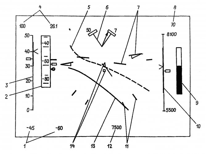

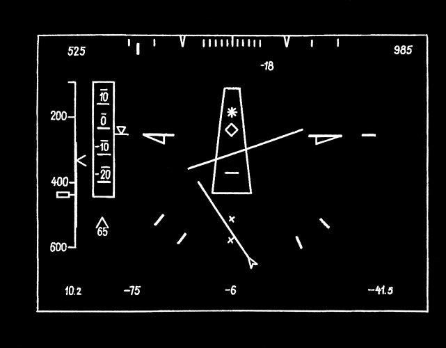

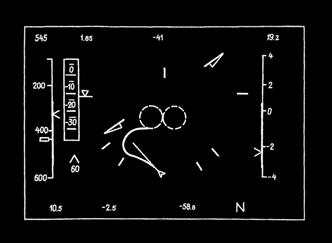

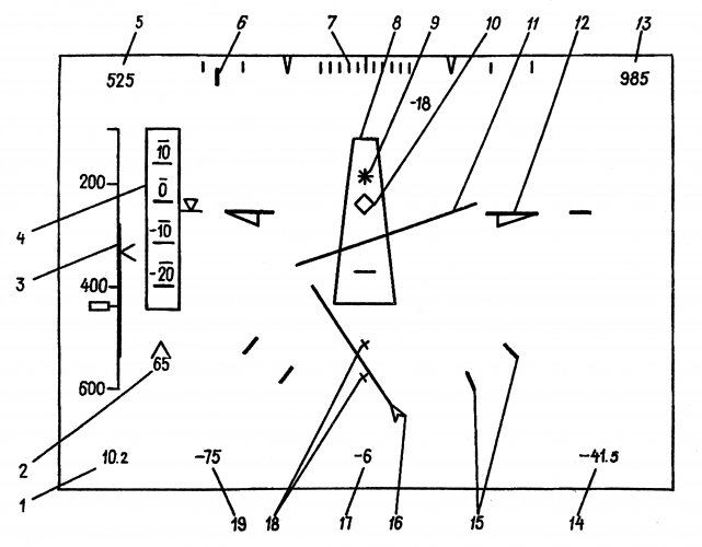

Hi, does anyone have any information on the Buran's information displays? I mean the VKUs. I have searched practically everywhere for them, and this forum has been the greatest help so far. Any info about them would be greatly appreciated.
Here are three display diagrams of Adonis from Semyonov 1995.
Fig. 9.7. Display information frame for a section of 100...20 km:
1 - movable counter of current and command values of the Vu quantity, 2 Vu scale with indicators of set and current values; 3, 10 - fixed scales of angle of attack and range with maximum ranges, current and nominal values of parameters; 4 - counters of indicated speed and Mach number; 5, 13 - dependencies of nominal and limit positions of the OK, caused by temperature and design limitations; 6 - course situation indicator; 7 - indicators of command and current values of the bank angle; 8 - flight altitude counter; 9 - fuel consumption scale; 11 - bank angle scale; 12 - runway distance counter; 14 - indices of nominal and current orbiter position

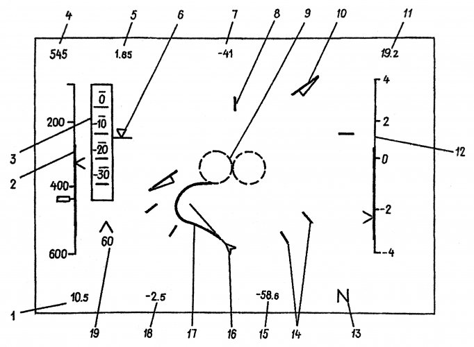

Fig. 9.8. Display information frame for the 20...4 km section: instrument airspeed and altitude reserve scale with
1 - angle of attack; 2, 12 limit ranges, current and nominal values of parameters; 3 - pitch angle; 4, 5 - indicated airspeed and Mach number; 6 - symbol of approaching the permissible angle of attack; 7 - heading; 8 - runway position index; 9 - TsVK position; 10 - current bank angle; 11 - altitude; 13 - index of predicted trajectory; 14 - bank angle scale; 15 - X-coordinate counter; 16 - orbiter position; 17 - predicted trajectory; 18 - lateral deviation from runway centerline; 19 - airbrake deployment angle
Fig. 9.9. View of the information frame of the display for a section of 4...0 km:
1 - angle of attack; 2 - angle of opening of the air brake; 3 - instrument speed; 4 - pitch angle; 5 - instrument speed counter; 6 - index of the current lateral deviation value; 7 - scale lateral deviation; 8 - runway symbol; 9, 10 - markers of the predicted final miss for the current and nominal OK state; 11, 12 - command and current roll angle values; 13 - altitude; 14 - vertical speed counter; 15 - roll angle scale; 16 - orbiter position; 17 - counter for the longitudinal X-coordinate; 18 - ground landmarks (far and near drives); 19 - lateral deviation from the runway axis

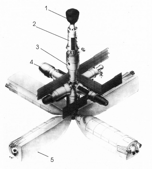

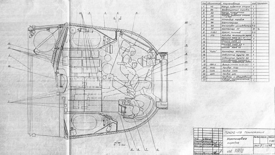

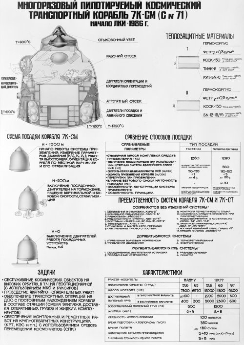

The article is very interesting (thank you for it!), but it contains many factual errors. Let me go through them one by one:
- You are correct in stating that work on the “Zarya” began under the designation 7K-SM in 1982 (as a further modification of the 7K-ST/11F732), and your entire subsequent description pertains specifically and exclusively to this first modification (maximum descent module diameter of 3.5 meters, crew of up to 8 people, etc.)
— but the final version (which was approved for construction in the second half of the 1980s) was designated 11F70 and differed significantly from the first—with a maximum diameter of 4.101 meters, the crew consisted of four cosmonauts in individual ejection seats K36L. The attached drawing, signed by Feoktistov, is dated November 25, 1987; the main set of design documentation was released in the first half of 1988.
- Accordingly, the 7K-SM and 11F70 are different spacecraft with different parameters and characteristics (notably, both the initial and rejected versions of the 7K-SM were intended for launch on both the Zenit and Soyuz rockets with a minimal crew and payload).
Now for the details:
- In its final configuration, the 11F70 had a maximum reentry module diameter of 4.101 meters, while 3.62 meters was the minimum diameter of the conical service compartment;
- Payload capacity (for the 11K77 Zenit rocket) to a 51.6-degree inclined orbit: 2,500–3,000 kg with a crew, 2,800–3,300 kg without a crew; during descent from orbit, 1,200 and 1,500 kg, respectively;
- aerodynamic drag coefficient 0.25;
- reference orbit altitude 150 km, operational orbit altitude 350–600 km;
- landing engines: the 7K-SM has eight engines with a thrust of 6,500 kgf each; the 11F70 has 24 engines (thrust unknown);
- landing accuracy: plus/minus 1 kilometer;
- maximum acceleration during landing: 4g;
- maneuvering engines (on the 7K-SM): 2 with a thrust of 300 kgf each; fuel for the combined propulsion system: RG-1 kerosene, O-30VK oxidizer;
- In the documentation for the “Mir-2” complex, the 180GK does not appear as a small supply ship for “Soyuz”; only “Zarya” is listed. “Soyuz” appears in place of ‘Zarya’ in the next variant of “Mir-2,” the 240GK

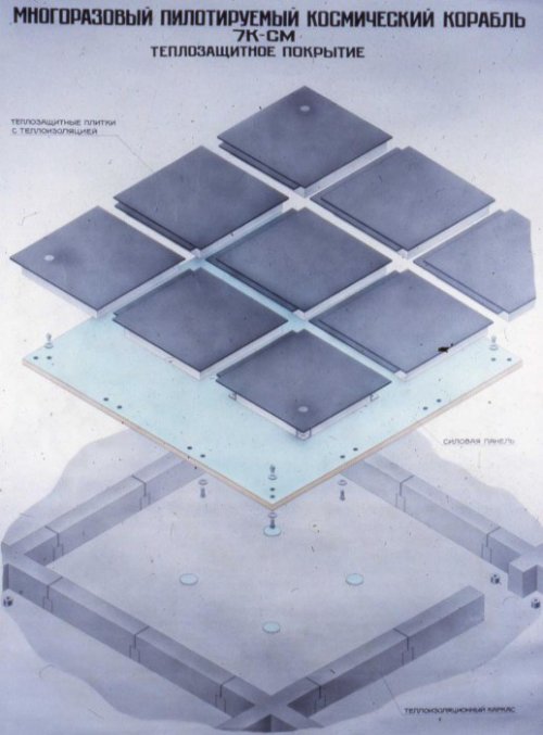

Some questions about the differences then. As I understand it, on 14F70, the thermal protection system was (in order):
  • Thermal protection tiles of composition:
    • High-emissivity coating (BK-12-18/15 and a different material)
    • (on the windward side tiles only) a variant of TINK quartz material
    • base of KSSK-150 pressed thermal insulator made of amorphous silica fibers on inorganic binder
  • Felt
  • Structural backing
  • Separation layer (grid of ribs with pockets of air)
  • Pressure hull
According to the drawing you posted, 7K-SM uses almost the same materials, but does not have the separation layer, with the felt and tiles attached to the pressure hull directly. This illustration, however uses the 7K-SM name and the 14F70 separation layer design. Is this a later version of the 7K-SM with the newer heat shield, or am I misinterpreting the diagrams?
Secondly, is 7K-M an alternative designation for 14F70? It pops up in a number of places but I have also seen it as the designation for a Soyuz modification from ~1972 (in Mishin's diaries for example).
Same question regarding 7K-SM and 11F732M, are they the same thing?
Karfidov mentions 7K-SM with the 11F732M designation, No.71 serial number and "preliminary documentation released in 1986" as a two-person ferry to Skif and Kaskad combat stations.
Do these illustrations show the early 7K-SM? (caption in RKK Energia 46-96 uses both 7K-SM and Zarya).
And lastly, is this drawing 7K-SM with parachute recovery or 14F70 mislabeled as 7K-SM?
