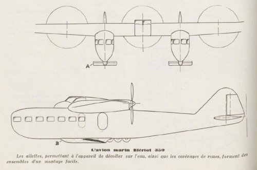

here is the Bleriot 350,it was a three fuselage high-wing transatlantic seaplane
aircraft project,powered by three pusher engines.
L'Aerophile 3/1936

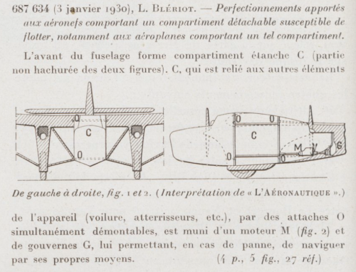

Here is a patent for detachable concept.
l'Aeronautique 1932

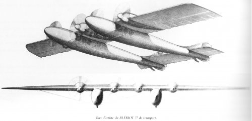

and here is a Bleriot-77 four engined twin fuselage transport aircraft project.

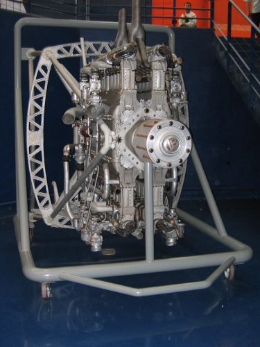

Hi !
I would like share with you this pictures I have made at Musée de l'air in Le Bourget of the Blériot four engines composit.
Tonto

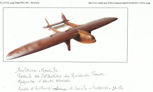

Hi all
I've found this model of Bleriot's studies !
This come from a museum in SURESNES 92150 fRANCE
Do you know more ! I don't have explanation !!!
My dear Toura,
I think no one know it,and we displayed it before here;
http://www.secretprojects.co.uk/forum/index.php/topic,17758.msg191106.html#msg191106
My dear Hesham
How are you
Thank you very much !
You have many more detail than me !
Thanks again...Bye
PAUL

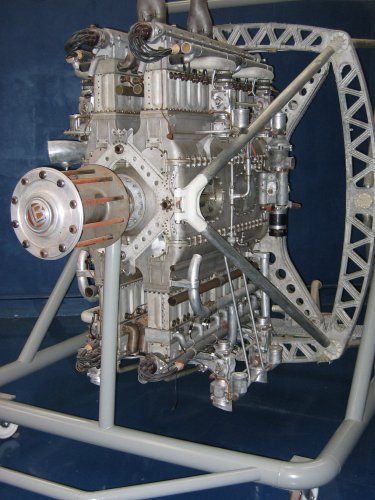

Thonthon 42 - very interesting engine - do we know any more about it?
Bleriot-152 was twin engined tourist light biplane project of 1931.
Hi Nick !
I think I've something over the subject in a "Fana de l'aviation". If I good remember me, that engine (or his sister) was flown on a prototype during mid twenties ... May be Tophe ;) , who is a "well of knowledge" in aeronautics, could have the right answer over this special four engine ...
@+++ and good year for all friends !
Tonton

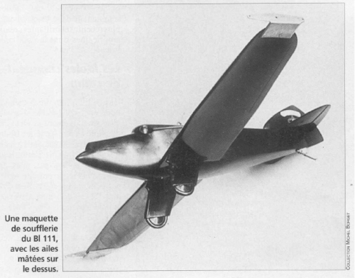

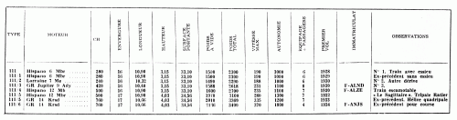

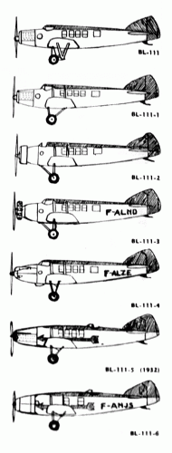

here is an early Model for Bleriot Bl.111 aircraft.

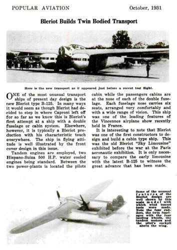

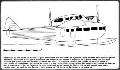

Blériot 125 from Popular Aviation, October 1931:

From Le FANA magazine,
here is the Bleriot 125 with floats,I don't know if it was a project or not.
The image's caption says
Jamais le Blériot 125 n'a été essayé dans cette configuration; un seul de ces flotteurs, celui exposé au XIIe Salon de l'Aviation, a été construit.
The Blériot 125 was never tested in this configuration; only one of these floats, the one exhibited at the XIIth Salon de l'Aviation, was built.

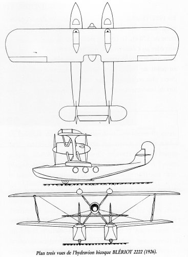

the Bleriot 2222 was twin engined (push-pull) amphibian flying boat biplane project of 1926,
intended for transport,could accommodated 8 passenger,powered by two 450 hp Lorraine
12 Ed engines,featured by a twin hull configuration.
