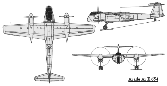

E 654 - Ar240 development 1941

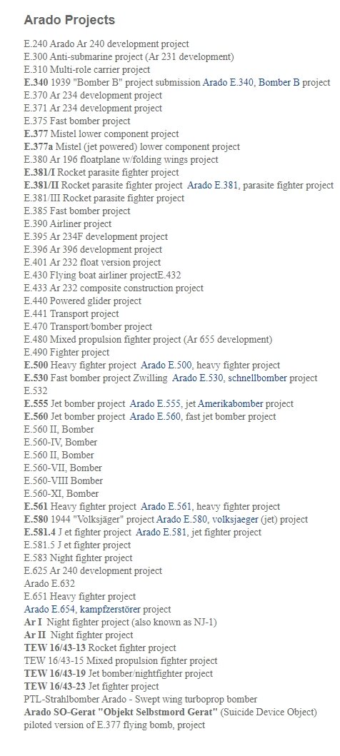

It appears you are mixing apples and oranges. The RLM 8-Nummer series and the Arado E.xxx series are completely independent. For example, the Ar 234 (8-234) was the RLM designation for the development of the Arado E.370 project (not just "Ar 234 with multiple undercarriage wheels 1940"). Most projects that made it to hardware had several iterations before metal was cut. Occasionally the numbers get mixed up, even in WWII German documents, but if you study the subject of WWII Luftwaffe projects, IMHO you will find it is generally pretty clear which is which and they are not the same thing.
Best Regards,
Artie Bob
Additions in Italic (Source: "Arado - Geschichte eines Flugzeugwerks" by Jörg Armin Kranzhoff, ISBN 3-925505-27-X):
The mentioned book was published in 1995. Five years later the same author wrote an 'update' on the same topic (Volume 31 of the Deutsche Luftfahrt series). And of course, Artie Bob, you are right in case of number 440: Ar 440 multi-purpose aircraft ('Mehrzweckflugzeug' at Kranzhoff) is totally different to E 440 warzone transport (see Ar 232).
E 377 was corrected by me (according to the entry in the book from year 2000).
Sorry for my sloppiness. (WWII designs are not my favourites.)
