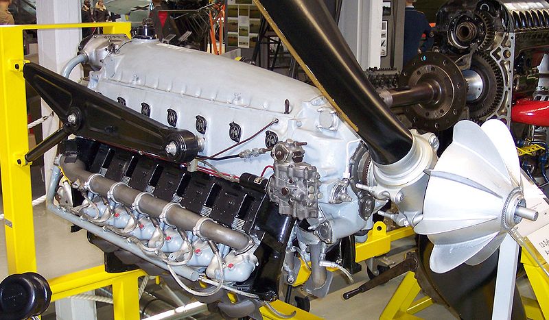

Dear all
A very straightforward question about the HS.129 "tank buster" aircraft. The A prototypes had Argus 410 with 450 hp and obviously the aircraft was underpowered.
We all know that the "solution" found was to put radial G&R engines produced by Vichy France. Ok. Those engines had nearly 700 hp and greatly helped.
Fine.
Now Wikipedia keep telling me that the Argus 410 become the 411 with far more hp - 650 hp. What's more, a lot of secondary LW aircraft build by Vichy France used that engine - to the point Renault carried on after WWII.
So why on Earth did the HS-129 never got Argus 411 ? far more straightforward than freakkin' French radials ! and same horsepower.
Then again, nazis and rationality were mutually exclusive words...
