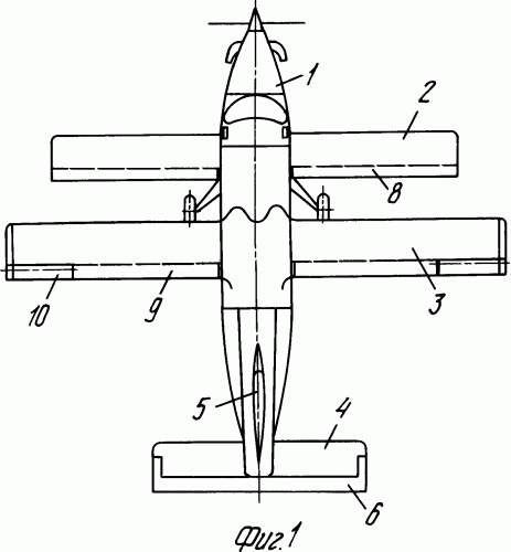

toura said:

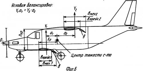

A little drawing from "AIR iNTERNATIONAL"
volume 51 n°2
The Mig 115 project
Biplane, the hight wing is behind the low one
1 turbo TVB 20 M 1350 hp
span hight wing : 15.00 m
low wing : 12.20 m
lenght : 14.66 m
speed maxi : 410 km/h
Pretty neat - a small An-2 successor? It'd be interesting to see range and runway lengths for such a project.
toura
CLEARANCE: Top Secret
Apr 12, 2008
1,191
22
HI Avimimus
yes, an AN 2 successor project
But nothing more........sorry.
Bye
flateric
CLEARANCE: Above Top Secret
Apr 2, 2006
8,793
227
it did look more like mix of Porter Pilatus and Rutan Quickie. One of designers was current T-50 Chief Designer Davidenko.

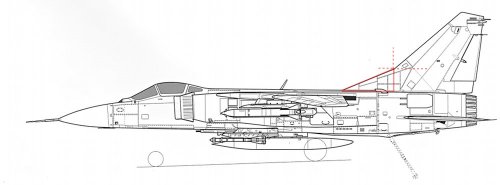

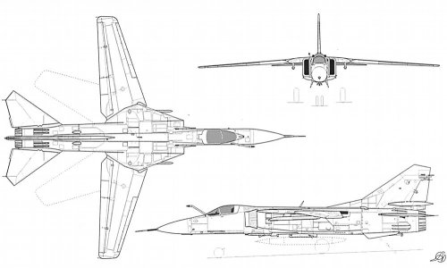

anther mystery,the Model 23.31,we know it allocated to MiG-23-98 and MiG-23UB-99,but
here is anther three unknown projects,also get the designation 23.31,they are;
MiG-23K shipboard fighter project of 1977,based on MiG-23ML,with single R-100 engine
MiG-23K also a shipboard fighter project,with increased wing span and retractable refueling
boom,and powered by two RD-33 engine
MiG-23I with upgrade radar and new missile

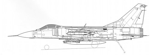

Well known projects - from Andrei Fomin's Su-33 book:
May 26, 2006
24,028
973
Excellent my dear Paul,
I have never seen like those fighters before,and can I ask you about the second
drawing (MiG-23K),was it a twin engined ?.

I have a Question regarding the tail section of the Mig-23 A and K.. Why did they bring back the design of MF variants? i thought such design were abounded after the MF variants(post MF variants)
Regards,
AK
overscan
Administrator
Dec 27, 2005
11,536
950
Regards,
AK
-K : has a whole new tail.
-A : don't know why its got a MiG-23M style tail. Probably due to balance reasons. 23ML cut avionics weight in the nose, and balanced with weight savings in rear including the cut-down fin.
Sundog
Aug 2, 2006
2,621
34
But you also have to note the K also has a taller vertical tail than the other variants, which was probably done due to the greater side surface area of the nose with the raised cockpit.

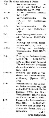

In the book; Mikoyan MiG-21 by Bill Gunstone;
I found a chapter on MiG Ye-9 aircraft,but the book was from 1986,and I want
to check if that designation is right or not ?.
May 26, 2006
24,028
973
Also from Flieger Revue 5/1982,here is a small info about Ye-9 designation.

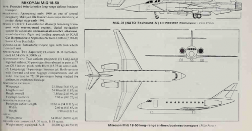

hesham said:
By the way,
MiG-18 was 50 passenger airliner project,see also Jane's all the world's aircraft 1993-1994.
MiG-24 was transport aircraft project,see also Jane's all the world's aircraft 1991-1992.
here is the MiG-18-50 Project.
Jane's All the World's Aircraft 1991-1992
Stargazer2006
Jun 25, 2009
13,243
89
Marcel Dassault, come out of this airframe at once!

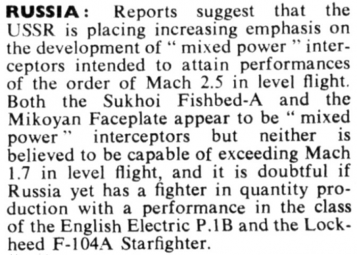

From Flying Review 6/1957,
they spoke about mixed powered interceptor could attain 2.5 Mach,did they mean the
MiG Ye-50 or anther project ?.

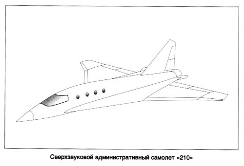

here is a supersonic business jet aircraft project by MiG,called aircraft 210.
http://testpilot.ru/russia/mikoyan/210/mig210.htm

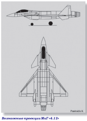

From Kryl'ya Rodine 2015-04/05;
here is the MiG Aircraft 4.12 and 5.12 Projects.
May 26, 2006
24,028
973
