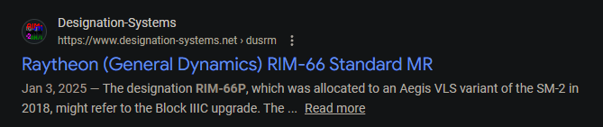

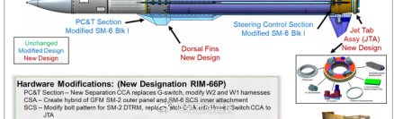

Which Block of SM-2 has an active seeker? Didn't think that came along until SM-6. Ah, from Designation Systems
"In 2018, the Navy awarded Raytheon a development contract for the SM-2 Block IIIC. This version replaces the missile's seeker with the dual-mode semi-active/active radar seeker of the RIM-174 SM-6, and adds a new dorsal fin design and a jet vectoring tab for enhanced trajectory control after launch. A further upgrade, which replaces the Guidance Section Electronics Unit, is known as Block IIICU. Test firings of SM-2 Block IIIC missiles began in July 2022. The designation RIM-66P, which was allocated to an Aegis VLS variant of the SM-2 in 2018, might refer to the Block IIIC upgrade."

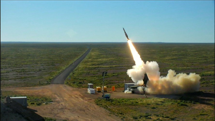

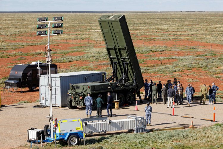

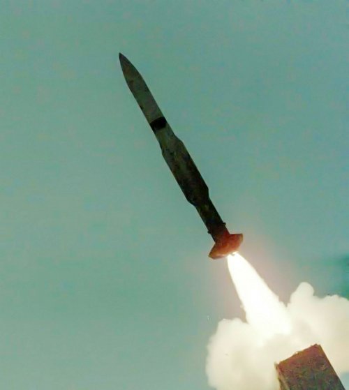

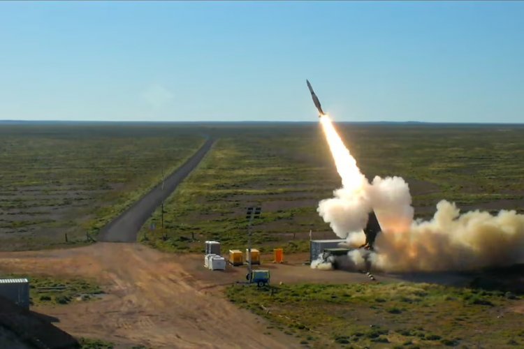

View: https://x.com/lfx160219/status/2012366685462765801

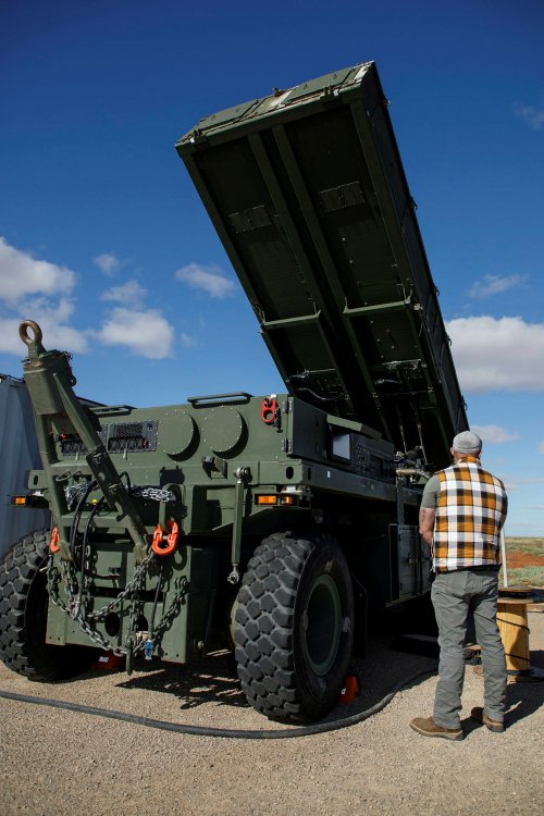

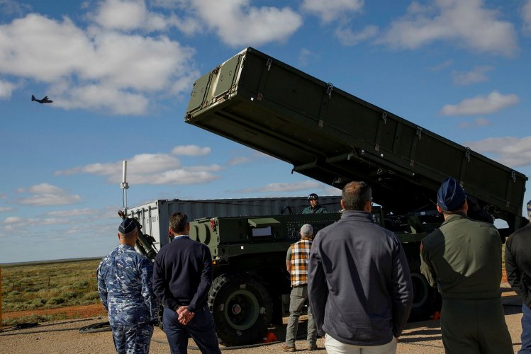

From the link immediately above: “…a trailer-mounted launcher called the Expeditionary Launch System, or Derringer”.

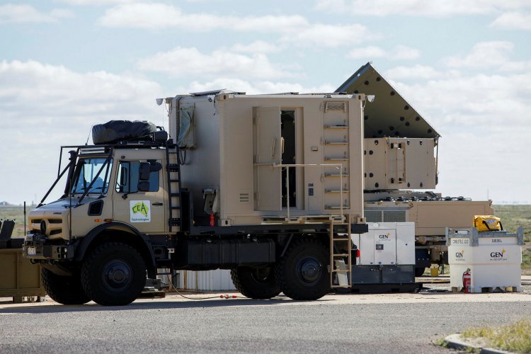

Is this an Australian built system? I have not heard of it before and can find no references to it outside articles on the Australian missile test. Is it sufficiently long to fit SM-6 or is it “tactical” sized?

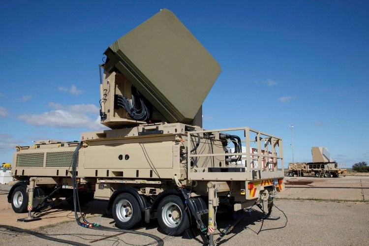

Is this possibly a testbed for the AAW systems of the Hunter class frigate? CEA radar, Aegis, SM-2 missiles…
Some more photos from the trial
