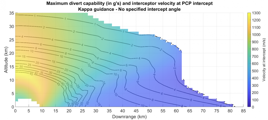

In terms of the SM-2's kinematics, this report's table seems somewhat applicable, although I don't know the specific requirements for ballistic intercepts and the guidance method might be different in that case.
That is about what I expected.
45gees divert capability at 10km altitude and 10km range. (I'm assuming a roughly 45deg dive angle for most AShBMs.)
That's it? I thought SM-2 had more range than that. Most sources give 80-90 NM.
Two notes.
First, the thesis is unclassified, and therefore makes a number of assumptions which may or may not be correct.

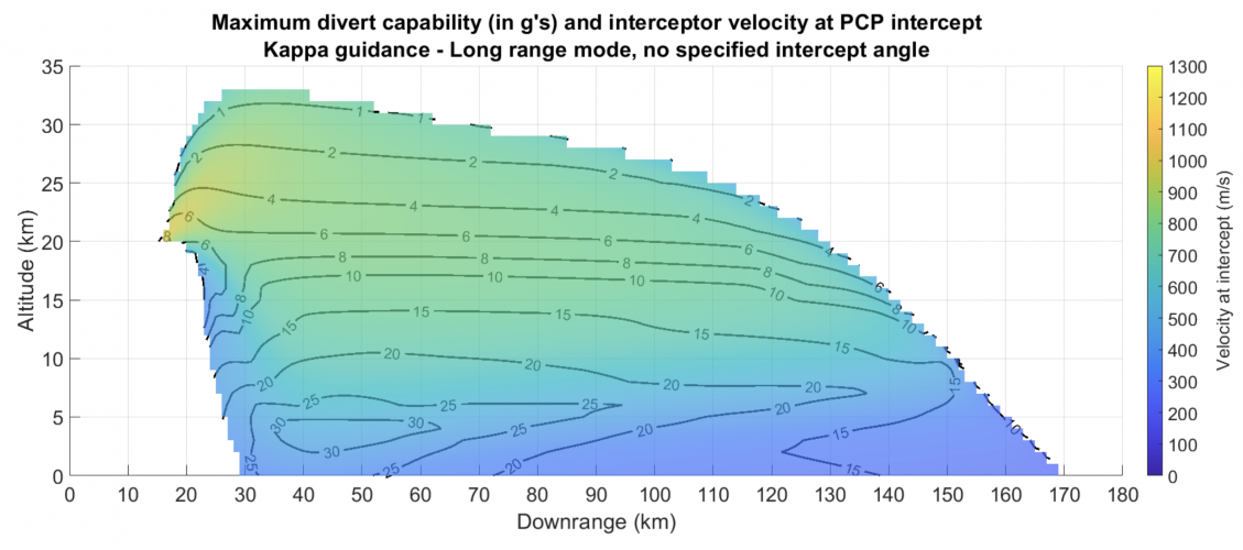

Second, the author proposes a 'normal' and a 'long range' guidance mode, with the latter restricting manoeuvres early in flight to extend flight time at high altitude, explicitly to address that issue. Based on the author's assumptions, that gives a kinematic maximum range of 173km.
Real SM-2 guidance certainly includes lofting, as is evidenced by videos. Here's the paper's best guess.
The constant 3g pitch-over manoeuvre during the initial 25 seconds of flight positions the interceptor at an altitude of 18.1 km and a downrange position of 12.9 km, displayed as the left-most point of the flyout table. During this pitch-over manoeuvre, the burnout Mach number at 16 seconds is Mach 4.3, translated to a ground Mach number of 3.7. Comparing the time-to-intercept contour lines of [long range mode] to [normal mode] results in a shorter time-to-intercept from a downrange distance of 40 km onward at all altitudes. [Long range mode] greatly increases the Mach number at intercept at all altitudes for downrange distances greater than 30 km
