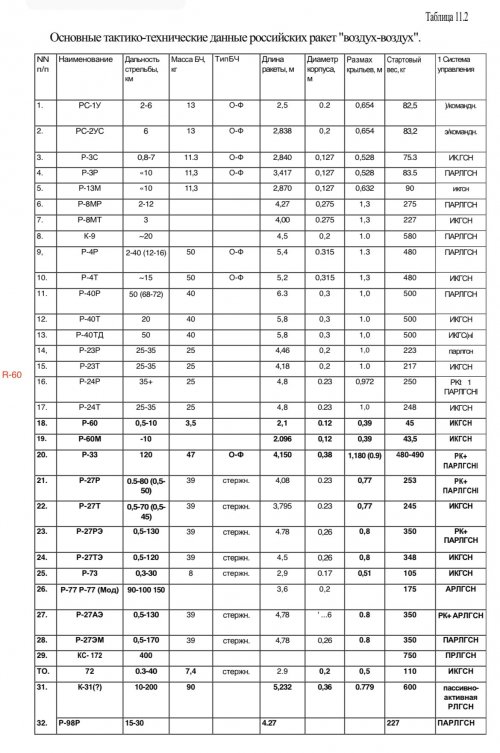

''В систему управления ракеты Р-27 помимо ГСН входит инерциальная навигационная подсистема с радиокоррекцией. На начальном участке траектории применяется инерциальное наведение на «математическую» цель с радиокоррекцией ее положения и скорости при маневре цели (по информации с носителя, передаваемой по радиолинии).''
''In addition to the seeker, the R-27 missile's guidance system includes an inertial navigation subsystem with radio correction. During the initial phase of the trajectory, inertial guidance is used to target a "mathematical" target, with radio correction of its position and velocity during target maneuvers (based on information transmitted from the carrier via radio).''
Inertial phase can be up to 70% of trajectory/ missile flightpath and that's it. RC-channel /data- link will be used only in the case when active jamm isn't used by the enemy ( index АП or AP ). RC-channel coded signals will be sent through sidelobes if the combat situation allows something like that. RC-channel range is 50km max.

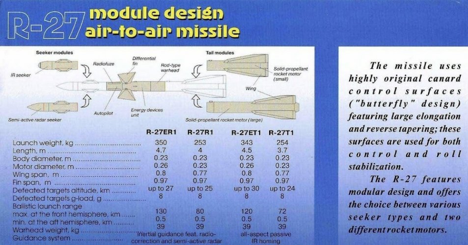

No, letter E is from 'energetic' ,version with 100kg heavy booster. So we have R-27 and R-27E with their versions like R-27R/ R1,T/T1,P/P1 than, ER/ER1,ET/ET1 and EP/EP1. Number '1' designates export variant.
The R-27(R-27E) missile guidance system provides a launch range that is 2.5 times longer than the S-A homing range, and this coefficient is almost independent of the target's maneuver.
When the launch range is 1.5 times or more the missile's homing range, the missile's inertial system uses data from the radio correction channel. If this coefficient is less than 1.5, radio correction is not used.
This is particularly relevant for the R-27E missile. It's launch range in the front hemisphere can range from 60 to more than 100 km (if the target is flying at a speed of more than Mach 3 at high altitudes). At the same time, the missile reaches a speed of about Mach 5.5 for a short period, but the average speed is Mach 3-3.4. During the 60 seconds of controlled flight, the missile travels up to 60 km.
The R-27E does not use a rise above the target to increase its range. Its guidance system does not allow this even theoretically. Its long flight range is achieved through its extremely high energy (the highest fuel ratio relative to the missile weight among all Air-to-Air missiles)
Of the Soviet missiles, only the R-33 uses a rise above the target. It is smartest among all missiles.

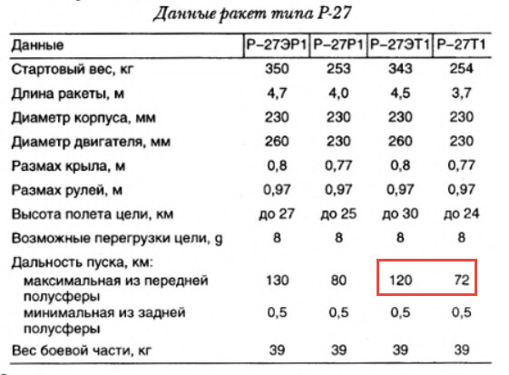

Squirrel said: "for R-27R : 30 km against small target,70 km against medium target,90 km against big target"
The launch zone of the missile with INS+Homing depends mainly on the target's speed rather than its size. Theoretically, the R-27 can reach a launch range of approximately 80 km (conditions like this: the target at 2300 km/h and a MiG-29 at 2000 km/h flying at high altitude towards each other). The missile itself will travel about half of this distance in 60 seconds before reaching its target.
In practice, the launch zone rarely exceeds 30 km.
The R-27 had significant limitations. But it was the best medium-range AAM before the AIM-120
130km is the max launch distance ( as calculated, authorised) for the R-27ER. That can be only for the so called 'Dr max 1' launch parameter ,so for the engaging of the non-maneuvering air target.
Manual for the SUV-29E in the MiG-29B gives us data that 90 km can be maximum ( possible, permitted ) launch range for the 27R/R1 against one strategic bomber like B-52H e.g.

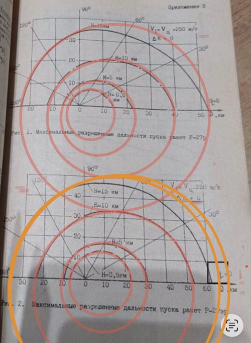

Hi !
Could you please post these graphics over there on Secretproject forum, R-27 topic...
They write some interesting stuffs and this could help them to make estimation of INS and radio correction distance values, relative to fighter, easier. Actually with this they could make several scenarious, I think it will be helpful

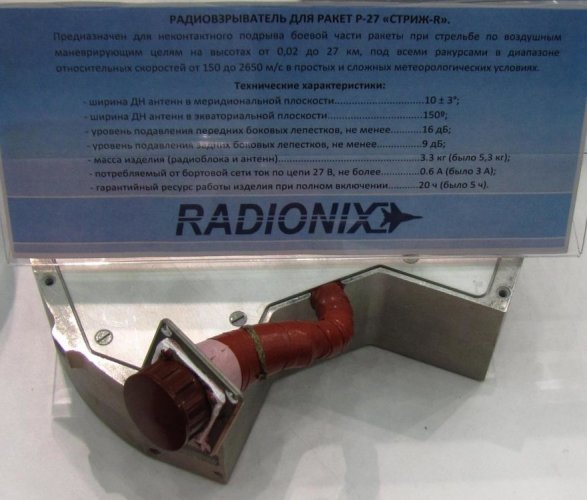

''Apparently the R-73 radar fuse as well as R-60 radar fuse also have a minimum closure limitation of 150 m/s. There is maximum closure limitation of 1400 m/s for R-60 so R-73 likely a little higher or even the same.''
Same value is for the radar proximity fuse 'Strizh' of the R-27/E and 2650m/s is the max value.
Значения задержек срабатывания радиовзрывателя, м/с
Тип цели
прогнозируемая скорость сближения ракеты с целью м/с
150-350
350-1050
1050-2650
Малая цель (МЦ)
5±2,5
0
о
Средняя цель (СЦ)
З6±8
10±4
о
Большая цель (БЦ)
41±10
15±5
0
Values of radio fuse response delays, than values from the left for the type of target: small,medium and big target.

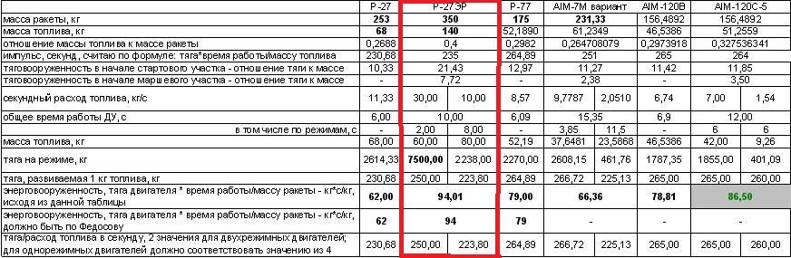

Some details about the single-chamber dual-stage rocket engine of the R-27E and why that version can fly for so long , so far away.
After some time,I've finally found one table with some interesting details for the R-27,R-27E,R-77,AIM-7M,AIM-120B and AIM-C5.Table which I 've found is from the ''forum.dcs.world'' and the 'original' one, I lost in my archive.
Some data about that R-300E as the designation of the mentioned rocket engine.
''Двухрежимный РДТТ Р-300Э с повышенной стартовой тягой с последующим постепенным её снижением.Масса двигателя 192.5 кг.''
''The R-300E dual-mode solid rocket motor offers increased initial thrust and subsequent gradual reduction. Engine weight is 192.5 kg.''
If we compare this data for those in the table,we have 140kg of solid rocket fuel in the 195kg heavy rocket engine.Also we can see in the table that the fuel weight of the single chamber single stage R-300 engine of the R-27 is 68kg but the fuel weight of the booster of R-300E is 60 kg. In the same time ,the fuel weight for the sustain stage is 80kg. Also data from the table that complete working time of the engine is 10sec ( 2 sec for the boost and 8 sec for the sustain stage) .
''Ракета Р-27Э комплектуется двухрежимным твердотопливным двигателем массой 192,5 кг повышенной тяги (до 7500 кг), работающим в течение 8,6—11 с.''
''The R-27E missile is equipped with a dual-mode solid-fuel engine weighing 192.5 kg with increased thrust (up to 7,500 kg), operating for 8.6-11 s.''
Boost stage which lasts 2 sec ( hm,is this right? ) ,have enormous t/w ratio during that stage (acceleration). 7500kgf : 350kg ( ER/ER1)=21.43 or 21.43 : 1 at the start point. After those 2 sec ,R-27E is lighter by 60kg. Than we have data that thrust of the sustain stage is 2238kg. We learned that R-27E has increase of its speed vs fighter's speed by about 1000m/s.In the max launch speed scenario that would be 700 m/s +1000 m/s ,so about 1700m/s. Precisely, for ER/EP it is 800-1000m/s ,for ET it is 700-1100m/s. At almost 20000m ( speed of sound at that height is almost 300m/s) , that would be Mach number of the R-27E equal to 5.6 . After the acceleration phase ,the speed starts to decrease of course. 35G is max lateral G load of the missile's body.For the 210 kg heavy R-27ER e.g. it will be 7350 kg of the aerodynamic pressure.
I suppose that booster is cylindrical and its length is in fact the length of the dual-stage engine section from expansion of the missile's body to the nozzle itself.That will be the section between 230mm diameter to 260mm for the booster and the sustainer is inside that 230 mm body section.On the photo is the R-27ER1 for the IAF fighters.
R-27ER besides R-27T .
Lenght of the R-27E in comparison with the R-27 is increased by exactly 0.7m and that is for the engine section only. In this article we have the schema of the modular construction.

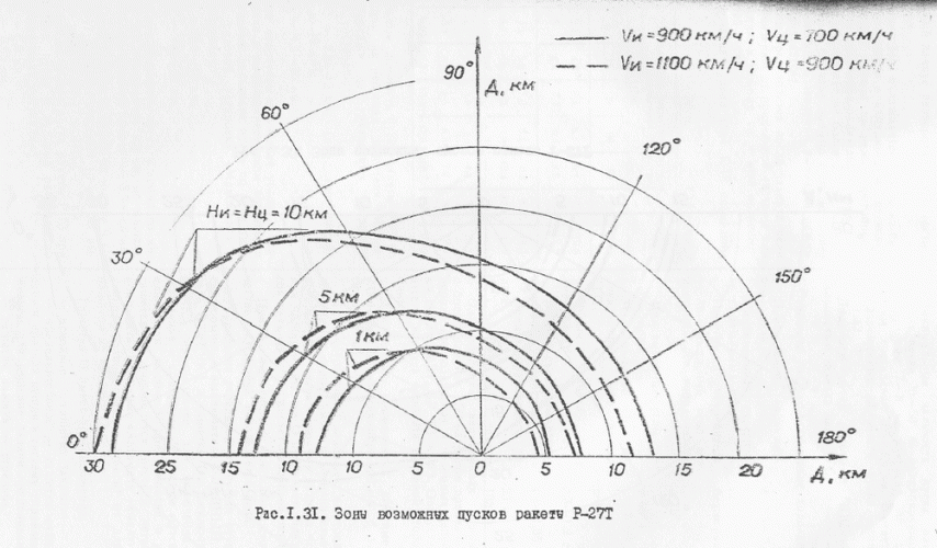

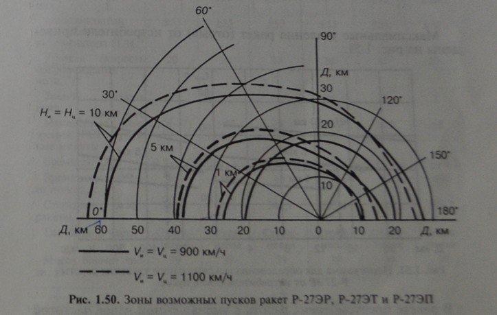

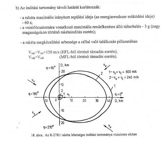

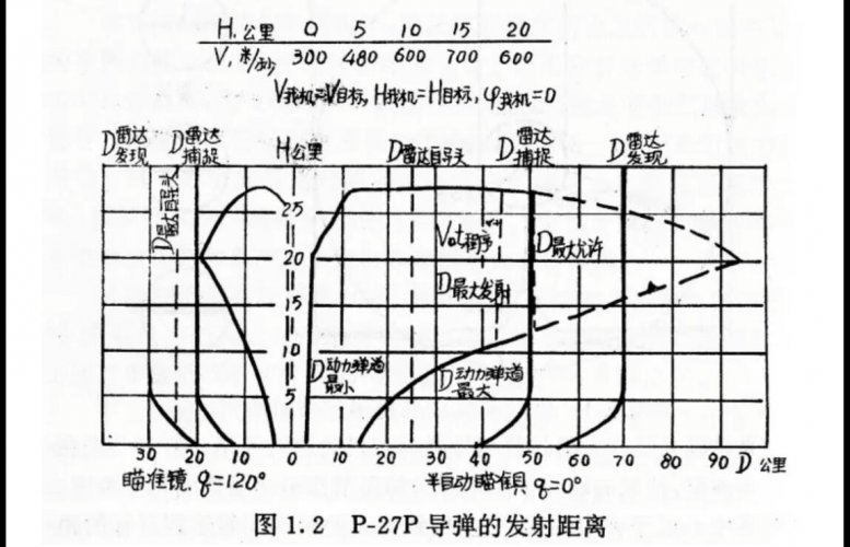

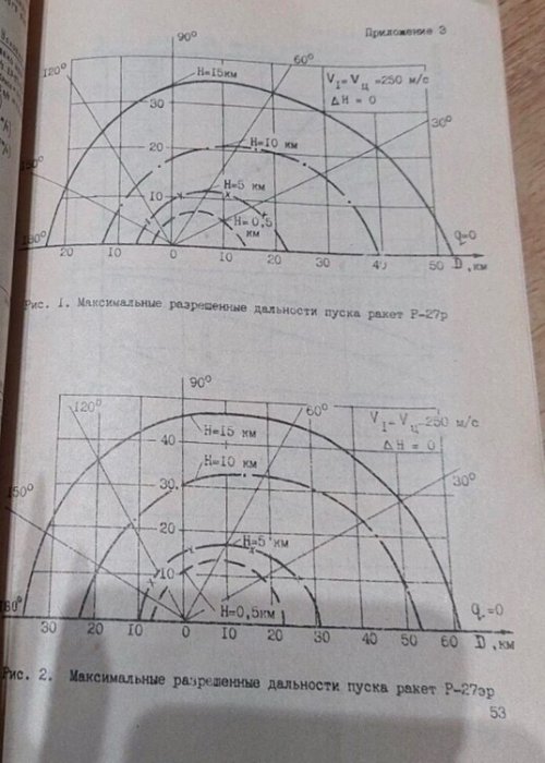

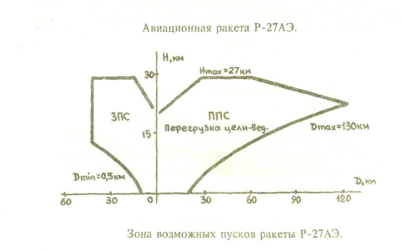

Some details about the distances/ranges ( launch,flight,ballistic).Beside all charts and tables ( often they have nothing to do with the military editions) , that we have here,there are some details from available manuals which give us so important data.When we discussed details about target's size and target's speed (closure speed) in relation with the possible launch range ,there is info from the manuals that even before radar will be turned on ,pilot must determine target's size with the switch called 'BAZA' ( Baza Tsely). With that switch ,pilot will determine three possible targe's size values : big,medium and small. Data about that will come via data-link channel from the NASU ( ground automatic guidance station).Immediately after radar is turned on and given combat mode is chosen,pilot will get given launch parameters for the given target's size with the three basic parameters: Dr max1 ( max authorised launch range against non-maneuvering air target),Dr max2 ( max authorised launch range against maneuvering air target) and Dr min ( min authorised launch range). Nothing else,there is no such thing like ''Дальность действия эффективная (км)/Effective range (km)'' or something else which we can find on some Russian or other sites.
Also we have some data like launch range for the R-27R/R1 is between 2km and 50km ,for the N019/E. Data like this one ...
''Для обеспечения заданной вероятности поражения цели в различных условиях максимальная разрешенная дальность пуска ракеты в ППС, вычисляемая в БЦВМ РЛПК, ограничена до 90, 70 и 30 км соответственно для большой, средней и малой цели.''
''To ensure a given probability of hitting a target under various conditions, the maximum permitted missile launch range in the PPS, calculated in the RLPK on-board computer, is limited to 90, 70 and 30 km, respectively, for a large, medium and small target.''
...can be for the N019M Topaz.There is also data ,that MiG-29B with R-27R1 can engage something big/fast from 90km away with max possible speed/height launch parameters.For the N001/E values are: 50,90,130km.
After target's size/launch parameter is chosen,WCS (radar's comp/ BTsVM) will calculate all other flight parameters: speed,height of the fighter/target, target's angular coordinates,possible closure speed/rate etc...
Max launch range for the ER/ER1 can be those 130km in the given combat situation with max possible speed/alt launch parameters.Example ,against some big,very fast target. Controllable flight time is 60 sec ( operational/working time of the stabilizers) ,just like of R-27 ,that is because attachable stabilizers in the front section of the missile has its own batteries and they don't use hot gases like it is case of some earlier AAM's.Flight path is straight and pilot is strictly forbidden to fly at the same height as the given target.Flight range depends on launch range,target's speed or closing speed/ rate but max possible(ballistic range e.g. w/o use of guidance) can be almost 100km from the launch point.For the first 10 sec ,R-27E will accelerate and get speed more than 5.5 M. After 10 sec ( burn phase) ,inertia will do the job together with the gradual slowing and descending.If we count that average speed during that 1 min is almost 3.5M ( ≈1200m/s ), missile will fly straight about 70 km.

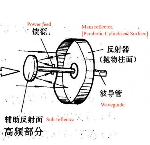

Phase mono-pulse antenna system for tracking targets in azimuth and elevation (two planes). Each antenna has its own transmitter. In operation one antenna works in transmit mode, three others in receive mode. The target signal received ís fed to "phase detectors", where formation of azimuth and elevation correction signals take place. If the phase sum is zero, the target is straight ahead. If the target is above/below or left/right, correction signals created in the "phase detectors" are used to control the missile flight direction.
This antenna is quite unusual—it uses a cylindrical surface [which may have some curvature, though it's imperceptible] for reflection as a Cassegrain antenna, rather than the more conventional and much more obvious paraboloid. In addition, I suspect that this antenna is unidirectional, and that it cannot achieve an ideal radar beam by loading a transmitted beam onto the feed; instead, it can only attain reasonably good gain when receiving reflected beams.
