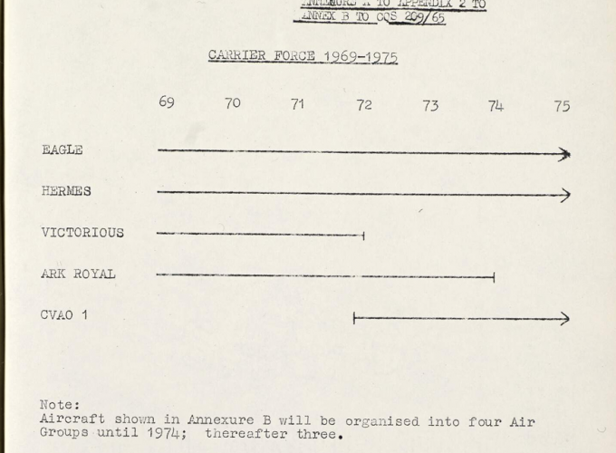

The Phantom/Buccaneer combination was probably as good as any of these unbuilt designs. Ark or Eagle take you to 1978.
CVA01 if it had been built in the late 60s might have joined in 1974 or so.
F18s would probably have been bought at around the same time the USN replaced its Phantoms on Midway and Coral Sea.
Sorry no paper planes.
CVA01 might have been a nightmare to operate in real life. But I think it would have survived Nott in 1981. NATO would have argued strongly for her retention.
Whether CVA02 would have followed in the 70s is hard to say. With NATO backing and no East of Suez baggage as in our timeline she might have done.
Seakings, a couple of Hawkeyes and maybe even a Greyhound would have been part of the air group.
The quid pro would have been disposal of the 8 Countys and Blake and Tiger in the 70s as the T42s arrive. Probably the SSN programme would also have been more drawn out and the earlier boats phased out sooner.
