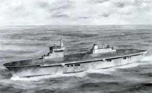

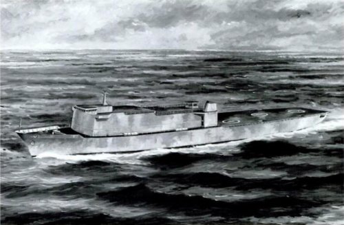

About 1980, there was a considerable number of design studies into ships that combined the role of replenishment and helicopter carrier in different proportions to create a "cheap" carrier. The simplest variants had a box hanger forward and a big deck with three landing spots aft. This arrangement is only suitable for an aircraft complement of up to six, above which movement in the hanger becomes difficult. A similar conclusions were reached in early studies leading to the Invincible-class.
If more numerous aircraft are needed a conventional through-deck carrier configuration with an island superstructure and flight deck with about five spots and below deck hanger is required. Two elevators are essential since one may be disabled by accident or damage. This configuration would make an alternative deck for V/STOL aircraft to land, refuel, and some limited re-arming. It could not have full maintenance facilities without escalating to the size and cost of a small aircraft carrier (CVS).
There was prolonged discussion about whether these ships should be Royal Navy (RN) or Royal Fleet Auxiliary (RFA) manned. If RFA manned, larger and more attractive living quarters would be required and the RFA insisted that the ships be powered by commercial diesels. If RN manned, the RN was equally insistent that they be powered by gas turbines. Originally the RN manning would have had a ship CO of Commander rank, but when it was decided that the air group needed a Captain the ship CO became a Captain rank.
One major problem applied to both configurations is that flight deck operations made it impossible to have any replenishment rigs on the port side and probably no more than two to starboard. In the "carrier" configuration, the hanger deck must be high enough to prevent flooding after damage--increasing the size and cost of the ship.
Artist's impression of replenishment ship helicopter carrier with a hanger forward and "through deck" carrier configuration.

The Fort Victoria RFA have the capability to carry and support up to five Sea Kings/Merlins and so could act as a reasonable flag ship for an escort group. So to a certain degree have achieved the aim of merging an Replenishment ship and a helo carrier.
It is unfortunate that; as with all UK programs, the number of ships built was substantially reduced. IIRC the orginal plan was to build six Fort Victoria to the full design spec; armed with Seawolf system, and a further six of a reduced version (I have always assumed the the latter six were to replace the Rover class tankers).
All good points JohnR. The goal of the combined replenishment ship and helicopter carrier studies made in 1980 was to create a ship cheaper than a small aircraft carrier (CVS) and create a "cheap" carrier. I guess that the points that Brown and Moore were trying to make is that the combined ship would not be cheap and not be without its operational problems. You get the impression that a combined ship would be a poor replenishment ship and a poor helicopter carrier offering little in cost savings. They write "the conclusion had to be that the two roles were not compatible."
If this was indeed the conclusion of the design studies, then why was the decision made to proceed with the Fort Victoria-class replenishment ship with six ships in the original plan? Unfortunately, Brown and Moore do not explain why the decision was made to create the "one stop ship." They write that there were an exceptionally large number of constraints, many of which were not obvious. That eventually the ship was completed in accord with the Ship Department sketch design, years late and much over budget.
