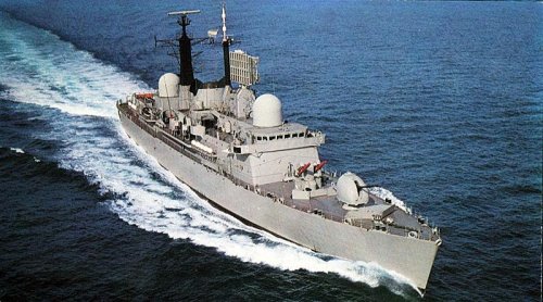

My understanding was that Bristol's fit would have been right at the stern with two launchers on either beam pointing forwards and outwards. On the Invincibles the original flight deck configuration (as launched) should have allowed for 4 Exocet launchers, at least that is my understanding. The Argentinians had 4 Exocets installed on their Type 42s mounted amidships and again pointing forwards and outwards.

gral_rj said:
I seem to recall the Argentinians fit MM38 launchers on their Type 42s. Granted, I don't know what they sacrificed to get them.
See my post above, in the below picture you can just see the box launchers amidships pointing directly at the camera.

I am still not sure about the Type 42s weighwise, the Argentinian fit is not necessarily a good one.
The answer to that question is quite probably "Metacentric height".
TomS
Apr 16, 2008
4,927
2,467
Also boats, I think, judging by early pictures of the Argentine vessels. The RN Type 42s had a couple of rigid whaleboats/launches until after the war, when they traded them in for rigid inflatables to free up topweight for CIWS. I think the Argentine vessels had at least one RIB replacing a hard-sided boat from the outset.
