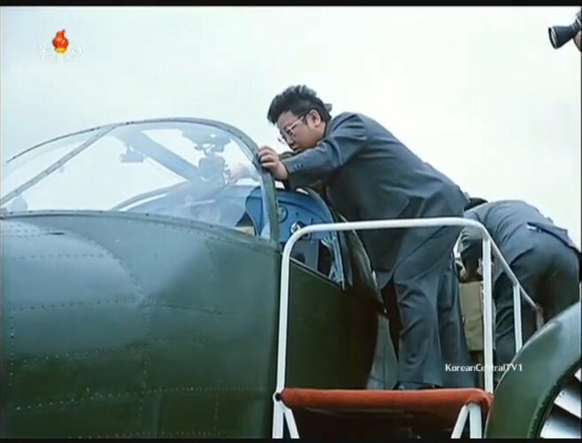

Found this North Korean - Chosun Film posted called Virgin Assault Squadron (Google Translate); it features a woman's combat unit flying the Yakovlev Yak-18 or some Nanchang CJ-5 variant?
There's also a few MiG 15s included and what looks like some fake models used to represent USAF planes attacked at the end.
Interesting to note the use of a Polish PZL-104 Wilga at the 1:00:28 mark, which if the story line is within the Korean War would in fact be ten years prior to the plane's first flight!
Unknown what year this propaganda film was made and its only in Korean with no English sub-titles

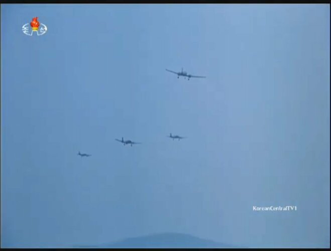

North Korea has drone program, one possibly turboprop driven and two seemingly jet powered.

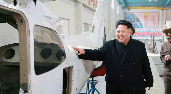

Nothing new. This just sums up what we know about a possible North Korean production of Fulcrum.
"Domestically produced twin-engine aircraft...At least four Yak-6-based aircraft built by North Korea in the 1980s and 1990s, powered by CJ-6 AI-14 engines and equipped with radar and sighting equipment. Origin, use, and whereabouts are unknown, but they are said to have been training aircraft for transport and bomber crews. It is flyable."

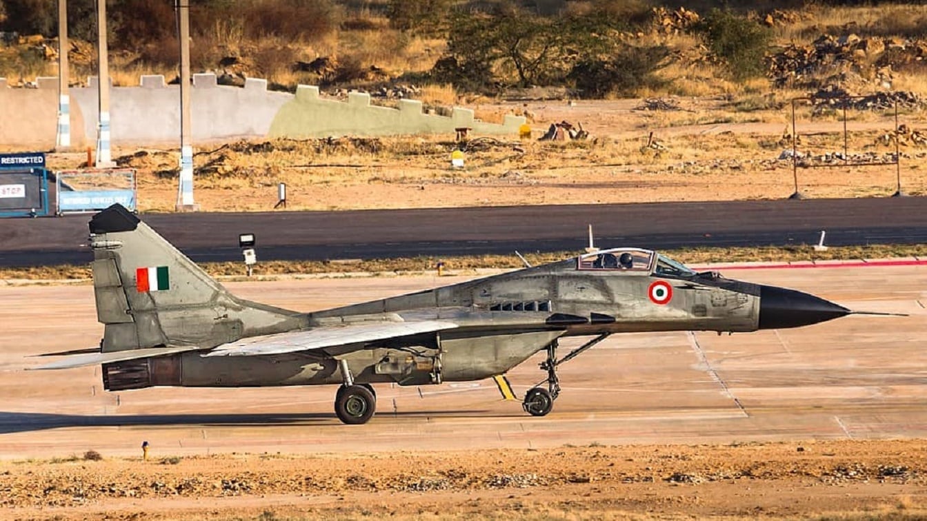

Is North Korea’s MiG-29 Fleet Growing ?​
License production contracts with Russia and technical assistance deals may be strengthening North Korea’s air force.
North Korea’s armed forces learned during the Korean War the potentially devastating consequences of losing air superiority in a conflict with the United States, and air defense has ever since been a key priority in the country’s military doctrine. The Soviet Union emerged as a key supplier of arms for this purpose, expanding the small Korean War-era fighter fleet throughout the 1950s and granting generous military aid alongside reconstruction assistance. North Korea was the only foreign client for the Soviet S-25 surface-to-air missile system, a high-end platform tasked with the defense of Moscow itself, and Pyongyang would continue to upgrade its air defense network and fighter fleet throughout the Cold War.
With the collapse of the USSR in 1991, it was widely believed that North Korea would be unable to acquire modern military hardware for high end aerial warfare, or even parts to maintain and modernize existing systems, giving the United States and its allies an overwhelming advantage in the case of a future war on the Korean Peninsula. However, an analysis of the developments in the North Korean defense sector since the late 1980s and the potential for continued Russian assistance to its East Asian neighbor, help explain why the country’s ability to wage a war in the skies has remained strong despite all expectations.
In the wake of North Korean leader Kim Il Sung’s visit to the Soviet Union in October 1986, Moscow agreed to supply the country with its first MiG-29 Fulcrum fighter jets — an elite combat platform that had entered service in the Soviet Air Force only the previous year. With the heavier Su-27 Flanker struggling in its early days and being produced in very limited numbers, the MiG-29 was the most capable fully operational fighter in the USSR at the time. Pyongyang had gone to great lengths to strengthen its defense partnership with the neighboring superpower since 1984. Alongside a boom in trade and considerable Soviet investments in high-end industries in the aftermath of the leader’s visit, the USSR also helped to modernize North Korean aerial warfare capabilities. This included the provision of MiG-23 fighters, Su-25 attack jets, a Tin Shield early warning radar system, and S-200 air defense batteries, among other advanced armaments.
While North Korea is thought to have received approximately two dozen MiG-29 jets from the USSR, the country’s Air Force would go on to enlarge its fleet considerably by acquiring a permit and technological assistance from the Soviet Union to manufacture the elite fourth generation jets under license. The permit was given in 1987, and North Korea opened a small production line and manufactured two to three fighters per year. The Fulcrums were manufactured in Kwagsan and Taechun in North Pyongan province in the country’s northwest. By the end of the 1990s 15 fighters had reportedly been manufactured — a modest number compared to the Soviet production lines, which produced dozens of aircraft per year, but nevertheless a considerable addition to the North Korean fleet.
The first of the North Korean-built MiG-29 jets flew on April 15, 1993, and the performance was comparable to those built by the Soviet Union and Russia themselves — more sophisticated than the export variants marketed to clients such as Iraq and Iran. Nevertheless, a number of key components were required from Russia to maintain production. In 1997, North Korea signed a contract with Russian state-run arms dealer Rosvooruzhenye for military cooperation, which included continuing assistance for the manufacture of MiG-29 jets in North Korea. While the country’s Fulcrum fleet is estimated to have numbered around 35 jets at the time, extending indigenous production would see it grow considerably larger.

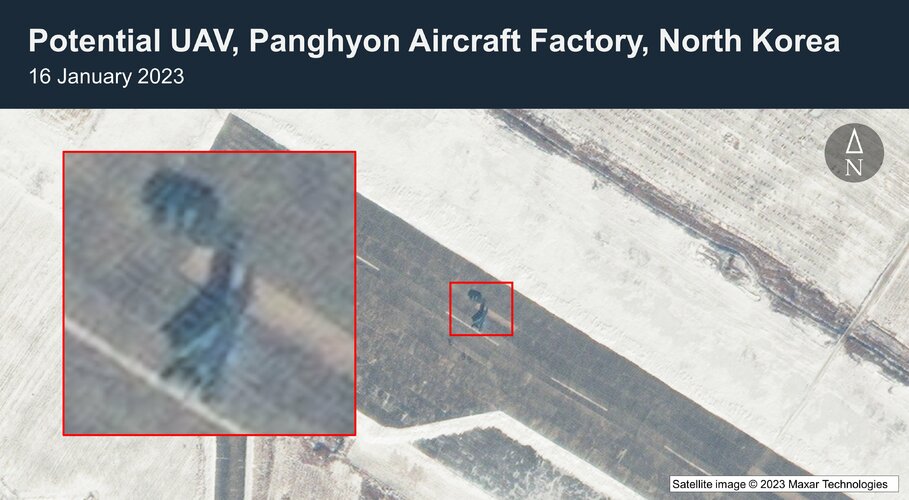

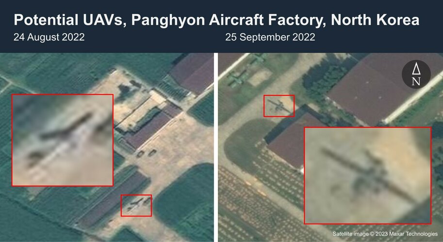

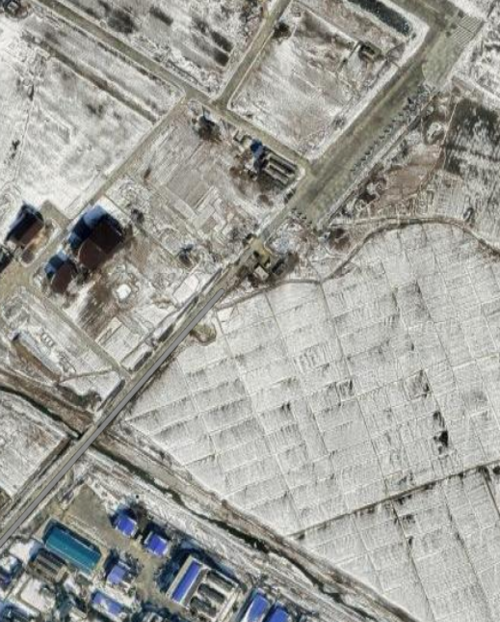

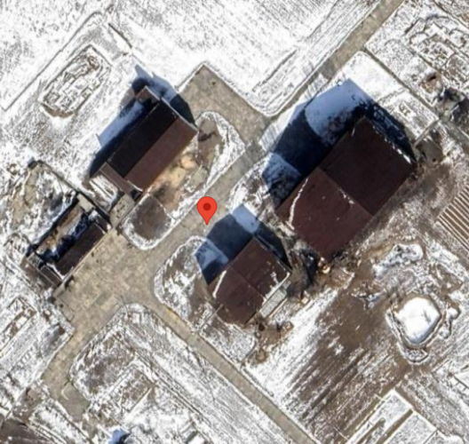

Panghyon Air Base and attached Panghyon Aircraft Factory are the center (or rather, entirety) of the North Korean aircraft industry. At this time the facilities there support the maintenance and overhaul of aircraft rather than production or development - and this has probably always been the case. The facilities, roads, runway, etc. are in a poor state of repair and could not reasonably support the production of complete aircraft. There is not even a way to move a completed aircraft such as a MIG-29 from the "factory" to the air base runway.
Production of an aircraft does not require having it all in one place, not even close at all as evident by Eurofighter Typhoon in EU.
Both at Panghyon airbase and Panghyon aircraft factory there were new drones as evident by satellite imagery.
Satellite imagery acquired and posted by International Institute for Strategic Studies.​
The analysis you are referencing is here: https://www.iiss.org/online-analysi...rth-korean-uavs-small-intruders-big-ambitions
The Panghyon Aircraft Factory is located at approximately 39.878662, 125.256326.
The Panghyon Airport / Air Base is at 39.925501, 125.205177, approximately 6 km from the factory.
The point I was making in my previous post is that the air base has very limited facilities. There are only a few hangars and other infrastructure. There are plenty of MiG-17/19 aircraft parked and in various stages of disassembly - probably being cannibalized for parts.
The factory is in much better shape, but is 6 km away and the roads between the factory and the air base would not allow a fighter-sized aircraft to be moved completely from the factory to the air base. Moving it in components to be assembled at the air base would also be unlikely due to the lack of facilities. Building a fighter (or MALE UAV) at the factory and transporting it to the air base does not seem possible. The factory is more geared towards the production and refurbishment of replacement parts.
The images you have included in your post, sourced from that analysis, are of an area at the air base, not the factory. The author of the analysis does not seem to make a distinction between the two.

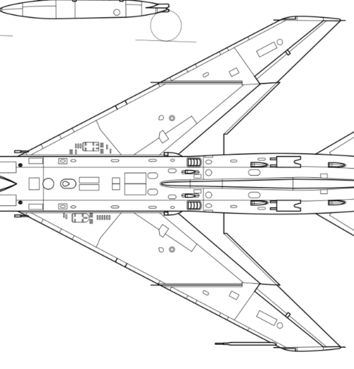

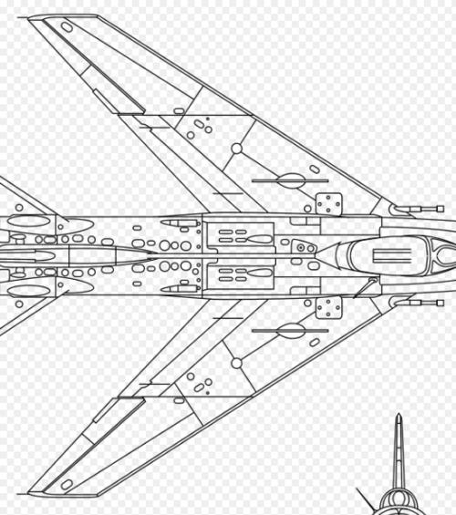

The first "unseen UAV" mentioned in that analysis as a swept wing "fast-target drone or reconnaissance UAV" is visible in satellite images taken during March, April, and May of 2022. The object is positioned in front of a blast deflector. In several images the object is more clear than the image you have referenced, and in some there is a second aircraft. Using images that have the correct metadata and have been orthorectified, it is possible to approximate the dimensions of the objects. They are 55-60 feet long with a wingspan of approximately 30 feet. The wing sweep is about 60 degrees.
These are almost certainly Su-7 fighters. One of the aircraft is being cannibalized to repair the other. Between this and confusing the air base with the factory, I have concerns about the analysis in the article.
Strangely, many of the analyses out there concerning "rogue state" UAVs ignore a very important component: the uplink. Any UAV that operates at long range or long endurance needs more than a line of sight data link (and even those are problematic in the terrain of NK).
If North Korea is developing a MALE UAV, how are they communicating with it? Using relay aircraft? Using a satellite? If a satellite, who does it belong to? If they are using a commercial satellite or a Chinese satellite, their UAVs can be shut down by outside parties easily. That does not sound very Juche.
Satellite imagery acquired and posted by International Institute for Strategic Studies.[/CENTER]
And as a side note, the images you included are copyrighted by Maxar, not IISS. IISS does not operate the satellites or own the original images. While the same images may be available in Google Earth, if they were provided to IISS by Maxar under license they are probably not available to use by anyone but IISS. Satellite image providers very rarely allow wide distribution of their images and when they do the licenses are very, very expensive.
That is not Su-7 as he asserts.
Su-7 is not used by North Korea for decades.
He mentions higher quality images and date.
Yet provides none to prove own assertion.
If it was Su-7 then wings would be larger.
Along we could have seen large tail fins.
It has different airframe length to width ratio.
Maxar is credited in image itself prominently.
I stated IISS acquired and posted it publicly.
Not that IISS took satellite image of NK there.
Which he asserted against me.

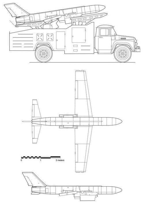

Just a translation of the above article :

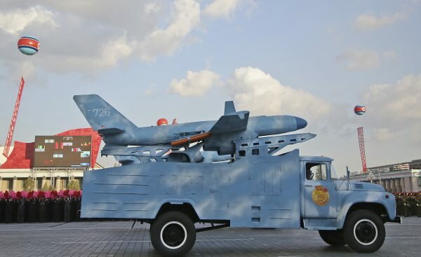

North Korean MM-1 drone
North Korea has been operating and building unmanned aerial vehicles (UAVs) since the late 1980s, mostly small propeller-propelled reconnaissance platforms and a few DR-3 Reys systems that appear to have been acquired from Syria. It appears to have been in the mid-2000s that North Korea began developing a new reconnaissance/strike UAV.
Commonly referred to as the MM-1, it was first recognized in February 2012 when South Korean media reported that North Korea had purchased several MQM-107D Streaker air-targeting aircraft from the Middle East and was developing a drone based on the platform. Syria was initially suggested as the source, but Egypt and Iran, which operated early models of the MQM-107, were more likely.
Less than two months later, on April 15, 2012, North Korea unveiled its first drone at a ceremony in Pyongyang.
A detailed review of ground observation photos and satellite imagery reveals that the MM-1 bears some similarities to the MQM-107, but it is not a complete copy of the system.
The MM-1 is a different size than the MQM-107, with a larger wingspan, a straight wing shape rather than a retractable wing, a different vertical stabilizer position, gimbal sensor mountings extending under the fuselage and in front of the engine intake, and a different engine geometry. In addition, the wing section has four small winglets above the wingtips and one winglet below the wingtips.
There is currently no reliable data on its performance characteristics or power, including downlinks for real-time communications, onboard sensors, and weapons.
The MM-1, which was unveiled at a feverish ceremony in 2012, was set up for reconnaissance, but on March 20, 2013, North Korea's Korean Central News Agency reported that, under Kim Jong-un's leadership, the country had tested three precision strike unmanned aerial vehicles.
The live-fire drills took place at the Taesandong training center southeast of Pyongyang, and video footage released showed that the aircraft used in the drills were the same as those unveiled at the 2012 festival. While there is nothing to prove it at this point, it would not be a stretch to assume that North Korea has modified the MM-1 for electronic warfare or electronic espionage.
Two types of rail-type launchers have been seen so far. One is a vehicle launcher, which is a modification of the Zil-130 light truck undercarriage that was featured in the thermals, and the other is a four-wheeled towed launcher, which appears to be a modification of the top of a heavy anti-aircraft gun. Regardless of which launcher is used, the MM-1 is equipped with two launcher auxiliary rockets to aid in the launch cycle, one under the tail of the main wing and one on each side.
The MM-1 drone has been featured frequently in North Korean military parades since 2012. Observations suggest that the MM-1 may have a nose radome, but no other visible antennas.
In addition, there were no noticeable changes to the system's geometry over the years.
The fact that the Zil-130 vehicle launcher is operated by the North Korean People's Army suggests that the MM-1 is an Army system, not an Air Force system.
It is now known that North Korea is capable of maintaining jet engines for its fleet of aircraft and is capable of producing engines for the MiG-19 fighter jet. However, it is unclear whether North Korea is capable of designing and producing a small jet engine like the one used in the MM-1. Therefore, it is likely that the engine used in the MM-1 was acquired from abroad. China appears to be a likely source, but there is no evidence to support this claim.

He says impossible to move jets from factory.
When NK had many jet UAVs on Zil-130 trucks.
Along having cranes to lift fighter jets.
Thus those can be placed on towed trailer.
NK has mobile truck based cranes.
That have lifted solid fuel SLBMs.
Larger than 4650kg heavy 9K720 Iskander.

The MiG-19 is 41 feet long. The object in question is 55-60 feet long. There are MiG-19s or MiG-17s in the same images parked near the runway, which was mentioned previously. Those are smaller, and very obviously MiG-19s or -17s. The wing sweep on the object does not match the MiG-19 either, as mentioned previously.
Of course, if it is a Su-7 OR a MiG-19, it is still not a UAV as the analysis argues.

First, those images are of the air base, not the factory. The factory is 6km away.
The roads in the images you posted illustrate my point. They are clearly in disrepair, have sharp turns, etc. You are not moving brand new, fragile fighter sized aircraft over them without breaking something.
The roads from the factory to the air base are also in disrepair, have sharp turns, etc. and portions of the road do not have enough clearance to move an assembled fighter sized aircraft. The facilities at the air base are spartan enough that doing "final assembly" there would be impractical and would impact other activities. They need a few more hangars. They have, like, 3.
Su-7 are there in 2023 as they were for decades compared to Mig-19 at the airbase/airport.

Found it, I hope you're not confusing shadows of pedestrians on road with pot holes on road not far off from the aircraft factory.
Also Soviet aircraft were designed to work in not so ideal environment/condition of roads and runways unlike western aircraft.
Also since you're American from what I can guess at your profile picture, you're probably thinking of American and not European trucks.
Location of both "Su-7" and MALE UAV 39.918117,125.212680

2013:
UAV powered by jet engine.

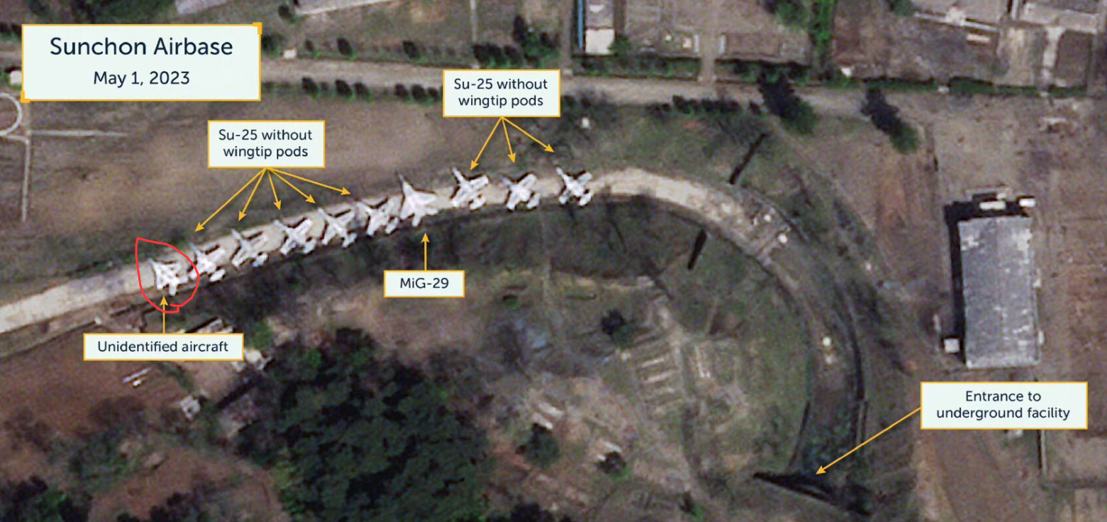

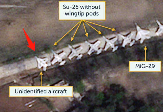

While this could be a mock-up/decoy of some sort, there is the tantalizing possibility this COULD be DPRKs long awaited indigenous combat aircaft. They wouldn't have developed those AAMs we saw previously in a vacuum.
IF so, it is quite small, about JF-17/MiG-21 size, not unexpected as they need something modern but cheap and in numbers to rejuvenate their air force.

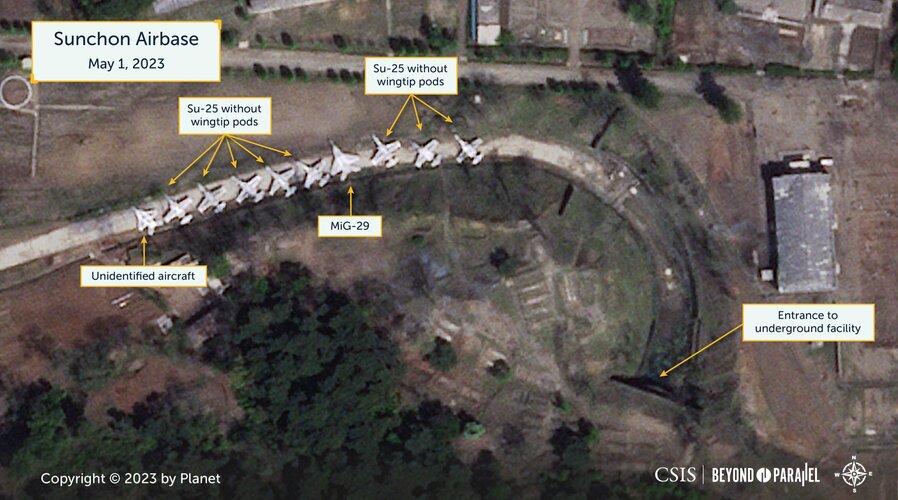

This was posted by Sahureka2 at defence.pk
It is strange, because why this aircraft would be parked with Su-25 without wingtips. The Frogfoot seem to be used as a spare parts reserve.
Maybe it's a partially dismantled Fulcrum.
Or maybe an unsuccessful prototype that was abandoned there.
In any case, this is really interesting and I'm looking forward to seeing more !
what do you think,
1) Faux Wood/Plywood Plane
2) a new drone
3) a new advanced trainer aircraft
4) a new single-engine light combat aircraft
PS
it has much smaller dimensions than the Mig-29 that is present in the image
Probably much heavier than MiG-21 if actual aircraft since wide enough for 2 engines.
PsyOps mockup made to mess with the heads of Western intelligence agencies
Edit: that's my guess, not saying that's definitively what it is, though given what we know of NK's aircraft industry, it seems the most likely option
