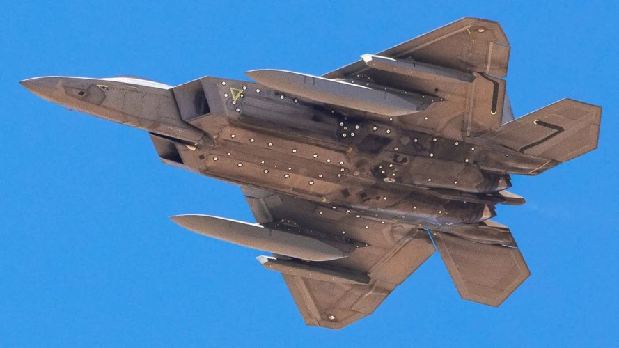

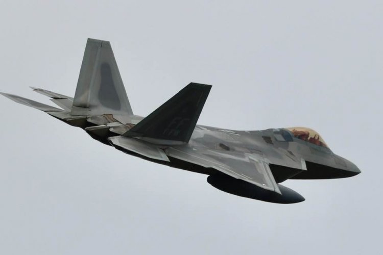

It's hard to say for sure because of lighting and limited perspectives, but it looks as if this version has much darker RAM coating, more akin to what's on the F-35?

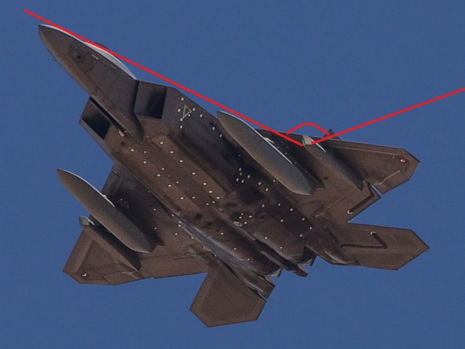

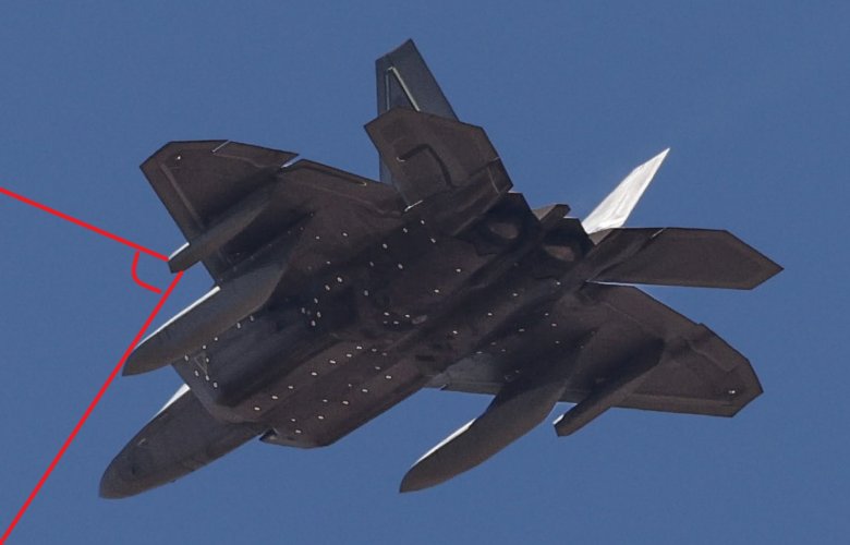

It's to be assumed that it's some form of probe to collect data, I'd say. Possibly how airflow from the pylons and the external payload impact the control surfaces in the rear. But my guess is just based on placement and it being a test article for novel external accessoires. So I'm not claiming absolute certainty here.I’m surprised no one has commented on the things on the tail and elevators, only on one side of the aircraft.
I find it hard to be believe that they'd set things up that way.1 of the stealthy sensor pod looks EO & other like EW.

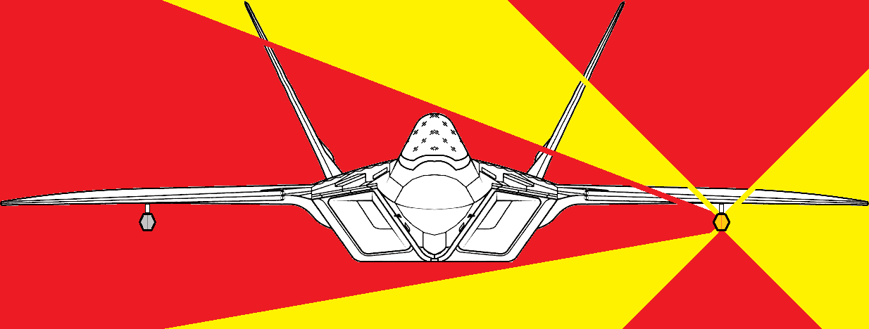

So the fuselage acts as a blindspot, can't look the other side.
Then how will F-22 have spherical coverage?

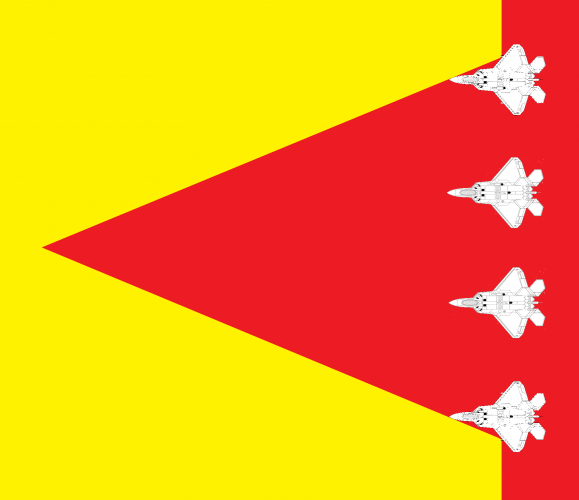

Will 1 group of few data-linked F-22s do the IRST for other clean config F-22s?

I would hope the IRST is mounted on different sides of different aircraft, and that part of the EW pods role was to datalink the aiRST data to all aircraft in the flight.

IRSTs both sides has been the understanding since we started seeing two pods on the Raptors.
But both the EO seekers & RF emitters are needed to cover all angles, bcoz F-22 after using all BVRAAMs would also try to sneak from side, behind, high & low altitudes & now the adversaries would also use such tactics.Another possibility is that the two pods are IRSTs forwards and EW aft.

The pods are always used in pairs and each is for a specific side of the aircraft. They are both EO pods with other capabilities. They work as a pair for EO.
It's my impression that the IR windows are only on the outboard sides of the pods, so you're seeing the face of the pod without the window.In some images it appeared like one of the pods was opaque - you are confident both have EO/IR apertures?

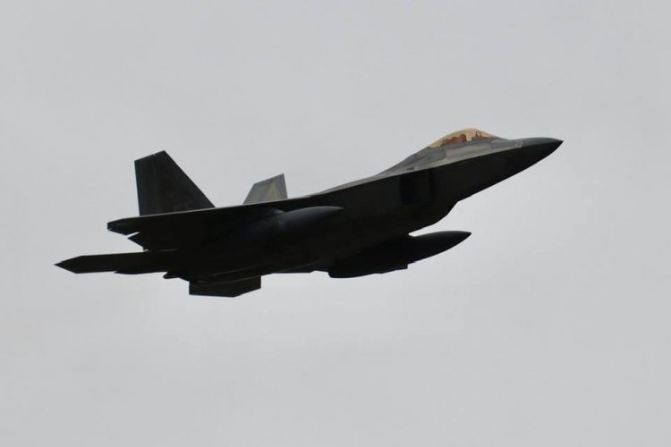

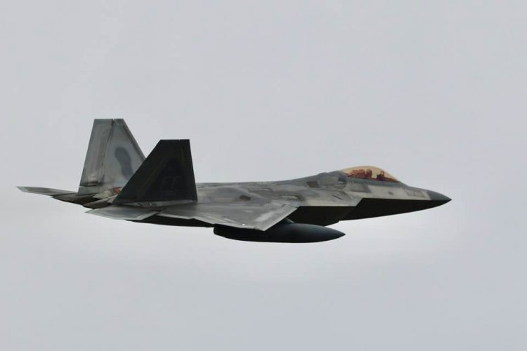

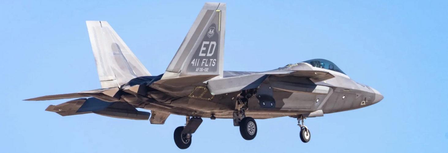

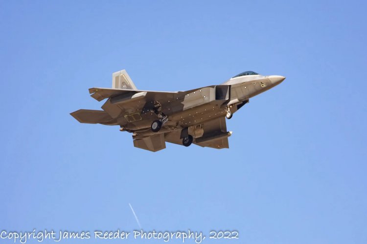

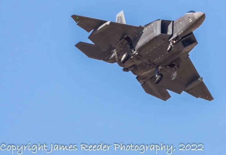

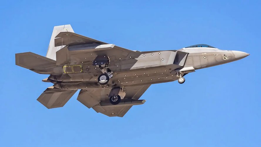

Note that you are seeing the left side of the first pod, and the right side of the second pod.Yeah it is hard to believe bcoz the pod heads clearly look different.
There are some other pics also i guess people already know.
We already know that the pods are not symmetrical. So as far as we can tell, both of those pictures show a port wing pod.

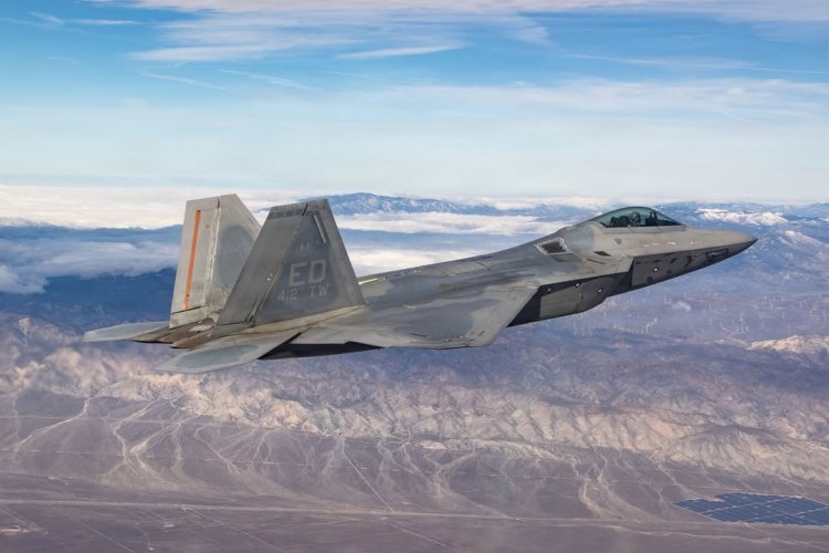

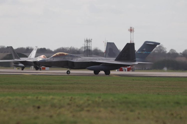

2nd sexiest aircraft on planet earth. easy.Laughingly or not here in the Uk at RAF Lakenheath we have a squadron of Langley based F-22 Raptors for a month since Epic Fury kicked off. But they did not go to the sandpit as expected, instead they went up flew some training sorties over the North Sea so here are my photos over the last few weeks.
View attachment 808516View attachment 808515View attachment 808517View attachment 808518
They have decided to fly back home instead of going to the sandpit so all have gone bar 2/3 .
cheers

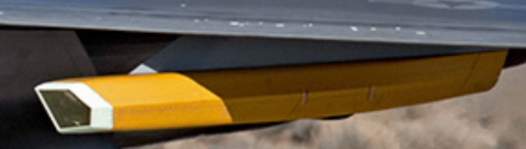

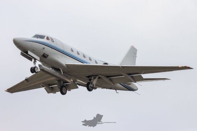

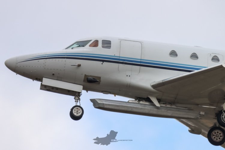

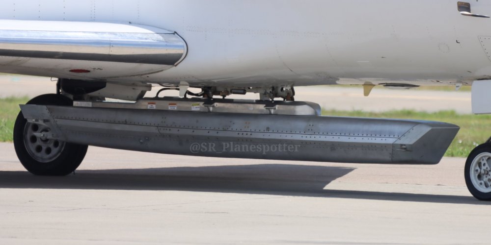

While I admit that the pod shown under the bizjet has a notch in the nose and does generally look like the pods seen on F-22s, no pictures of that notched-nose pod on an F-22 have emerged yet.All these kind of pics come out by either photographer's account or websites/Vlog like TWZ, Sandboxx, etc.
You are considering only the pod closeup pics, that way the FoV of left pod would reduce, it won't be able to look past its own boresight towards radome & FoV would be like just 90 degrees (front outward quadrant).
Like i said there are many other pics from different angles which people might be knowing & it doesn't look that pods are asymmetrical, but the 2 pods are indeed different, left is EO, right is non-EO, which is mentioned in Sandboxx video in 18th minute & TWZ site in 2022.
"With that in mind, the possibility that these pods represent just such a configuration, with an electronic warfare capability on one side and an IRST on the other, looks more likely than not. The pod on the F-22’s left wing does look like it has a different faceted nose area than the other, almost as if it is meant to be a transparent window, while the other is opaque."
It looks like the EW pod might have an air cooling intake at tip & vent at rear tip.
