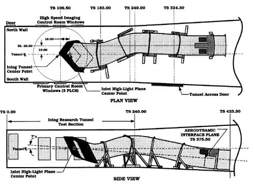

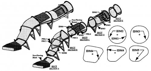

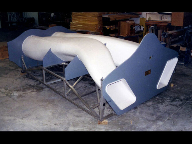

This is how it looks like

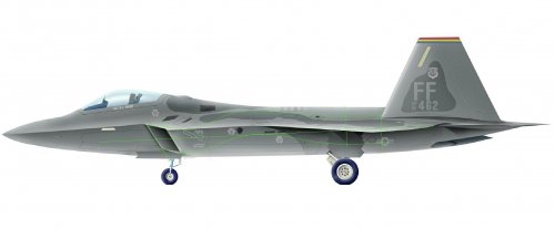

As applied to the Raptor 2-view...

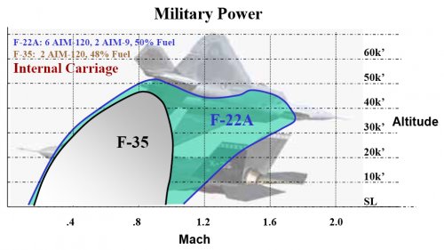

F-22 flight envelope sans AB.
I am pretty convinced, this diagram is not accurate for neither aircraft. I have read in many placed of the F-22 being the fastest aircraft at sea level, capable of Mach 1,25. The diagram shows it barely doing Mach 1,1. Even the F-15E can do better.
As for the F-35.... Once they start testing of the lighter versions with the more powerful engines, I think we will up for a surprise.
Well, you always have certain, uhh, odd ones here and there who make claims about the F-22 being a Mach 3+ aircraft.
And strangely enough, their claims are always uncited. Hmmmmmm.....
I'm sure that the F-22 is faster than shown, when in afterburner. I'm somewhat surprised that it is that fast without afterburner, even though at something like "combat weight", which is with roughly 50% fuel expended or mid-mission...
As for the F-35 getting lighter, I'm not at all sure about that.
Please note that the flight envelope says "military power" this means maximum engine thrust without reheat, ie no afterburner. Both aircraft (F-22 and F-35) would have much larger and faster envelopes with the greater thrust available by using reheat.
