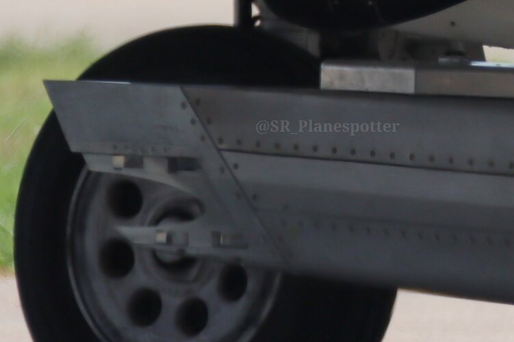

The data probe/pitot/Electrode (?) like thing with soot all along its its forward facing part is interesting.

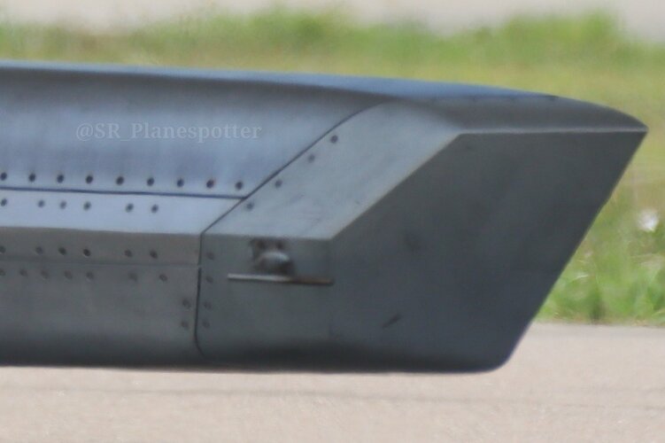

The airfoil shaped cut at the stern is also intriguing. Could that pod be leading edge mounted also?
iu

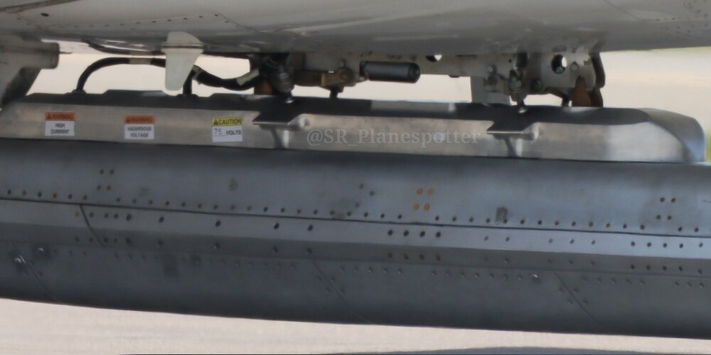

That material does not look very IR transparent. Is there a post that explicitly describes it as an IRST?
It is an unusual aperture. In photos of the pods mounted on CTF F-22s the aperture is more obvious, but only from certain angles.
The pod mounted to N33TR is a boilerplate/breadboard pod. The configuration seen in thee photos is not representative of an operational configuration.

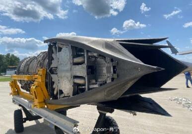

You know that is a photo of the YF119 engine and nozzle for the YF-22? It was designed with the architecture to accommodate the original thrust reverser requirement of the ATF program. The two circular panels on each side were the pivot points of the convergent nozzle segments that could pivot to bring the aft edges all the way to together to shut off the exhaust flow and divert it to reverse doors on the top and bottom of the nozzle structure. The actual reverser hardware was not included in the YF119 flight test engines when the requirement was deleted.
The production F119 nozzle is a masterpiece of multifunctional engineering with fault tolerant control, optimized divergent flow area, +/- 20 degree vectoring with high slew rates, multi-spectrum low observability, and full overhaul part durability. But is is significantly different than the YF119 design.
Is there info as to how much would F119 weigh with a regular nozzle instead?
Fixed that for you.
As to its' weight I don't know but it's probably lighter than the YF119 as the thrust-reverser hardware isn't present.
